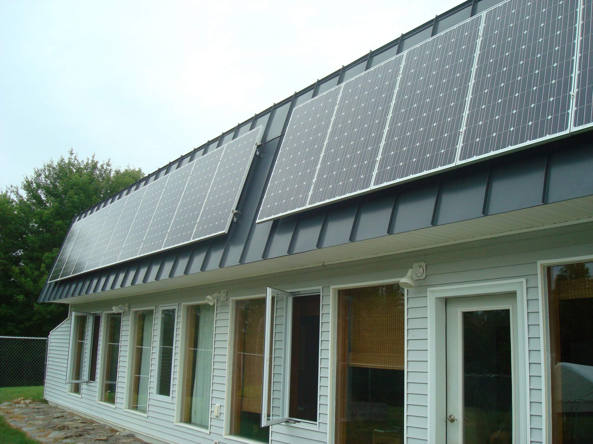

I have been thinking about using some solar electric for a couple of years. The time seemed right this summer.
The system is rated at 4.3 KW annually using the NREL PVWATTS calculator. The panels are made by Canadian Solar and the inverter is a Solectria Renewables PVI 4000 model.
The installation was completed yesterday afternoon and the electric utility is supposed to swap-out our not-so-smart meter for one that does net metering on Monday. I am looking forward to getting some generating history built up. So far, it says it has generated 7 KW, 2 KW yesterday afternoon and 5 KW today which was heavy overcast all day long.
The system was purchased from and installed by Revision Energy based in Portland and Liberty, Maine. A really great A-1 crew from start to finish.

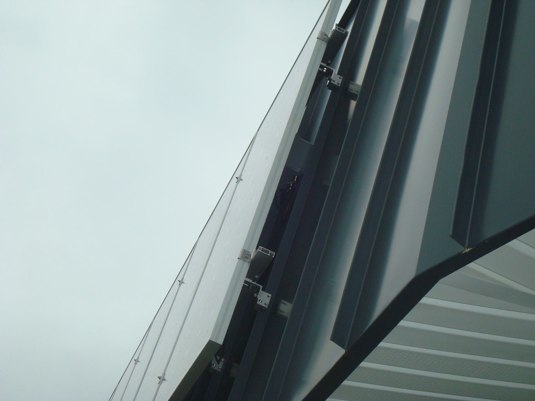

The close-up pic of the panel mounting shows the clamp-on brackets used on standing seam metal roofs.

The upfront cost is $19,774. That includes all parts and labor. Also includes purchase and complete install of a 58 gal. Rheem/Marathon electric water heater, and removing our old indirect boiler-heated tank. So, there was wiring and plumbing to mess with for that part of it.
The system qualifies for Maine's energy efficiency rebate maximum of $2000 and a 30% federal tax credit (which can be carried-over if you cannot use all of it in one tax year) that is worth $5,932. My net cost for everything is $11,842. I can probably sell the old water heater tank for $500-$600. It's a 60 gal SuperStor in great shape, 5 years old.
I estimate the payback period at around 17-18 years but won't really know until I have some actual history. Our electric rates here are $0.15 per KW and the old water heater accounted for at least 260 gal. of propane per year by my best guesstimate. We used right around 315 gal of propane a year for our range cooktop (elec. oven) and domestic hot water for two people.
Propane is pretty cheap now with the gas glut, but I expect it will climb depending on how many LNG gas compression plants get built.
The 72 degree mounting angle on the panels does hurt the output, but to buy or have fabricated special mounts to help the angle is more expensive than adding a few panels to the system. They were concerned too that if the panels stood off the roof too far, they could catch too much wind behind them for the roof to withstand.
I checked with the roofer that did our roofs, he thought with the weight distributed across there (the 18 panels are 45 lb each) it shouldn't be a problem. The roof is 24 GA. They put a clamp on every standing seam rather than every third as would be normal for a flatter install. The installers were standing on the rails like on ladder rungs and nothing seemed to be giving at all.
We looked at ground A-frame rack and pole mounts but decided in the end to go with the roof. Couldn't find a location I really liked on the ground, ironically the best spot would have had our power lines throwing a shadow on them which would have led to burying our service line for about 400 feet. We have to think about snow build-up here too. I don't think snow will stick on the panels at that angle very long once the sun hits them. It doesn't stick to that roof surface now.
