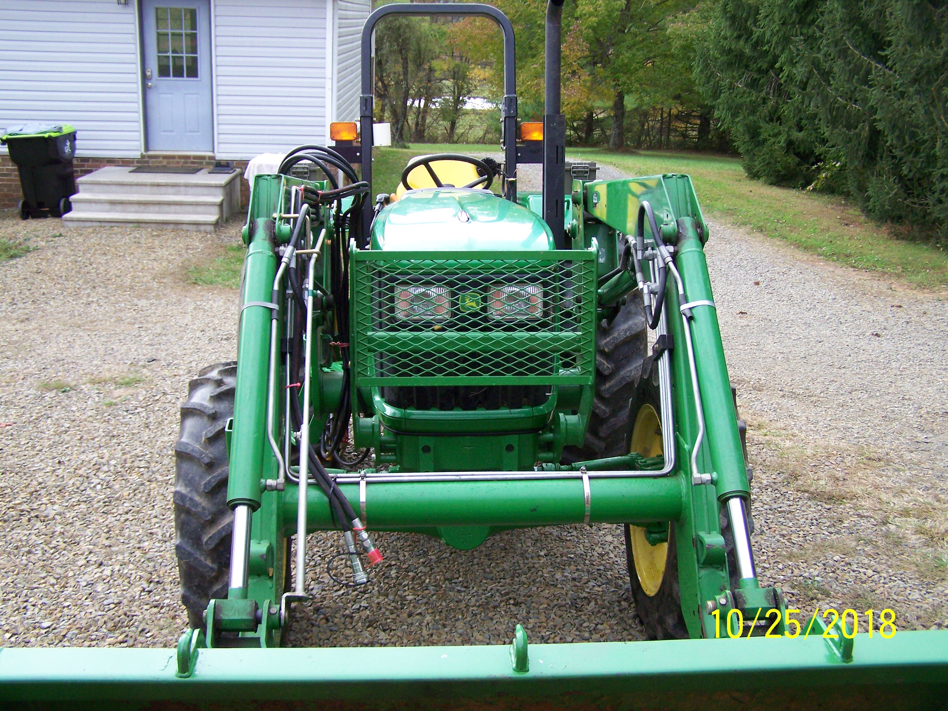

Here is the factory (optional) grill guard on my JD. It wasn't great, but it did cover most of the grill.
It's actually sold in two parts!
Without the screen it's pretty worthless.

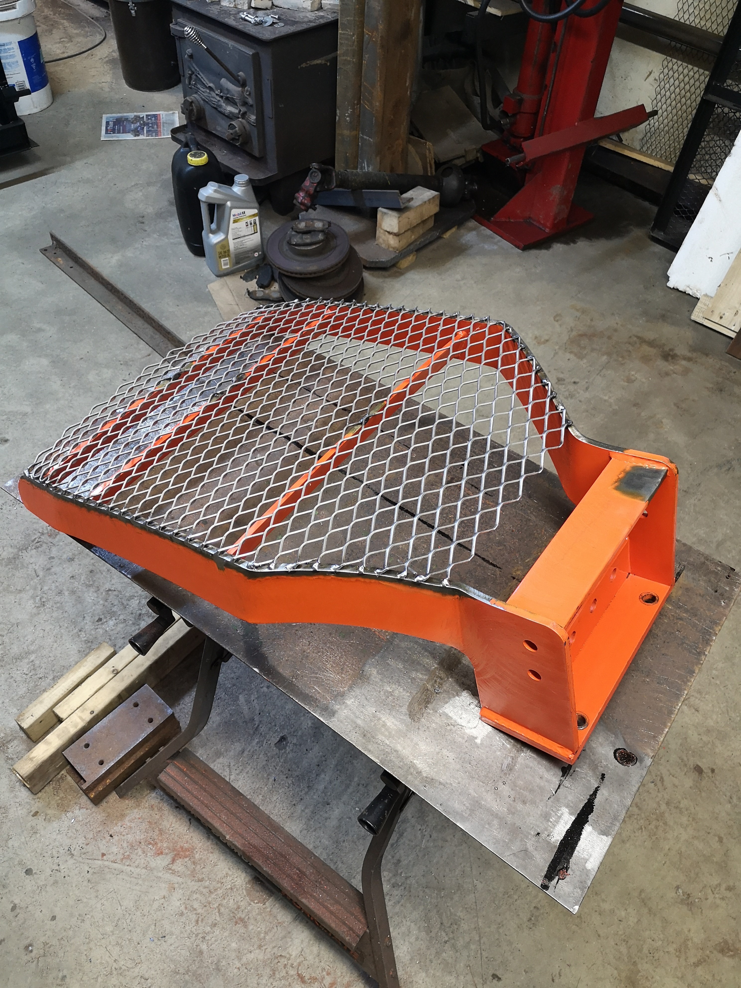

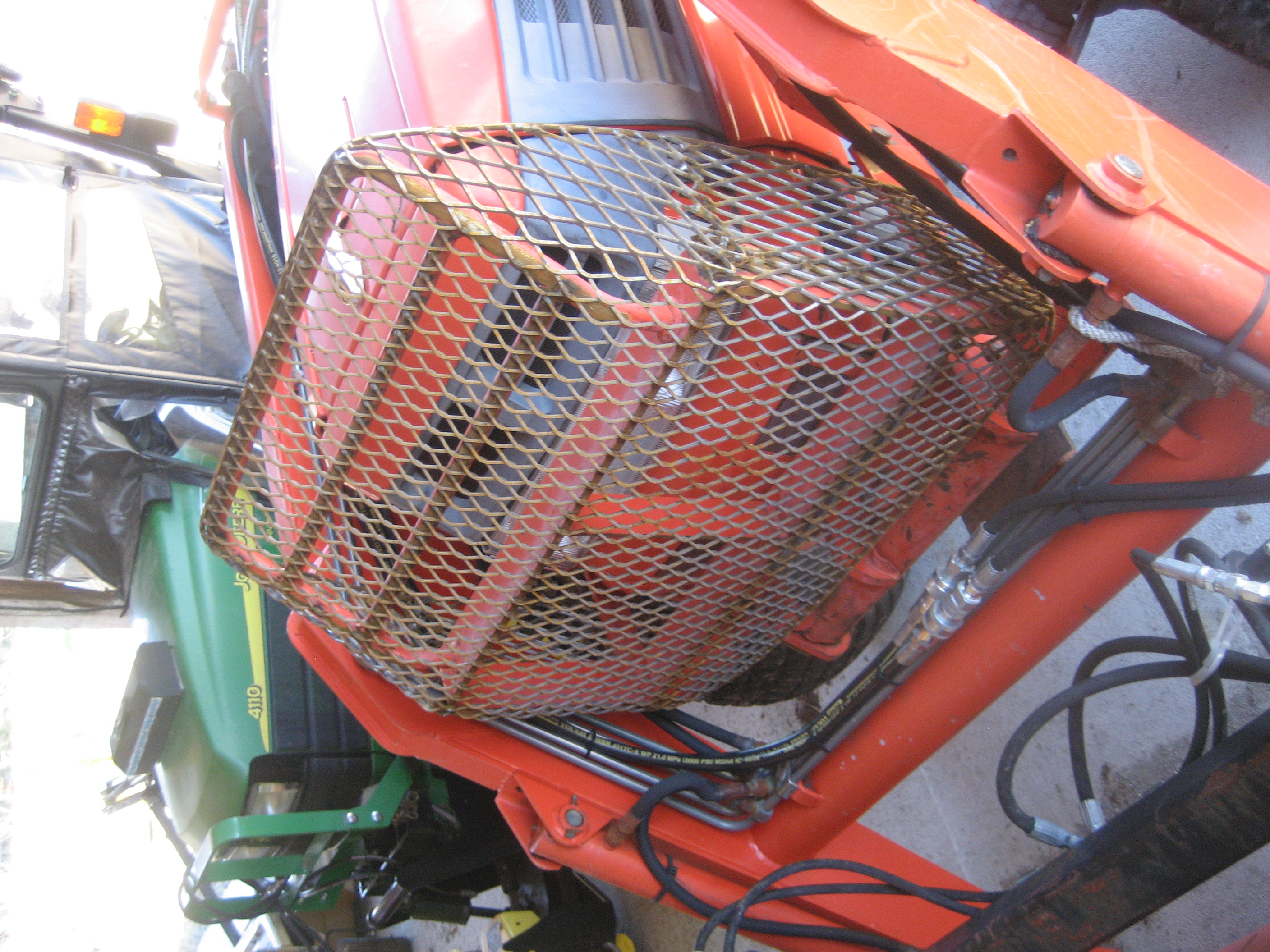

My version built onto the OEM guard.
