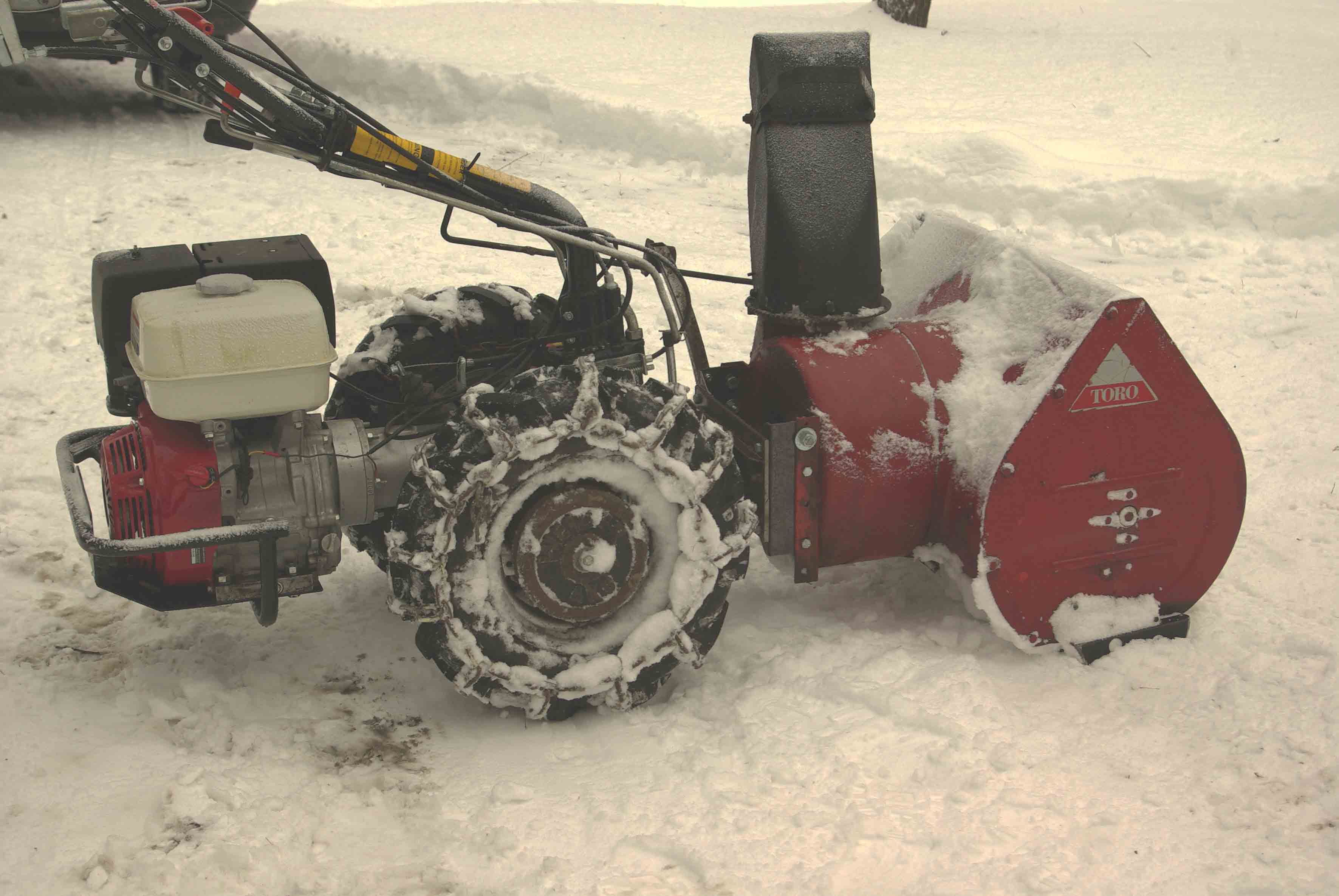

I adapt a TORO front end snowblower. Run very well. Can blow snow over 30 ft. You cannot adapt this on BCS because wrong rotation. Good luck! Oldmech grilosou.jpg
