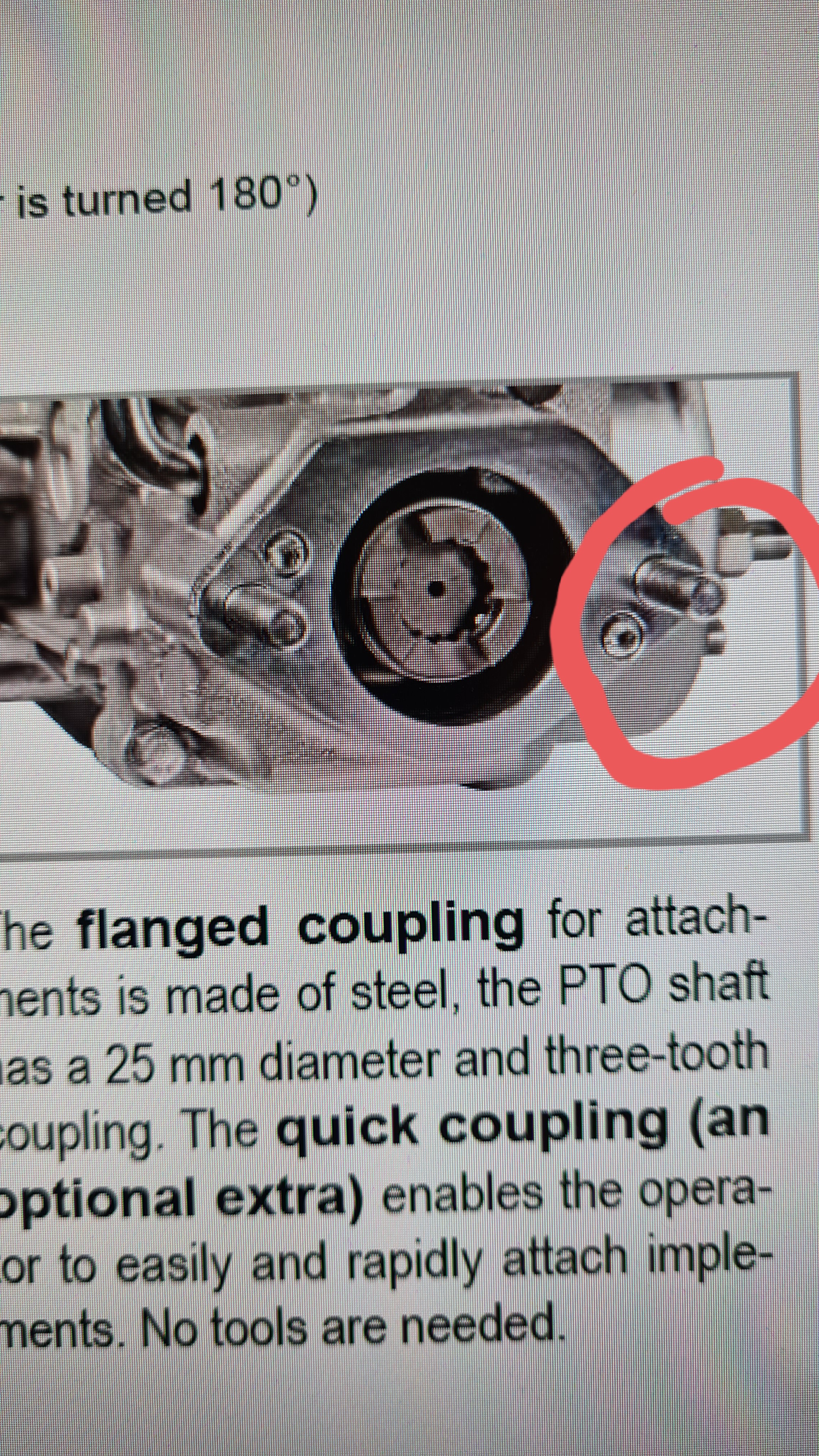

20200614_132332.jpg Has someone change this bolt?it's a special bolt?
   / grillo g 110 #14
I have replaced that stud on a BCS tractor. The original was stripped out and the repair required rethreading to fit to a larger stud. I bought the larger stud from Earthtools.
   / grillo g 110
#15
It's not plug and play? I think to buy another bolt and screwing in.

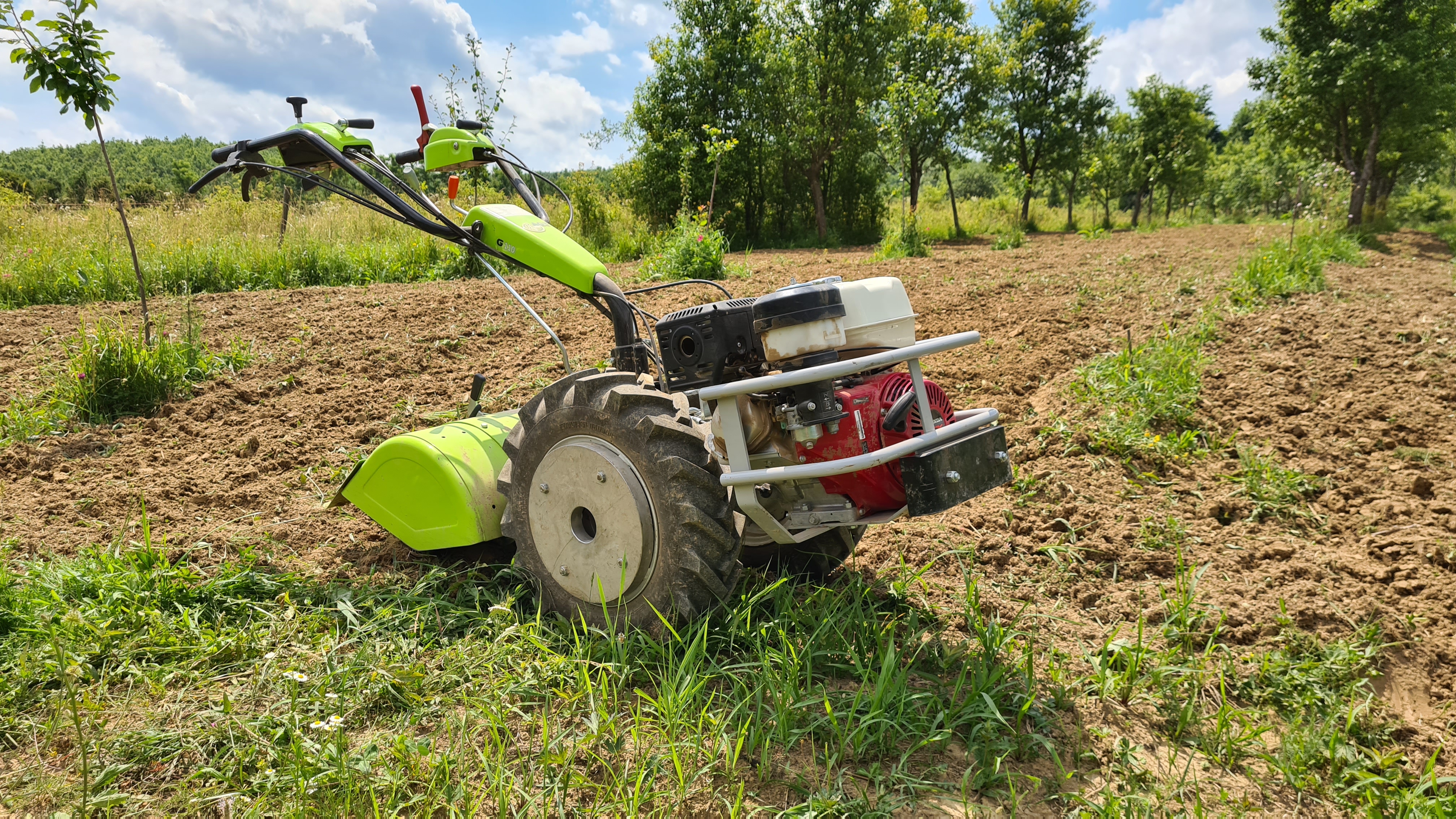

Some pictures of today...
   / grillo g 110 #17
Is that counter-rotating tiller you are using?
Is it better than regular one, how is the Grillo behaving with it? One more question, have you managed to change the bolt mentioned before, what happened to it in the first place?
   / grillo g 110
#18
It's the counter-rotating tiller but i inverse the rotation.The counter rotating tiller it's good only on hard terrain or teren that have not ben plought.On land that is plowed is good normal tiller.
