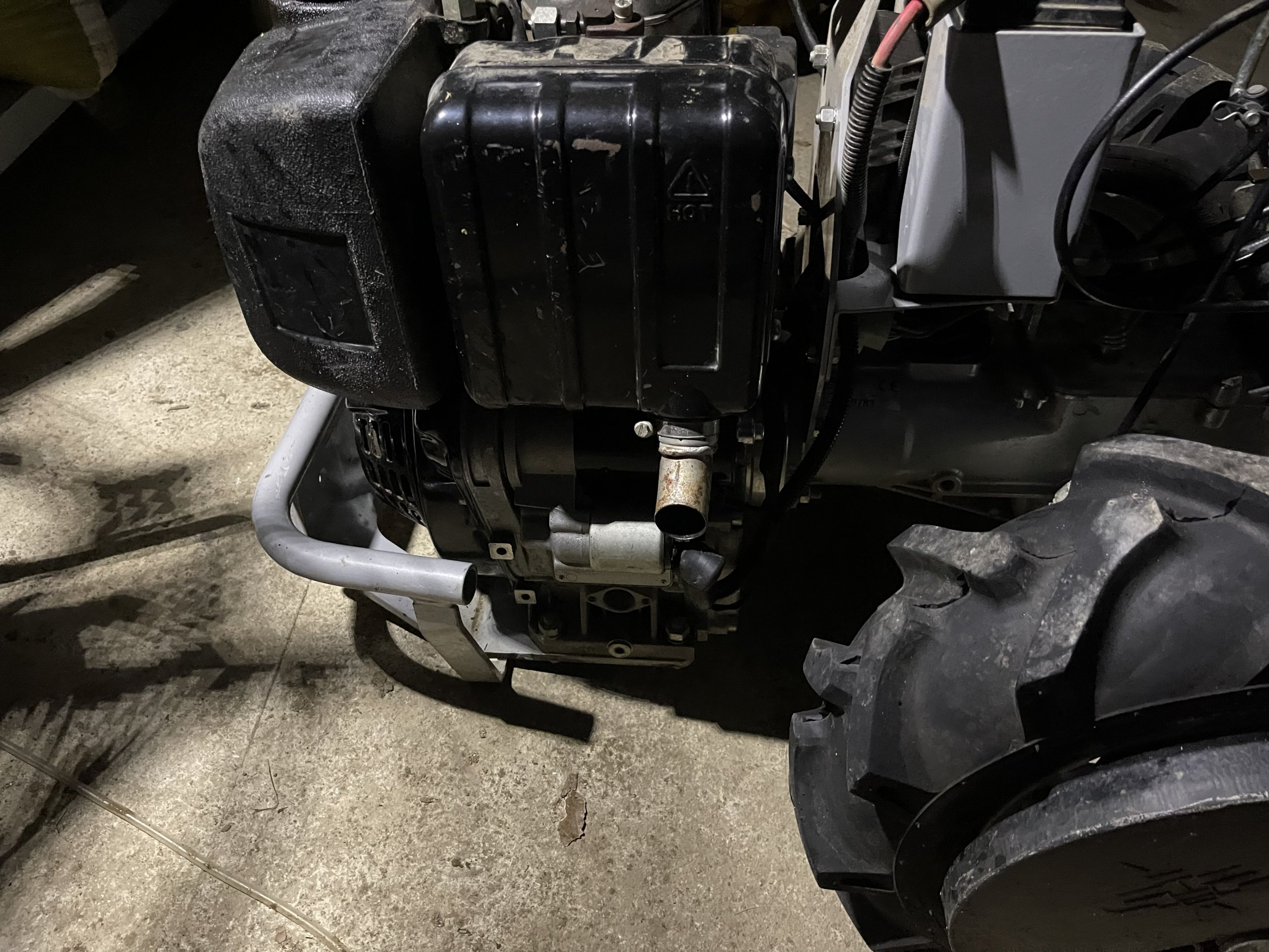

   / Grillo G110D tumble but won’t start (Solved) #4
I have a G110 day that was working fine and I switch it off and now it won’t start
Check that the engine stop lever, cable, and the actual cam on the side of the engine have returned to the "run" position. Mine doesn't tend to "spring back" to "run" and I have to remember to manually return the lever to the correct position. Still fools me every now and again.

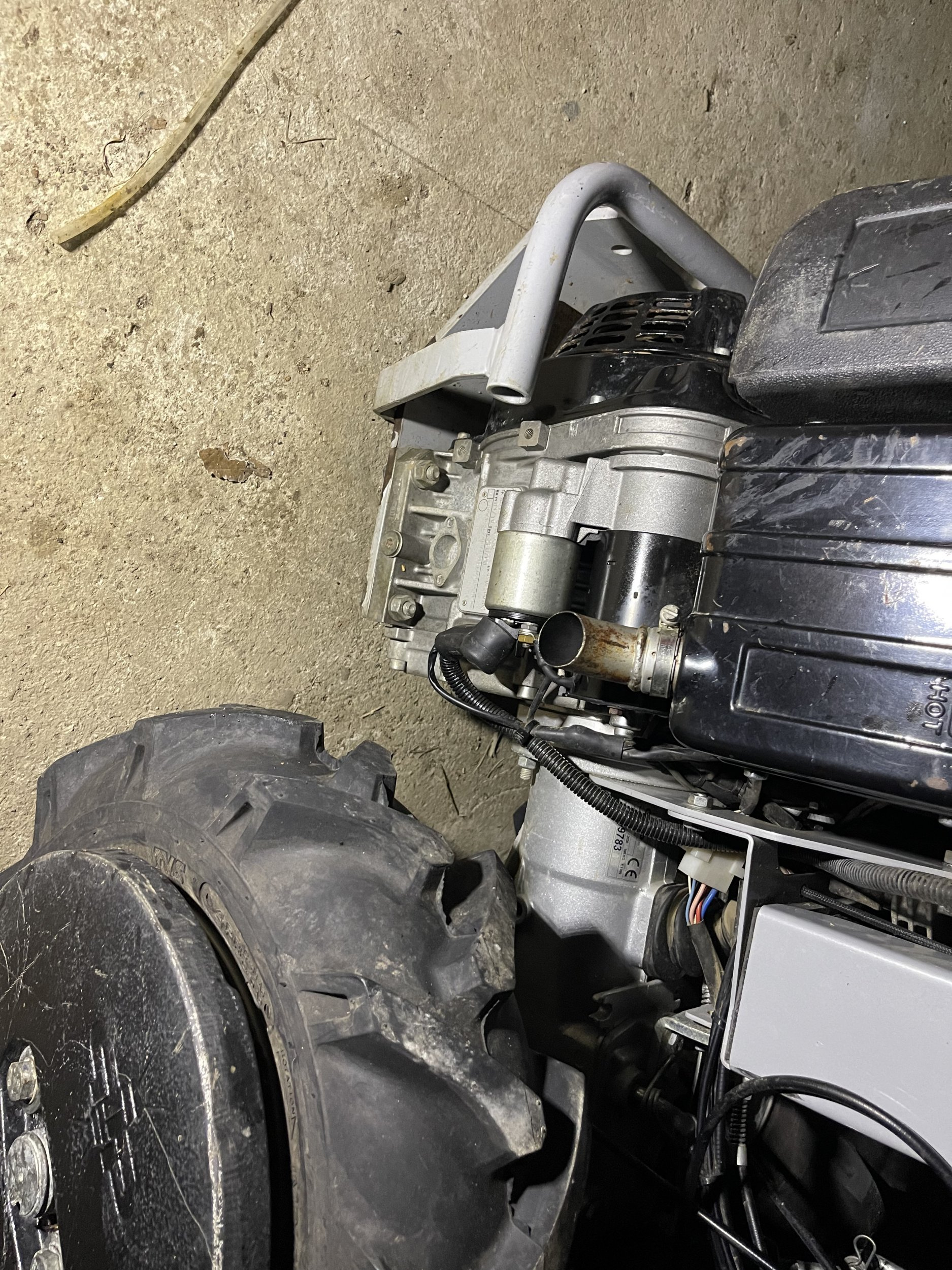

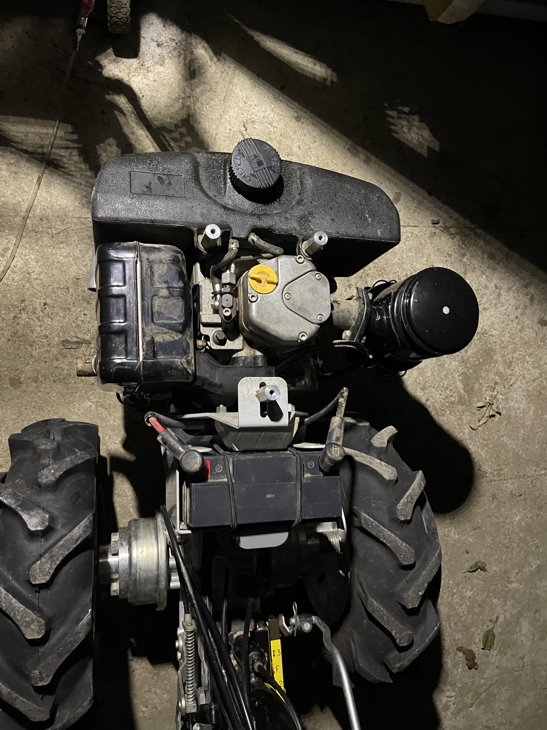

Can you put out where the parts are located on the tractor
Would be greatly appreciated

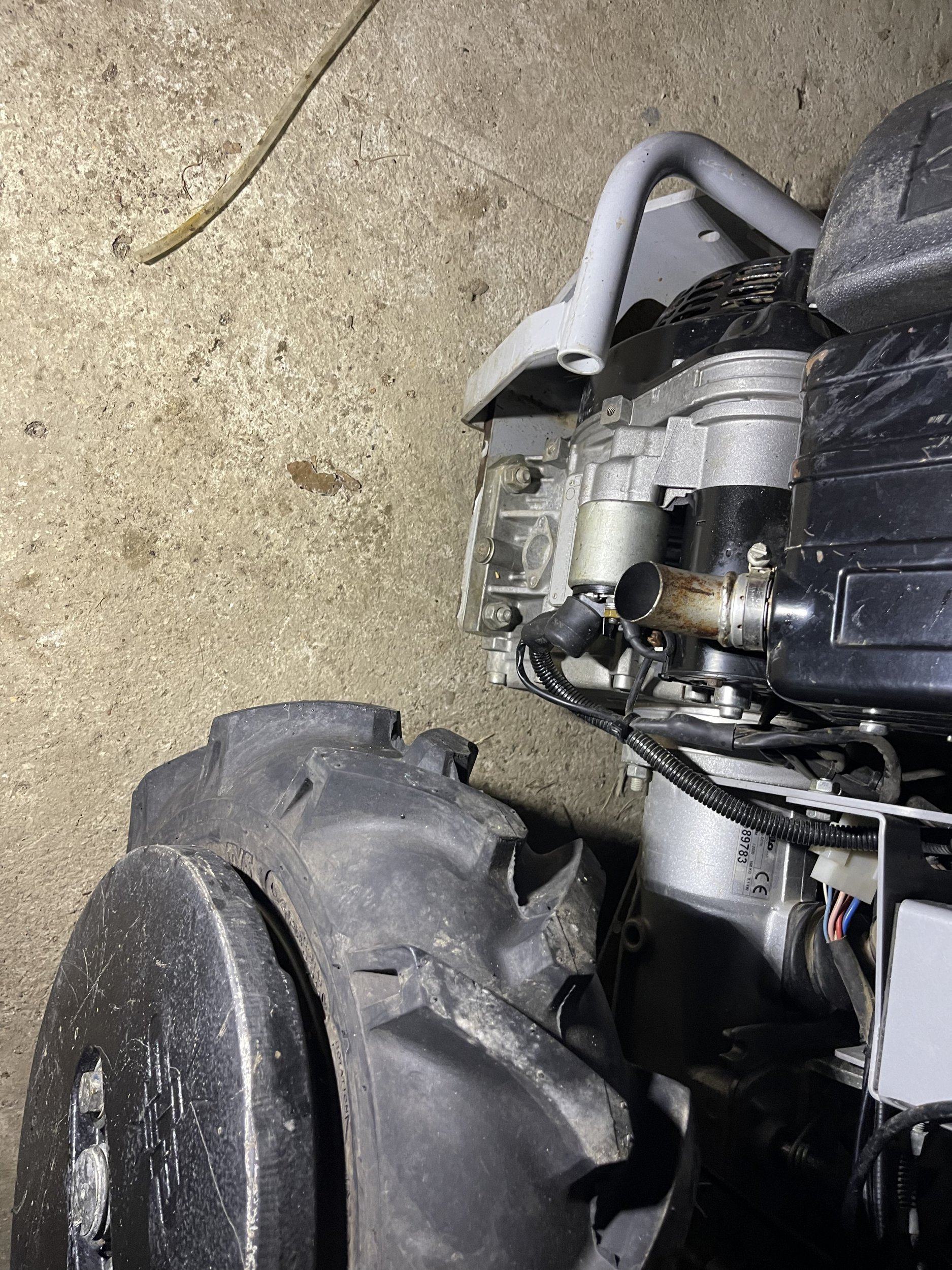

I uploaded some pics can you point out where to check

   / Grillo G110D tumble but won’t start (Solved) #8
It's the lever you push on the left handlebar to stop the engine (on mine anyway). I believe the cable runs to the front-bottom corner of the engine on the air intake side (which would be the top right area in your photo, but vertically at the bottom of the side of the engine). I can take a look tomorrow. From memory there are two cables that control engine speed and the engine cutoff in that spot - the engine speed is tight and difficult to move, but the engine stop is very floppy. It could even be that the bit of cable left on the end got folded up or caught on something.
