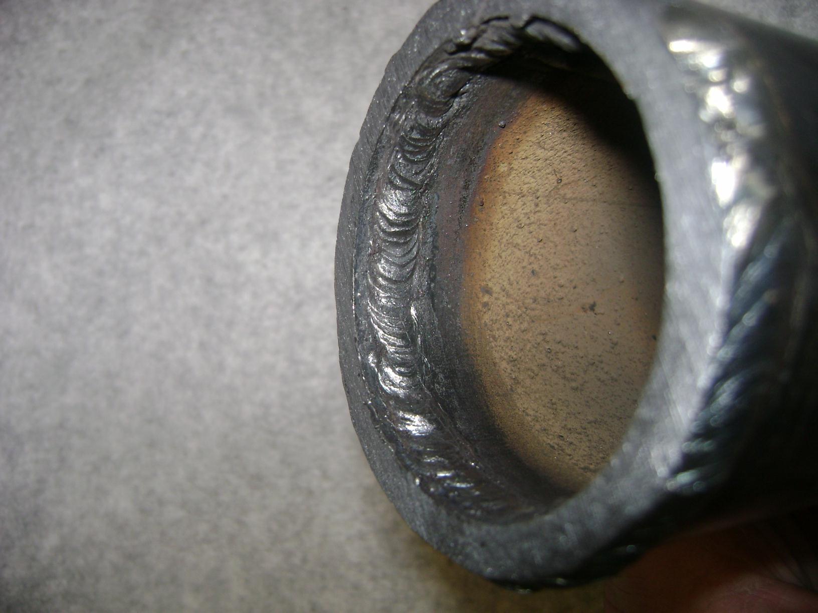

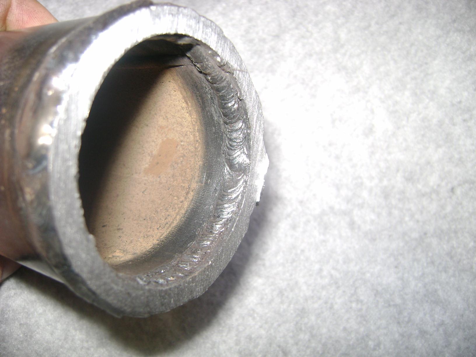

Carl, if I read your post correctly in comparison to the photos, are you recommending that I lift the hooks up slightly from the surface I'm going to weld them to? If so, what do recommend, 1/16th or so?
You don't have to, it is just a suggestion. It just insures that you get 100 + % penetration. It is a form of open root welding.
Oh I forgot, if you decide to gap the hooks. 1/16" is plenty, or even just use the same wire you will be using to weld the hooks on with. .035"?

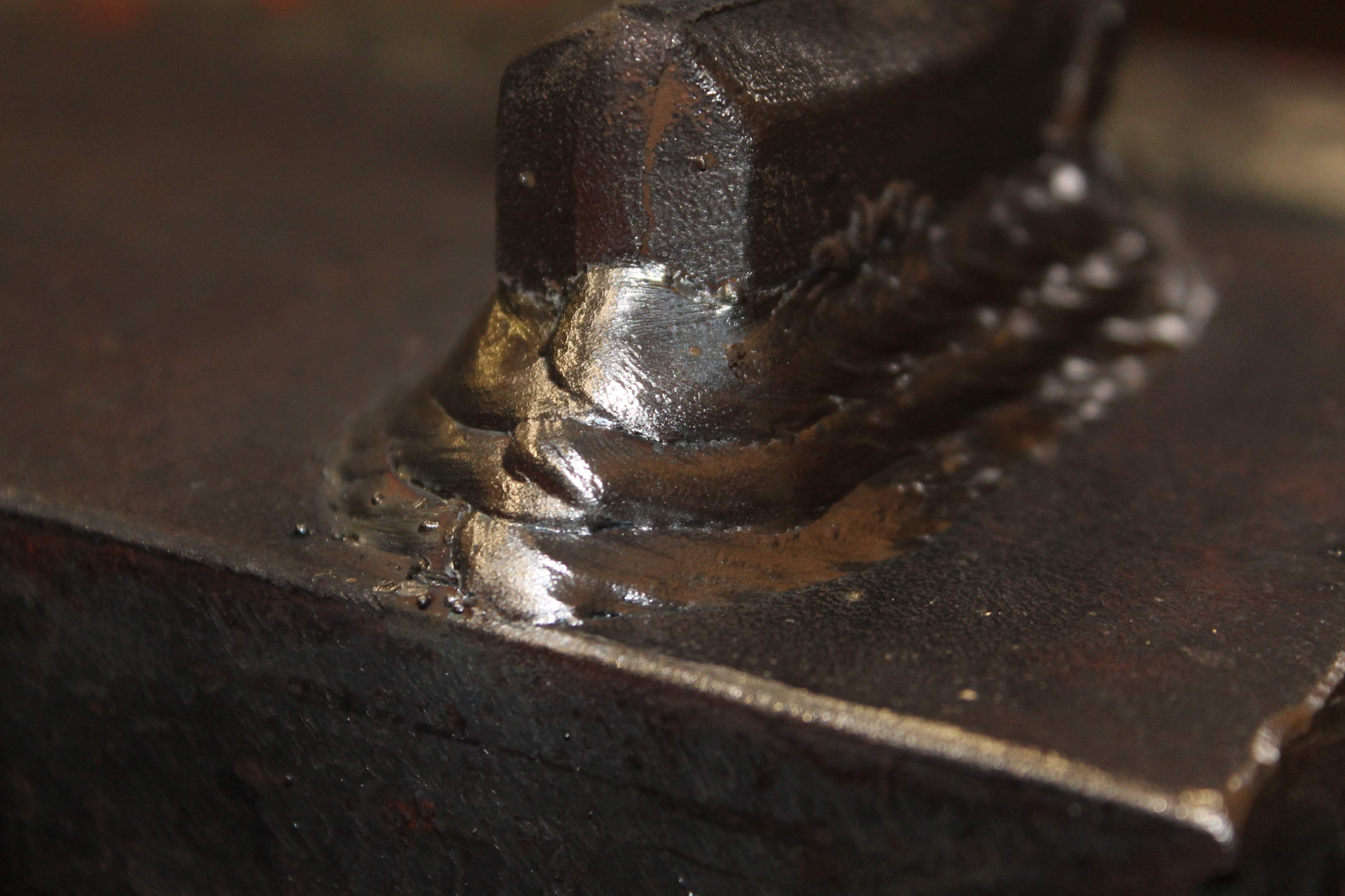

I'm DEFINITELY going to buy a couple extra hooks and practice welding them. I don't stick weld, only MIG so my choices are limited, that's why I want to make sure I do it right. I'd rather go through a couple hooks for practice than do a shoody job welding them on the bucket and have them fail.
   / Grind the bevel off weldable hooks? #29
Multi pass !!!!!!!!:thumbsup:
I had the hardest time getting a clean root on those hooks when welding them to a piece of flat stock. The rod was so deep in that I couldn't really see what the puddle was doing.
   / Grind the bevel off weldable hooks? #30
Weld a good first pass then add another on the bottom toe of that weld. Then one on top of the second weld. Use some scrap pieces to practice on. Check the pics on my post. I pulled out some 30" oaks 50' long from those hooks. Those were even welded with my old Herbert welder!!:confused3:
