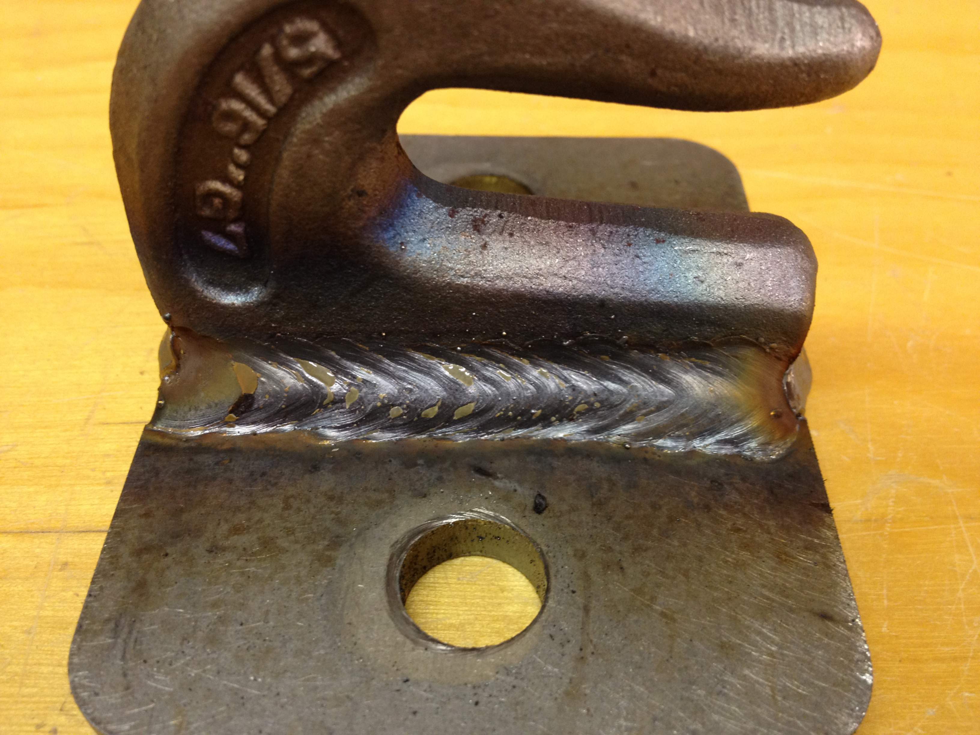

   / Grind the bevel off weldable hooks? #35
Here is one of mine:
Miller 210, Lincoln L56 .035" wire, 75/25 gas.
Don't forget to tip the hook slightly away from the first side you tack-the heat will pull it straight, then weld the opposite side.

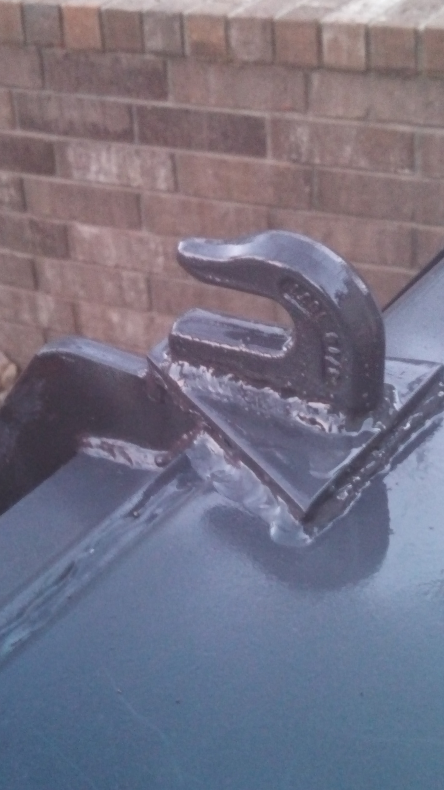

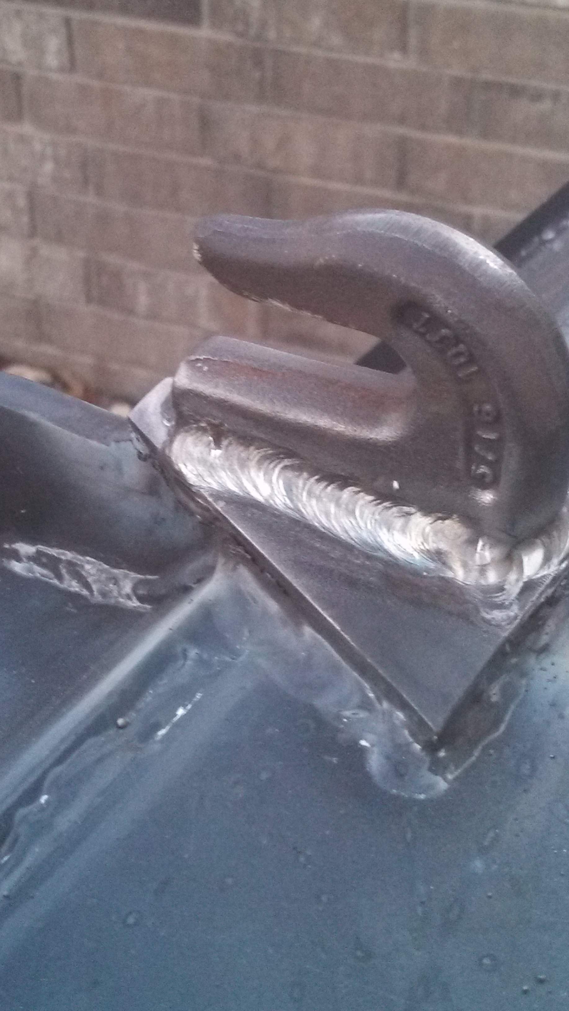

Here is one of mine.... Stick rules:cool2:
   / Grind the bevel off weldable hooks? #38
Good looking bead, Bro...

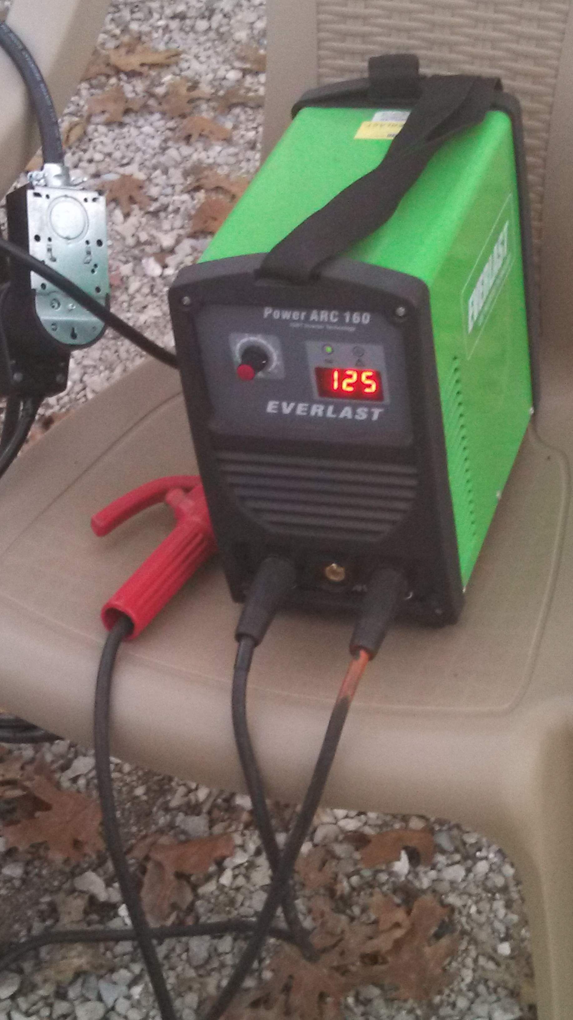

Thanks Roy, just my little chicom welder you see there at 125 amps some 1/8 inch US Forge 7018 .
This is on my Kioti, when I looked at the bead, the thought that went through my head was that my bead on the hook looked better than the MIG weld on the the little plate that the Korean guy did.

   / Grind the bevel off weldable hooks? #39
Good advice and a good lookin' bead, Kenny!!
