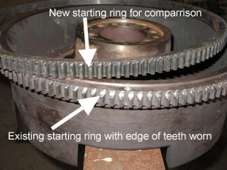

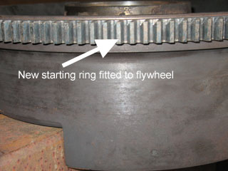

You should look at the teeth on the flywheel not just for a broken one but they also should be tapered in a way that will allow the two gears to engage each other. This is a small picture but it's the best I could find showing a good and bad flywheel ring gears. If you look closely at the second picture you can see the tapered tooth profile of a new ring gear.

.... In this day of just replacing parts this is one of those things that is rarely done anymore, I'm showing my age :laughing:
Your right about usually stopping at a bad spot... I remember changing ring gear location more than a few times... and flipping them was usually a first round fix.
Labor time costs too much today. KennyV
