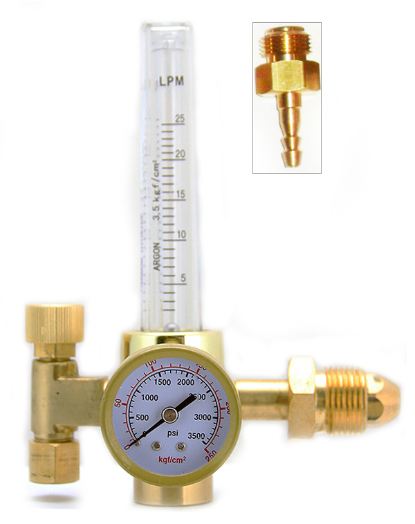

Now you guys are talking me into buying the bottle and regulator and setting this thing up properly!
I would like to learn fine work like those examples.
Then you have what you need, and apparently at a bargain basement price. The regulator is cheap, about $25, and you can rent a bottle in most places if you want. Go to ebay or HTP and get the regulator.. One like this is fine:
