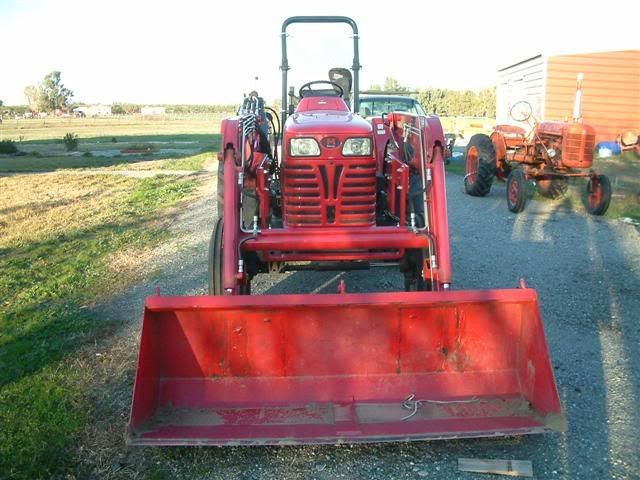

My 2008 Mahindra 5525 is a pretty typical small ag tractor (54 hp engine, 45 hp pto) with ag tires
The bottom of the rear axle is about 19" above grade. However, the support bracket for the drawbar is only 13" high. You can remove it and the drawbar if you need more clearance. However, then the attach points for the 3pt hitch lower arms limit you to only 16" clearance.
The limiting height on the 5525 is the steering cylinder for the front wheels which has 14" clearance. You can see that cylinder in this photo.
So, realistically, 12"-13" is your working clearance for the 5525.
Hope this helps.
