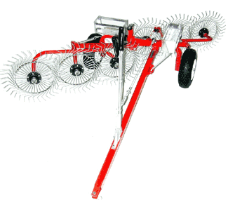

I have the 8' Estate Rake you show in your second post. I've only used it a couple times, but it does a pretty good job. Multiple passes (2) does a better job. Also does a good job at dethatching the lawn if you set the wheels low enough. I inially looked at "hay equipment" when I was looking for a rake for a larger yard. I think the rake in your 1st post will not work very well on fine, short grass clippings. It is designed for larger straw/hay. The larger wheel rake shown in your 3rd post may work ok - though the spacing of the "fingers" may be a little wide as well. With the "Estate rake", the wheels are smaller and finger spacing narrower than a standard hay wheel rake.

Ken- The NH #56 side delivery rake (and other's like it) is driven by the ground, correct? If so, why could it not be pulled by a Farmall A? Also, do you or anyone else know if a smaller version of this style rake? I realize this one may be too heavy to pull, but I'm sure there are other smaller ones out there.
I'm starting to believe my first gut feeling that this style of rake will not be able to pick up grass too well.

RLW- Do you have a hard time keeping the estate rake going straight behind you, or does it "crab-walk" a little? I've heard that you need plenty of weight to keep it following you in a straight line. Also, is the rake height infinitely adjustable? Could you elaborate on the adjustability? what's the diameter of the wheels?
Rambler- The estate rake pic in my second post is correct. I guess It may look like it's upside down, but it's pictured correctly.
It seems the estate rake will be the best solution. I was just concerned that a non-powered rake won't work too well.

Rambler- here's a little different angle on the estate rake.

While I have never used a small estate rake, every wheel rake I've ever seen has had the fingers on the rake pointed like they are on your bigger wheel rake (third one) so they would slightly straighten out as they drag on the ground.
In your pictures of the estate rake, it appears the 'rake wheels' are mounted backwards, and would compress & bust the fingers. I'm guessing the picture nagative was flipped, or I don't know what I'm talking about.

   / Ground driven side delivery rake #20
I think the "wheels" are 24" to 30" diameter. I never put any weight on the rake when I used it. I can't recall if it crab-walked - it may have slightly.
For adjustment:
As you can tell from the picture, there are two sets of 3 wheels. The height of the arms can be changed in order to set the amount of ground engagement. Height is via a turnbuckle and attached cables. The arms also pivot to help maintain contact on uneven ground. It takes a few iterations to get the height set for best pickup.
It's a bit of a pain if you need to raise and lower the arms a lot while using the rake such as moving to different areas of the yard. The hydraulic cylinder add-on would certainly make life easier. I just left it down the entire time.
