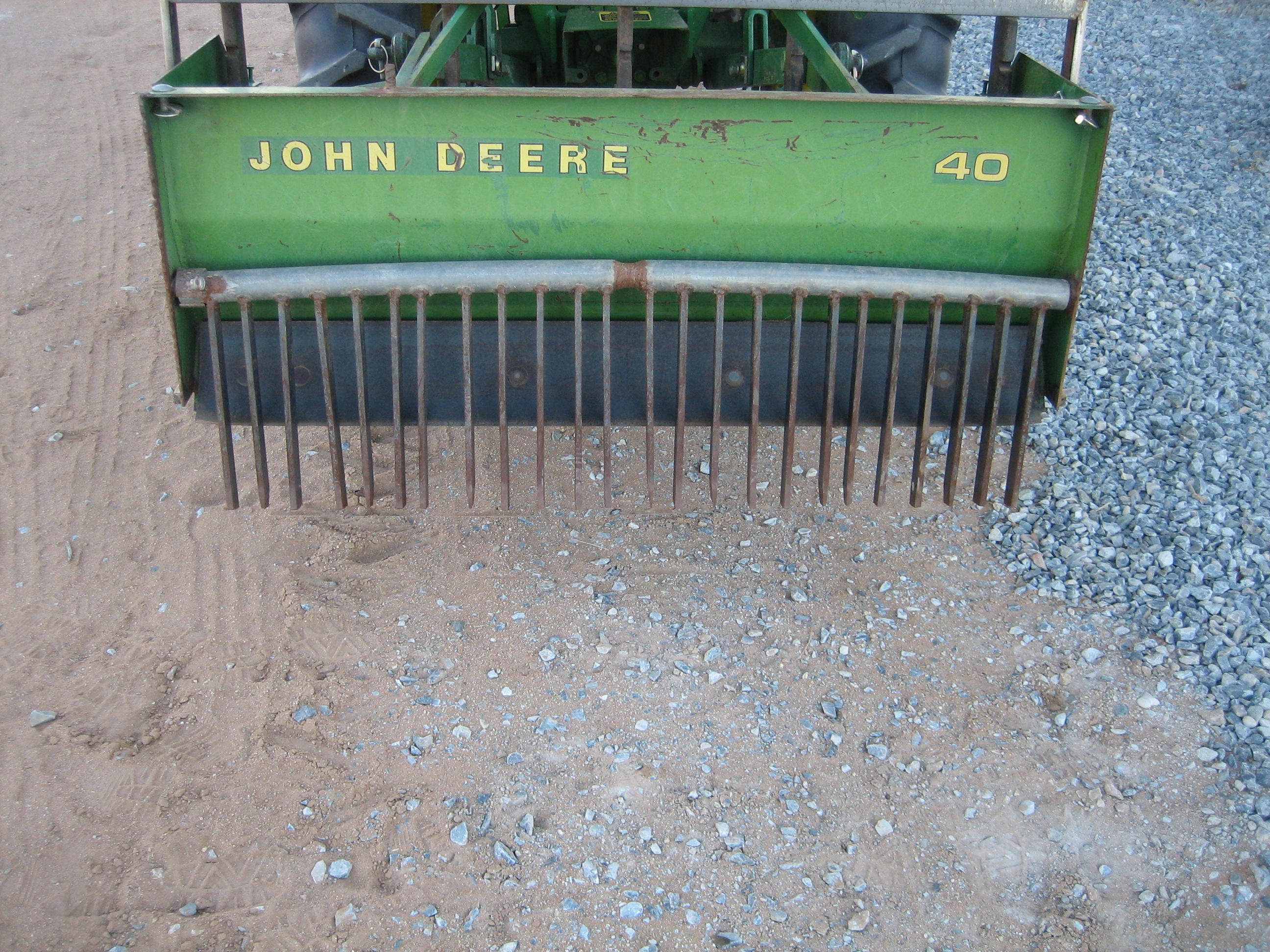

THAT is very clever!!! I really like the rake ... I find a curved-tine rake to be too aggressive many times. Also, looks as though the float might function as a "hula" hoe for those sparse but prolific dry summer weeds!
Here is a picture of the rake in the operational position for pushing( it will flost back when going forward so you can use your blade to cover holes or level where brush was removed. If you desire not to get a sore neck then it can be taken off and installed on the inside of the box blade and it still folds up out of the way for normal blade use. It really keeps the dirt out of your brush or weeds.

It seems you put some good thought into it all! An all-in-one deal. If I viewed your pix right ... a nice use of old concrete form stakes on the rake :D

Actually they were not that old and some were new. Now that I'm building a 40x40 shop I need to buy more:(
