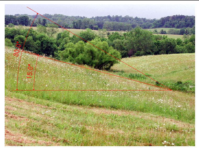

Thanks to all that posted trying to assist me. Gotrocks, I like your angle drawing. If my camera was not level in that pic, how far off could this make the angle to appear? How did you put these lines on the photo? One thing for sure is that I don't mow when wet for various reasons. It is a little comforting to know that my brushhog should prevent wheelies when going uphill. I do keep the bucket low to the ground to keep the c.o.g. low. While I think mowing horizontally and in arcs would definitely reduce my mowing time, I don't think I will ever feel comfortable on this hill to try it. Maybe with more years, I will have the ***** to try it.:D
/ Guess the angle #23
Thanks to all that posted trying to assist me. Gotrocks, I like your angle drawing. If my camera was not level in that pic, how far off could this make the angle to appear? I would guess off by angle of camera out of level. How did you put these lines on the photo? I put the image into my cad drawing pgm - draw horizontal line then draw others - dimension angles.
I would like to mention that when I first bhogged my dam going straight up and down- in 2 wd the brakes did not slow the decent very much. Now I always use 4 wd.
I go down and back up to top of (level) dam then down-up etc.

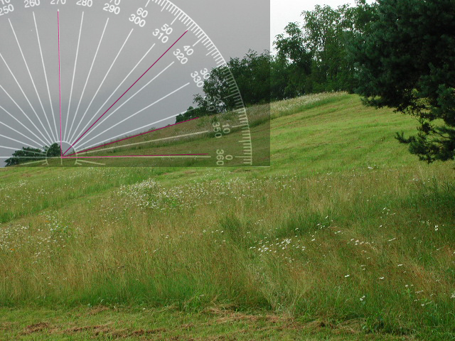

I did something similar. However, something seems wrong with these lines put on the photos as I am pretty sure the slope is steeper than what these photos communicate. I don't have a good grasp of geometry or perspective, but for some reason they don't show the angle I experience when standing on, or driving this hill.:confused:

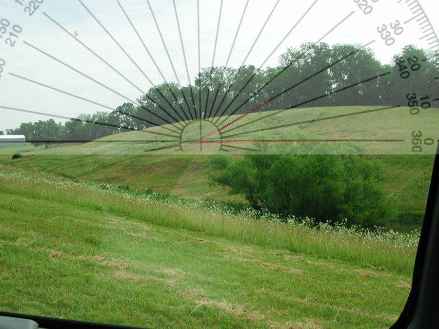

Ok here is one- I tried to make the line follow a cut I made straight down the hill. Am I doing something incorrect? Now it looks like a 30 degree slope.

The protractor needs to be at 90* to the slope , you need a photo of the slope from side on and then use the protractor . The photo you have used is corner on . A better way of finding the angle is to use an angle finder on a board and you will be certain of the angle as you are relying on the camera being horizontal to start with . The slope is 15-16* and I personally would mow it sideways and turn up hill at the end of the row , reverse back on the opposite lock and you should be in line for the next pass . I would also set the wheels at a greater offset if you can to make it's foot print wider .

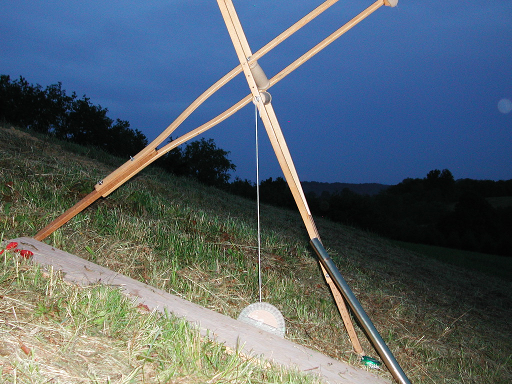

Well, I finished mowing the hill today. Did most of it in the lowest gear and speed generally travelling straight up and down. Never lost traction, but a couple of places, I would only mow going downhill. Kept the bucket low at all times. Am going to go out tommorrow hopefully and get some measurements of the angle on the upper section. After coming down and going up it, I feel confident it is at least a 30 degree slope and possibly more. I don't think anything steeper I would attempt.:thumbsup:
/ Guess the angle
#39

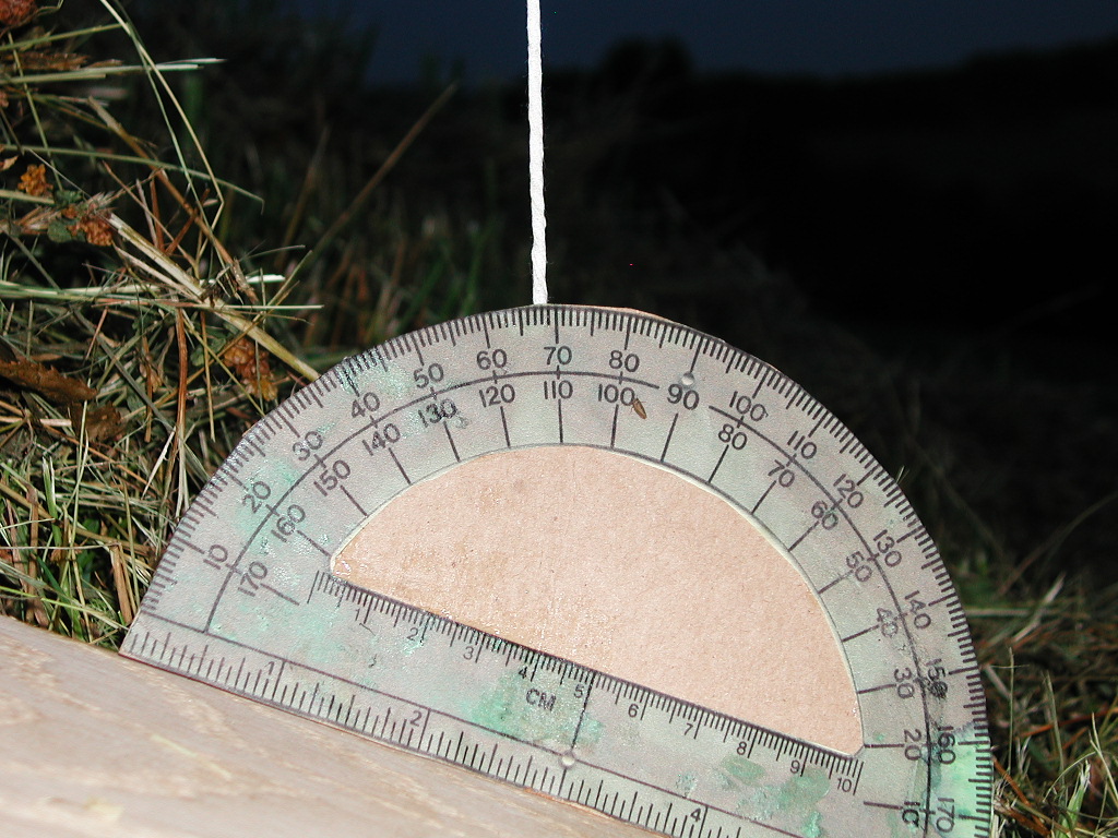

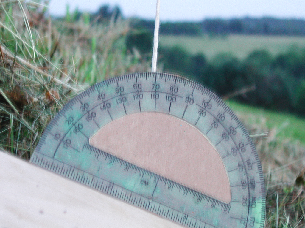

Well I got a measurement this evening on the upper slope of the hill. I'm sure there are some varibles that could give some error to my measurements. I took spyderlk's advise and set up a board with a downloaded protractor sitting on it. Set up a string for a plumb bob and came up with 21 degree -22 degrees. I am surprised as I felt sure it would come in around 30. I do think there are a couple of spots that are a little steeper-enough that I started up and didn't feel feel comfortable trying so I backed back down that section. At any rate , I got it hogged but hope I don't need to do it too many times this summer. It had a lot of honey locust, cherry,catalpa, and multiflora with a year's head start on me last year. Mowed it frequently and this year it was definitely under better control when I cut it the other day. Thanks to everyone's responses.:)

Your plumb bob doesn't go through the centerline of your protractor. If it did it would read 18 degrees.
