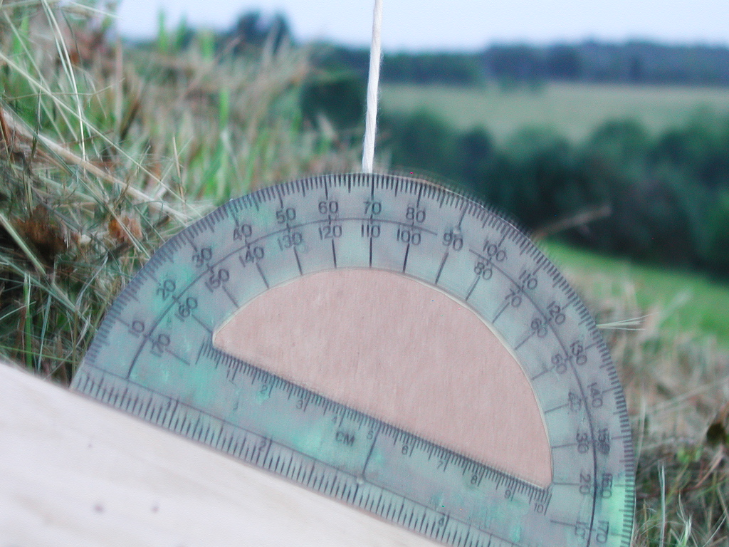

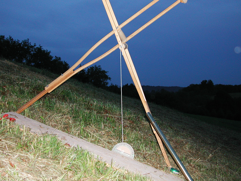

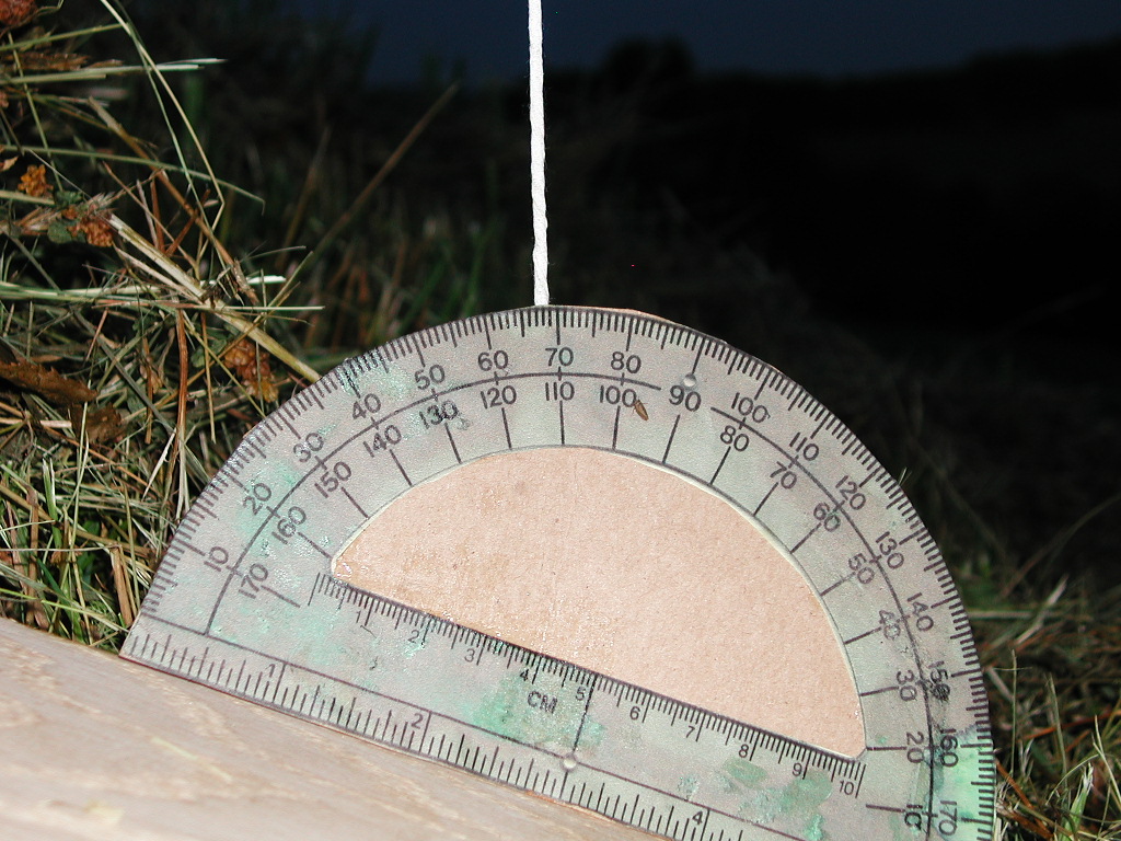

Well I got a measurement this evening on the upper slope of the hill. I'm sure there are some varibles that could give some error to my measurements. I took spyderlk's advise and set up a board with a downloaded protractor sitting on it. Set up a string for a plumb bob and came up with 21 degree -22 degrees. I am surprised as I felt sure it would come in around 30. I do think there are a couple of spots that are a little steeper-enough that I started up and didn't feel feel comfortable trying so I backed back down that section. At any rate , I got it hogged but hope I don't need to do it too many times this summer. It had a lot of honey locust, cherry,catalpa, and multiflora with a year's head start on me last year. Mowed it frequently and this year it was definitely under better control when I cut it the other day. Thanks to everyone's responses.:)

Your plumb bob doesn't go through the centerline of your protractor. If it did it would read 18 degrees.
