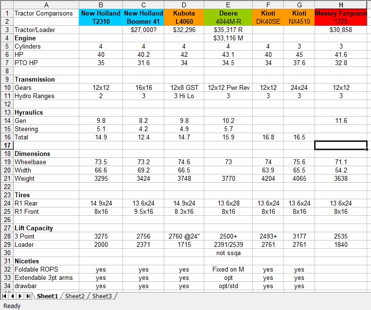

I like to spreadsheet tractor and implement specs, often a revealing exercise. I have a column for cost per pound.

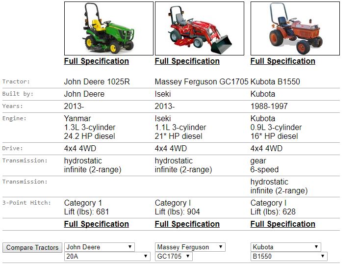

How about this much detail as a reference?
Acreage.. Deere.......Frame........................................Weight..R4 Tire Size
1-3 acres ........1xxx.........SCUT.................................................1,450..........26x12x12
3-5 acres,....2xxx .......Small Frame CUT.....................2,450.......14x17.5
5-10 acres..3xxx ......Mid Frame CUT...................2,900......15x19.5
10 acres+..4xxx ...Large Frame CUT.....3,770...17.5x24
