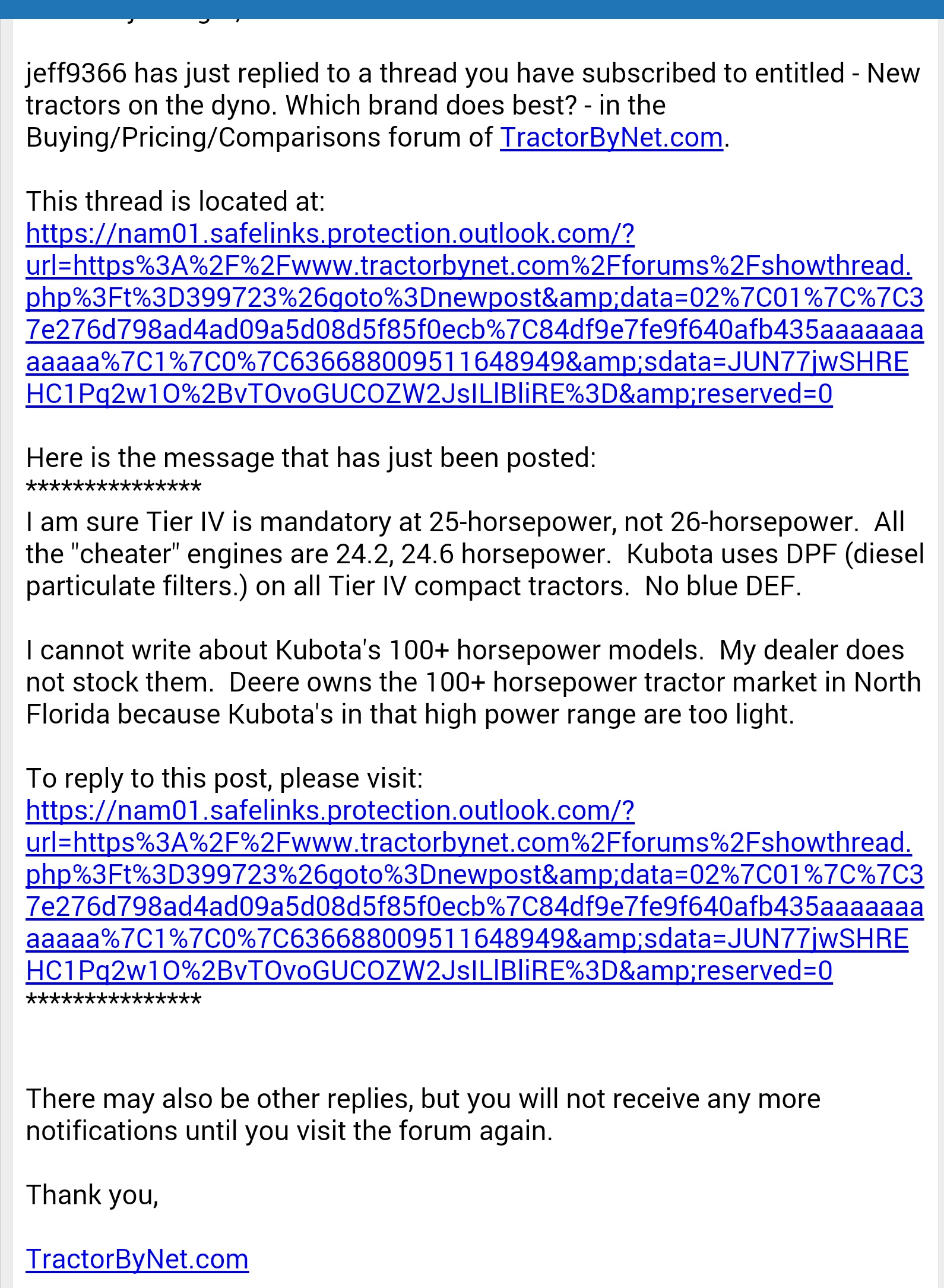

Post 59 referenced "cheater" engines, when this remark was referenced in post 60, there was a SUDDEN EDIT to post 59. A screenshot clarifies the discrepancy. Copy of original post # 59 was deleted however another cheater reference exists. That post was also later (edited) scrubbed of the cheather reference.
