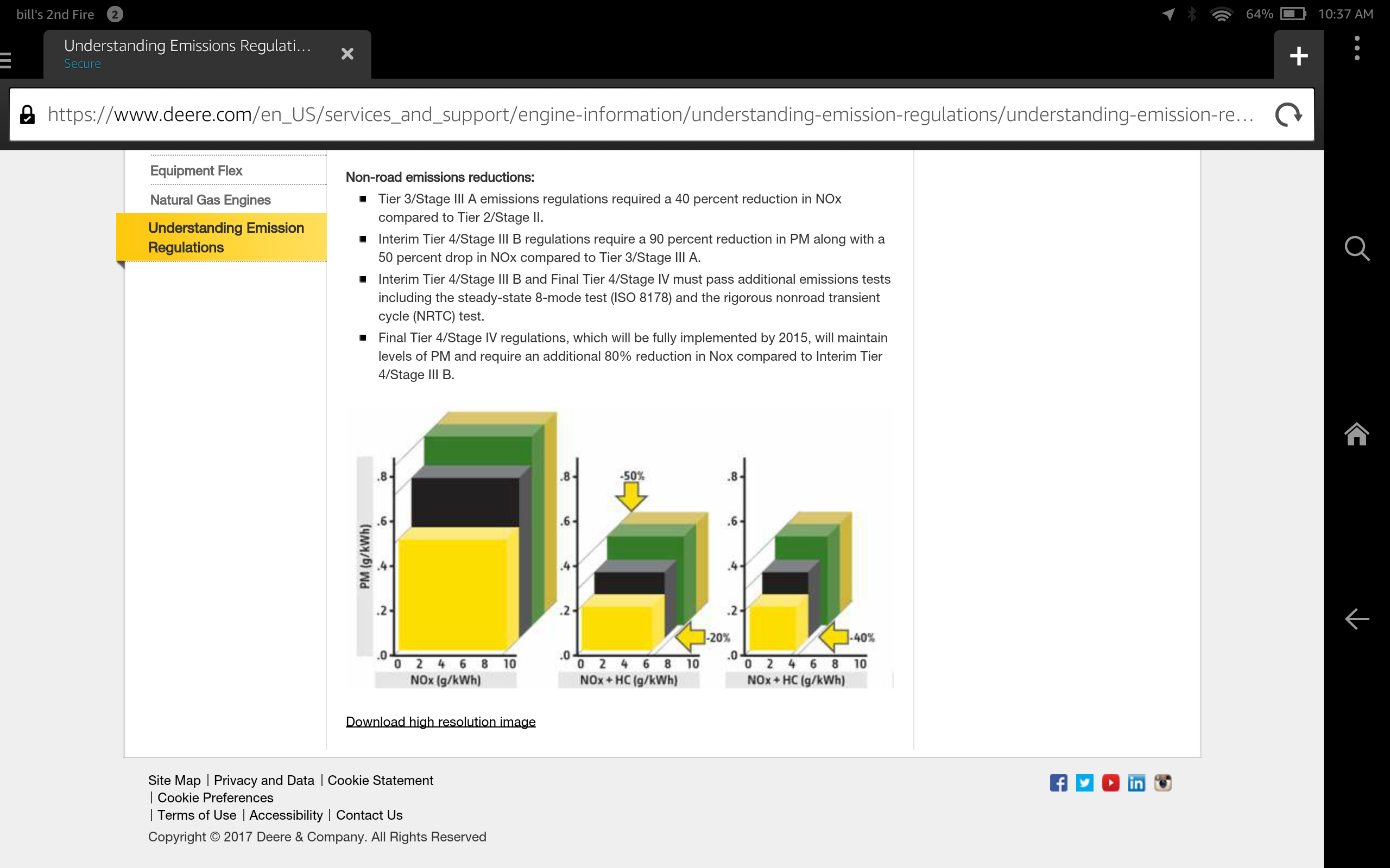

Jeffy
Parroting an article w/o performing your own research or extracting data on the internet by implying said information is accurate can easily misinform fellow members. Oversimplification of the facts may also be misleading.
There was much consternation as engine manufacturers evolved through the tier llla, to lllb, interim tier 4 and tier4 final. There was the complexity of extensive testing and achieving certification in the US and the EU, since the same engine was marketed in both jurisdictions simultaneously. The significant expense associated w/ complience played a role in the achievable emissions goals.
Your rendition, posted under your heading, paints a simple picture of connecting the dots. The actual circumstances were far removed.
