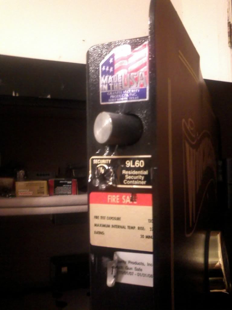

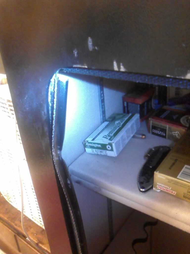

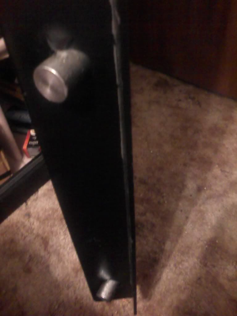

Burglar(s) skipped attempting to open the cabinet (not a real RSC), and tried to take it with them instead. Big lag bolts into the studs saved the day -- appears they tried to take a section of the wall with the cabinet but it was taking too long to do so.

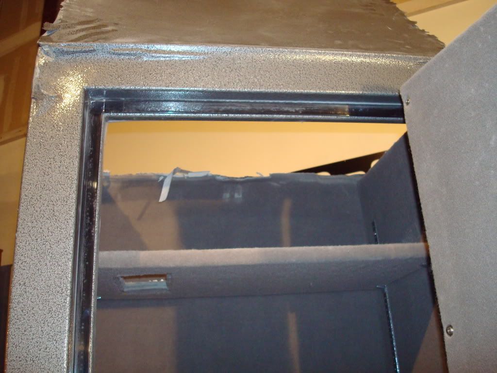

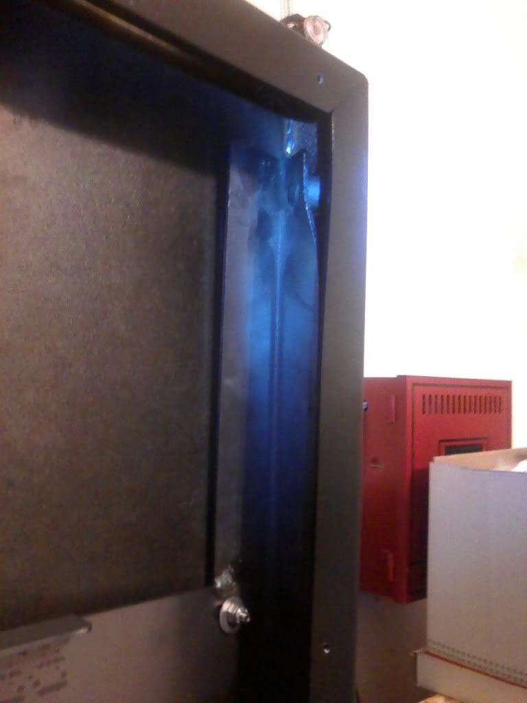

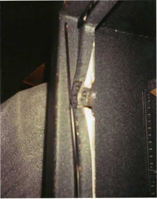

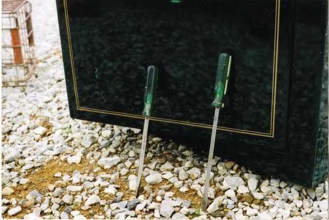

Winchester RSC opened with screwdrivers and a HiLift jack

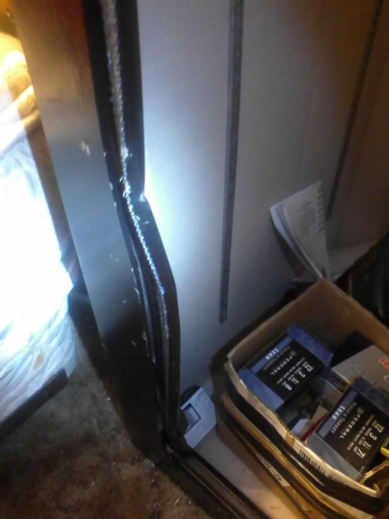

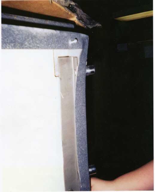

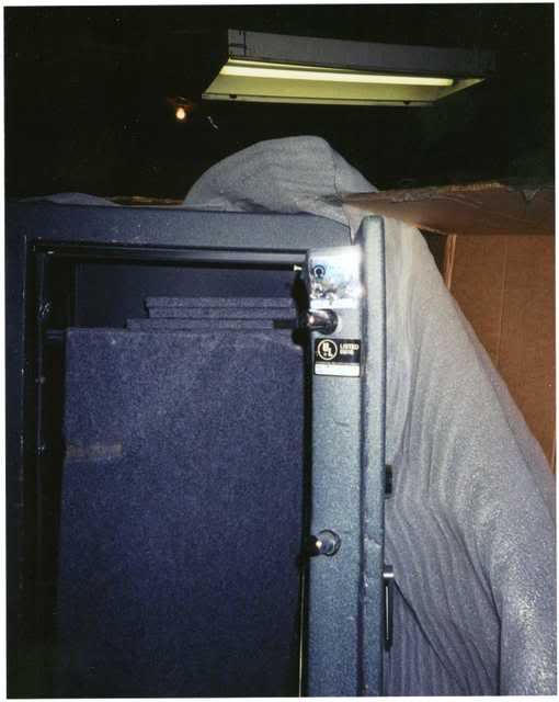

Liberty Colonial 23, pried open

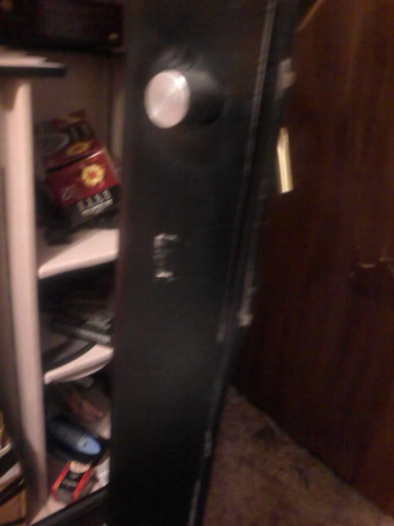

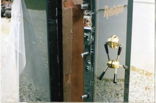

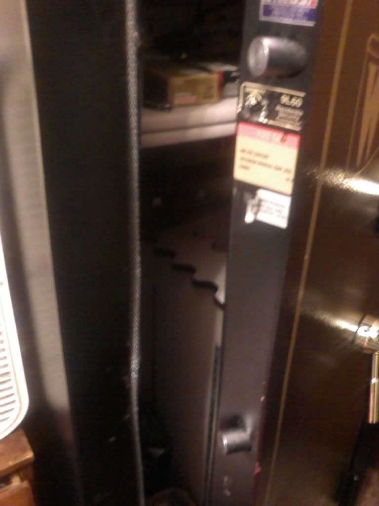

Remington safe, pried open using screwdrivers and a 6' long pry bar

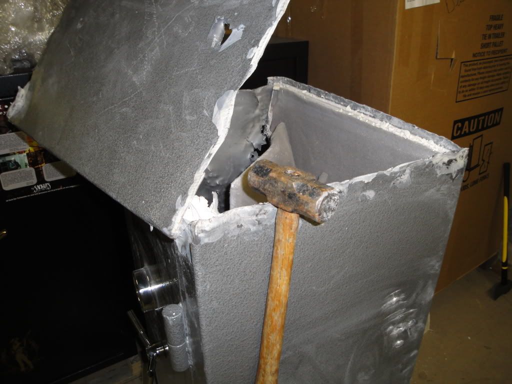

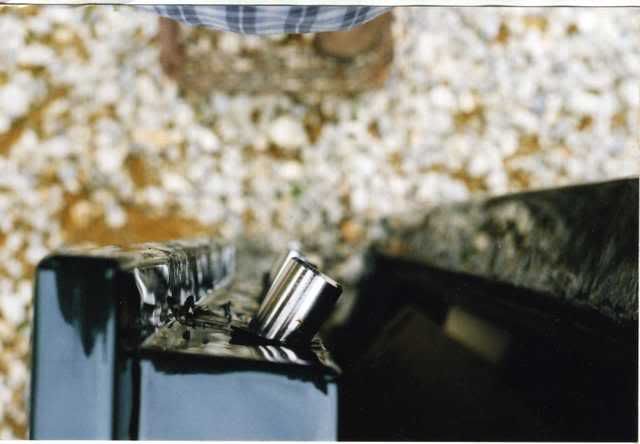

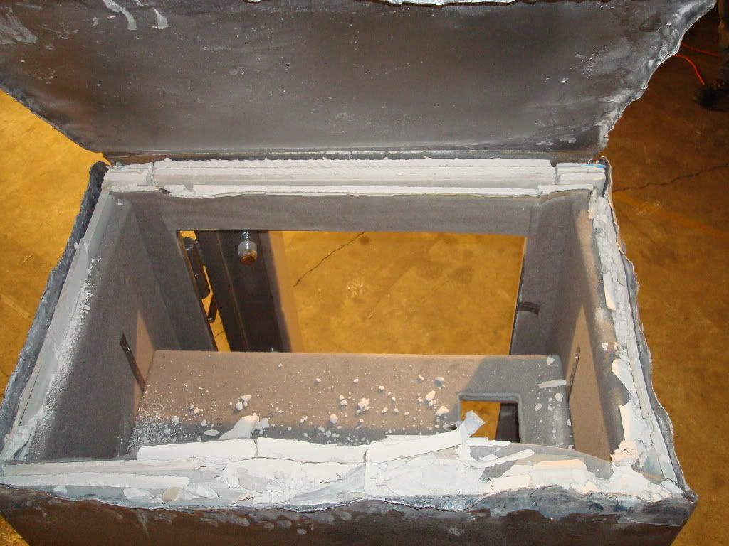

Winchester RSC, top beaten off in 3 minutes using a small sledge hammer
ps:

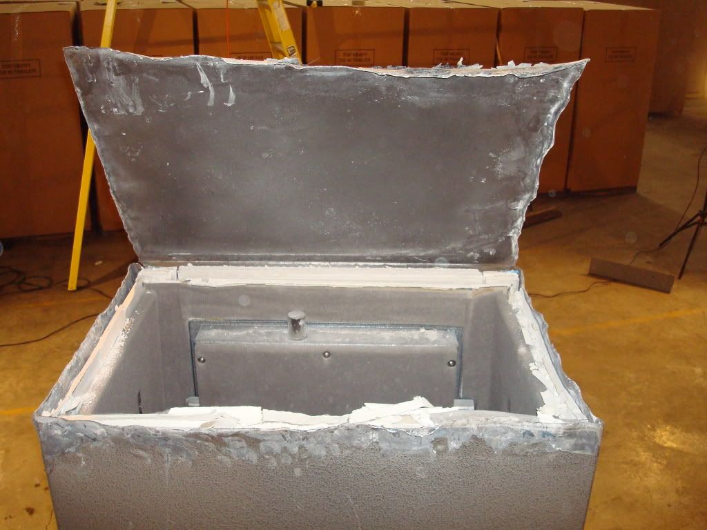

Bank branch "drop safe" -- burglary interrupted, thieves apprehended. But look what you can do with power tools!

Next we'll be seeing pics of a small air compressor and plasma cutter next to a 'compromised' safe. :D
The point of the pictures is that most all "low end" RSC's can be opened with a prybar. One key element to preventing this approach includes securely fastening the RSC such that it can't be pushed over onto it's side or back. Prying an upright safe is more difficult. Furthermore, most RSC's lack adequate bolt support -- the result of which is that if the thief can get enough leverage on a long enough pry bar, the bolt mounting(s) will yield and the door will open. The bolts held but their mounts did not. Improperly supported bolts are useless, no matter how many bolts there are. Finally, it is very important that the door frame be able to withstand spreading, and sufficient thickness steel with proper bends can prevent this approach. For this reason a shorter safe is generally more resistant against a spreading/prying attack.
If the door, bolts, and door frame are stiff enough, the thief is forced into a cut-in approach (for example, see the UL TL-xx testing above), and in general if they have to cut-in you have a good RSC design. As I mentioned earlier in this thread, above a certain quality level/price point, no thief attacks the door head on -- it is not an efficient approach. To your point, a plasma cutter is certainly a way into any RSC, but few thieves are going to take this approach in a residential burglary. So in this case you "won" as an owner of a quality RSC.
I look at an RSC two ways -- one, it protects my property, and two, it prevents my property from falling into hands where it will most likely be misused. I don't like the idea of one or more of my firearms ending up in the waistband of some thug. So it's prudent, in my mind, to purchase a high quality RSC.
