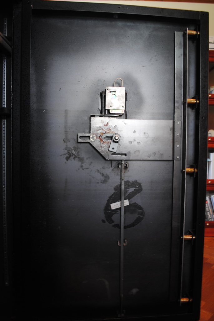

Why you should always look at what's behind the door.
Most 1k and under safes will keep the smash and grab guys and your kids out, but if you don't have an alarm system or other basic security measures in place, in a short amount of time someone with some simple tools and basic knowledge could break in easier than you may realize.
   / GUN SAFE #15
What brand s that?

What brand s that?
Cannon.
Like I said, it'll keep the kids and the guys on meth out, but give someone who has an idea of what to do and 15 minutes, and they're in. You'll find that the case with most safes you can buy at Costco or Tractor Supply. There are numerous pics floating around on the Winchester safes.
appears that one only has locking lugs on the door side.
all mine have top, and bottom and door.. one has the hinge side too.
