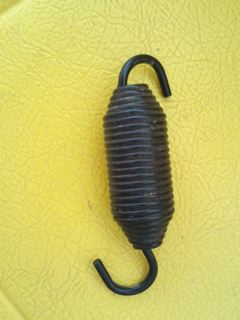

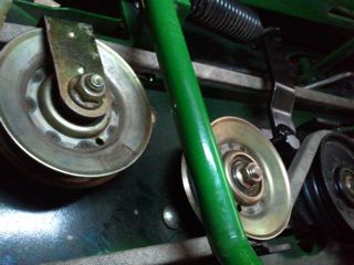

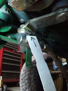

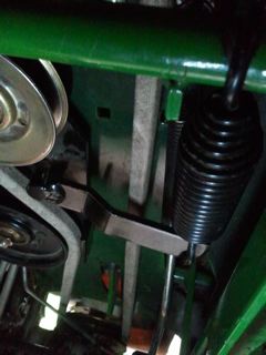

Once upon a time my adventure began finding a 3-1/2" spring next to my 48" mowing deck and discovering that the JD GX255 would not travel anymore. Had to tow it back to the garage and spend too much time underneath the tractor to find where that spring came from. See pictures #1,#2, #3.
My first clue was finding a 1-1/2" length; 1/2" diameter of an oak branch caught on the belt pulley. Had to be a million to one chance of that happening to freeze the pulley and tear the belt. Then the issue continued of where does the spring go? (At this point I did not know of the resources of the JD website and this great user group site.)
I found the notch on the pulley/idler plate and a scratch on the cross frame where it would attach. (*Trick on reattachment is to put the spring onto the notch first. Then I tied a small piece of #4 tie-line or recoil line on the opposite end of the spring to grab onto the frame.)
But before putting that spring on, comes the adventure of figuring out where the "drive belt" travels between the engine and the rear transmission. *See the John Deere website and download the belt drive and idlers pages. ref. catalog 9331/grid C12/section 50/page 2

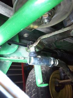

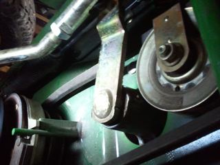

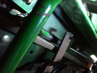

Pictures #4, #5,#8(close up pic of ball joint) will show that you 'can't get there from here' reattaching a new drive belt, as the front steering link and tie rod assemblage is in the way of putting the drive belt onto the #1 front pulley above the clutch drive pulley. You have to remove or separate that steering linkage to allow the belt to pass through.
I marked the ball joint so that I could get it back into the original alignment after the belt was placed on the engine pulley. I actually removed the link at the wheel also to make it easier. For reattaching the linkage I started both ends tightening just a couple of threads so that I wouldn't have to fight with the articulating of the ball joints. *Another note to self was to use 6-point sockets and have that metric set close by. I was also not sure it any bolts were 'counter-threaded'. Not the case, but I did not want to put too much torque on the bolt and break it. To solve that unknown, I was able to thread a spare nut onto the existing bolt threads to realize how they were cut.
Pictures #6 & #7 show the JD GX255 Drive belt routing through the pulleys and idlers. Good advice was that the flat part (outside) of the belt travels the idlers and the groove/ "V" end goes onto the pulleys. I loosen and or removed the pulleys to get the belt on past the belt guides. I also started the belt replacement at the transmission (rear) pulley end by slipping the belt over the fan blades. I had removed the deck rear two bolts to give me a little more working space at that end. I fed the belt from underneath the tractor and by using a tie-line that I attached to the belt I was able to accomplish getting it onto that pulley.
All and all, it was a learning experience that took much longer than I would have guessed. But I worked on the GX255 from the garage floor and didn't have much information on hand. If I had to do this again, I would guess maybe two hours including removing the mower deck. Good luck if you have to do it, but I know I saved serious dollars doing it myself and learned a bunch.

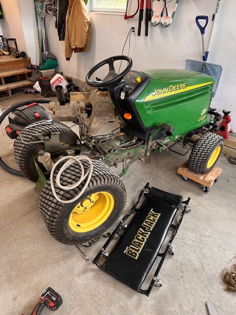

I bought a Gx255 last year for my son (14) to begin mowing in the neighborhood. It’s been a solid rig, but the drivetrain belt just went.
We towed it home with my 4052R and looked to see what may have been causing the issue. As I was looking under it I yanked out a 1/2 stick that was jammed up in there - likely helped with its demise.
I’ve watched some sketchy YouTube’s on this job, but I can’t find one that makes me think this job will be simple. Tip it up vertically - take off the operator station - crawl around under it - all sounds dreamy. I flirted with having the dealer do it, but I’m not looking to toss money in the fireplace.
Headed down to buy the belt now, but nothing is in the manual for this job.
   / GX 255 drive belt #16
   / GX 255 drive belt #17
Thanks for the reply! Agree this will be a learning experience!
When I say operator station I’m referring to the fender deck.
I found a YouTube where a guy takes that off - but I also found one where a different DIY guy hangs the tractor by the front so he worked on it vertically. Front end was tied to a beam with the fuel sealed off with a trash bag and the battery was flipped to keep it from leaking.
I’d personally like to work on it from the top and avoid the circus, as you suggested.
Just got the belt for 50 bucks - which will be the easiest part of the job. 🤓
So far, I think my steps will be to remove the mower deck, then remove the fender deck. I’ll check the pulleys for wear when it’s all taken apart.
This old thread was about the best resource out there.

I tackled the job today. It’s not bad and nobody should be afraid to tackle it. I didn’t have any directions other than what was discussed here. I just took my time and kept the workspace organized. 😎
