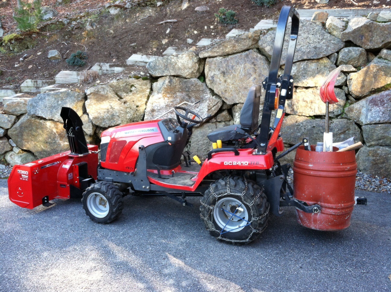

I have issues going uphill but none on my flat areas and basically have the same setup but I use 4wd, have chains on the rear and don't push the show but blow it, so maybe my 2360 blower weight on the front helps me.
Of course, steering is difficult on ice without chains regardless of grade.

I'm wondering if the driveway not being flat is a problem. As in the spots I need to fill causing the tractor to not sit level on all 4 tires. Rear chains would cost me about $80 I think so not too bad, but the steering concerns me. I should probably just bite the bullet and get them. I can make turns in my lawn and feel the back end drift around the corner. So even thought I don't get stuck, can push snow, and have steering in a few inches of snow there are still traction issues. I also slid sideways on a slight incline in the yard, so chains would probably help with that too. Makes me wonder about being in the woods, on wet leaves, working on a slope. So I might want the chains for more than just snow removal even thought I don't do logging, or deal with a lot of mud.

Here's what I used until last week when I replaced the rear drum for a grader blade. The drum worked real well but the unfrozen gravel road cost me 7 sheer bolts the first storm.
