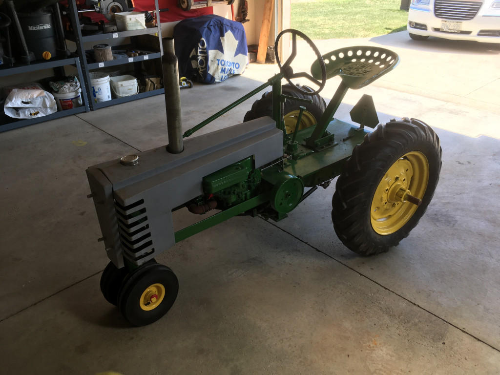

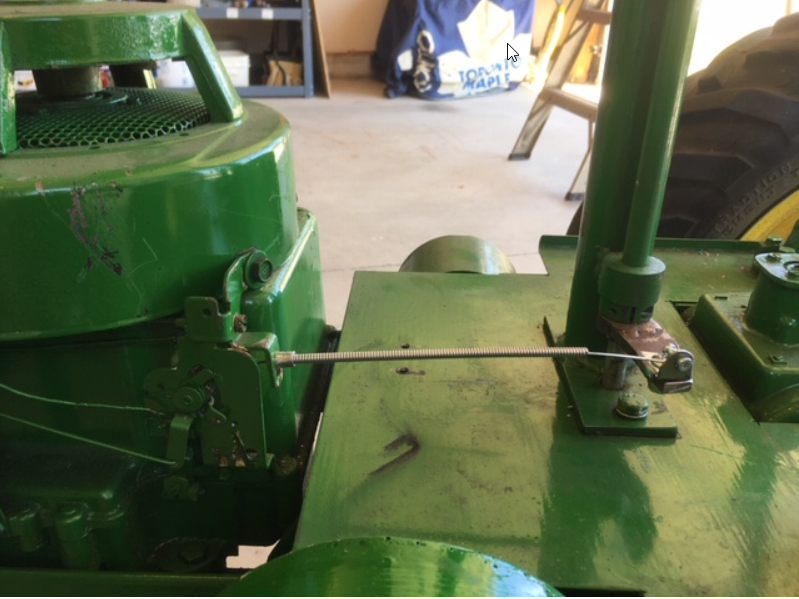

Finally got back to project and got throttle cable installed.

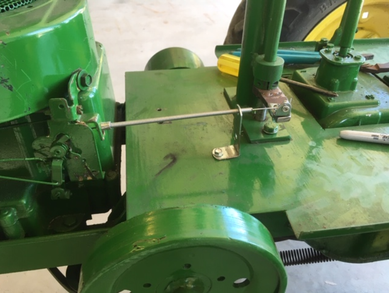

Had to install support bracket for cable.
   / Half scale replica of a John Deere H #62
Good to see you back on project.
   / Half scale replica of a John Deere H #63
you just need to make the FEL and BH, and you're all set!.. nice!..
   / Half scale replica of a John Deere H #64
Keep the updates coming. :thumbsup:

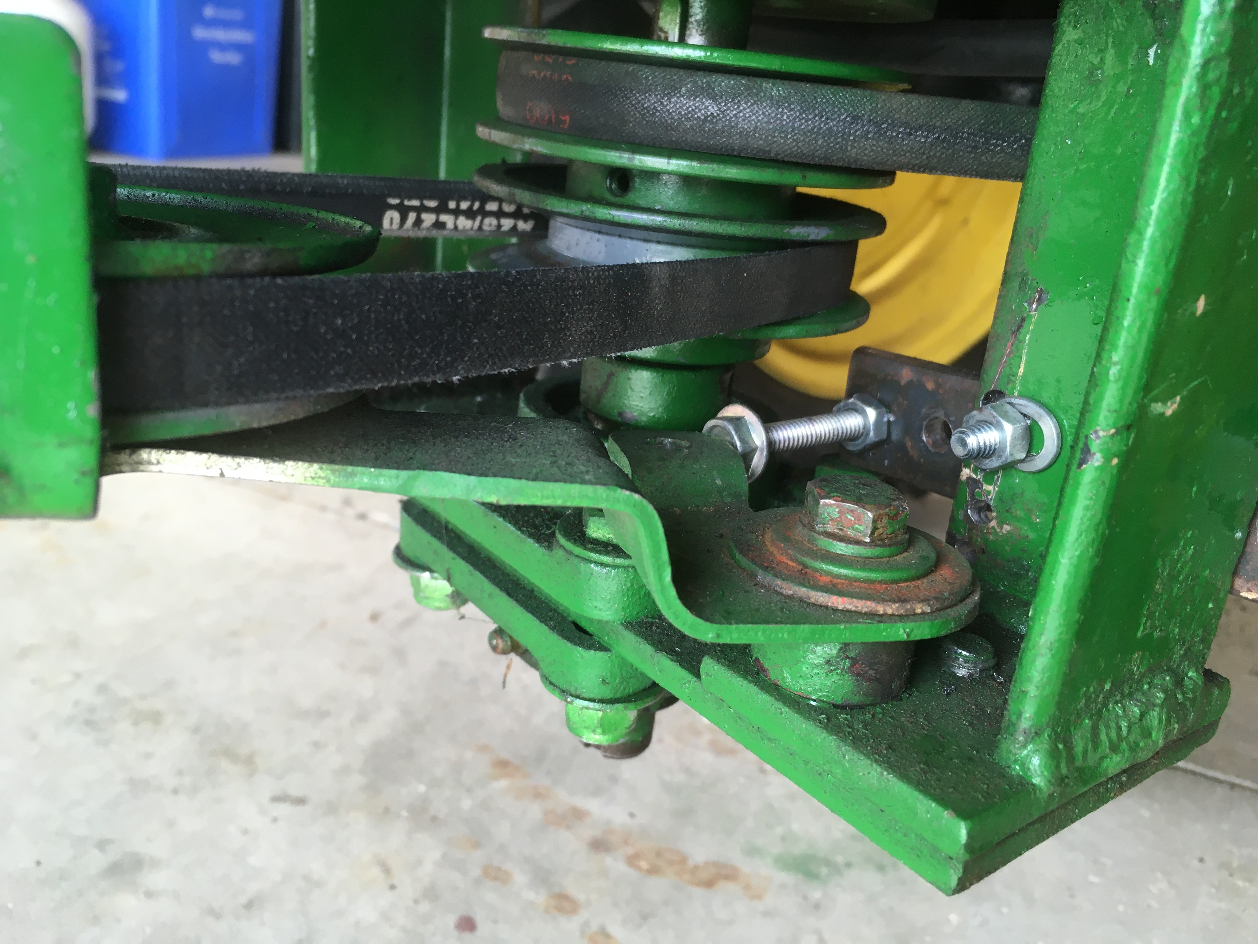

Drive belt off motor was slipping, installed an adjustment bolt to hold belt tensioner tight

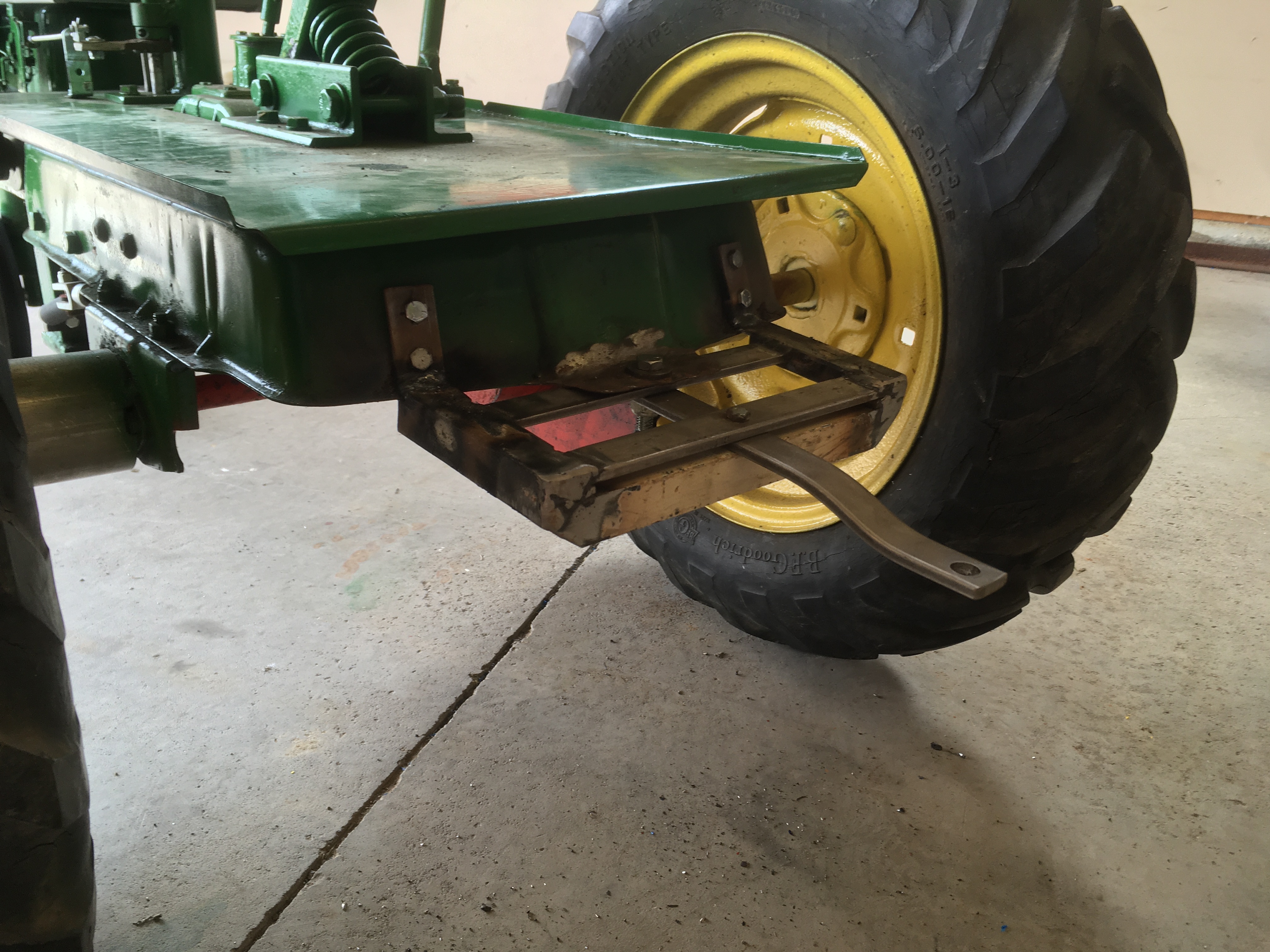

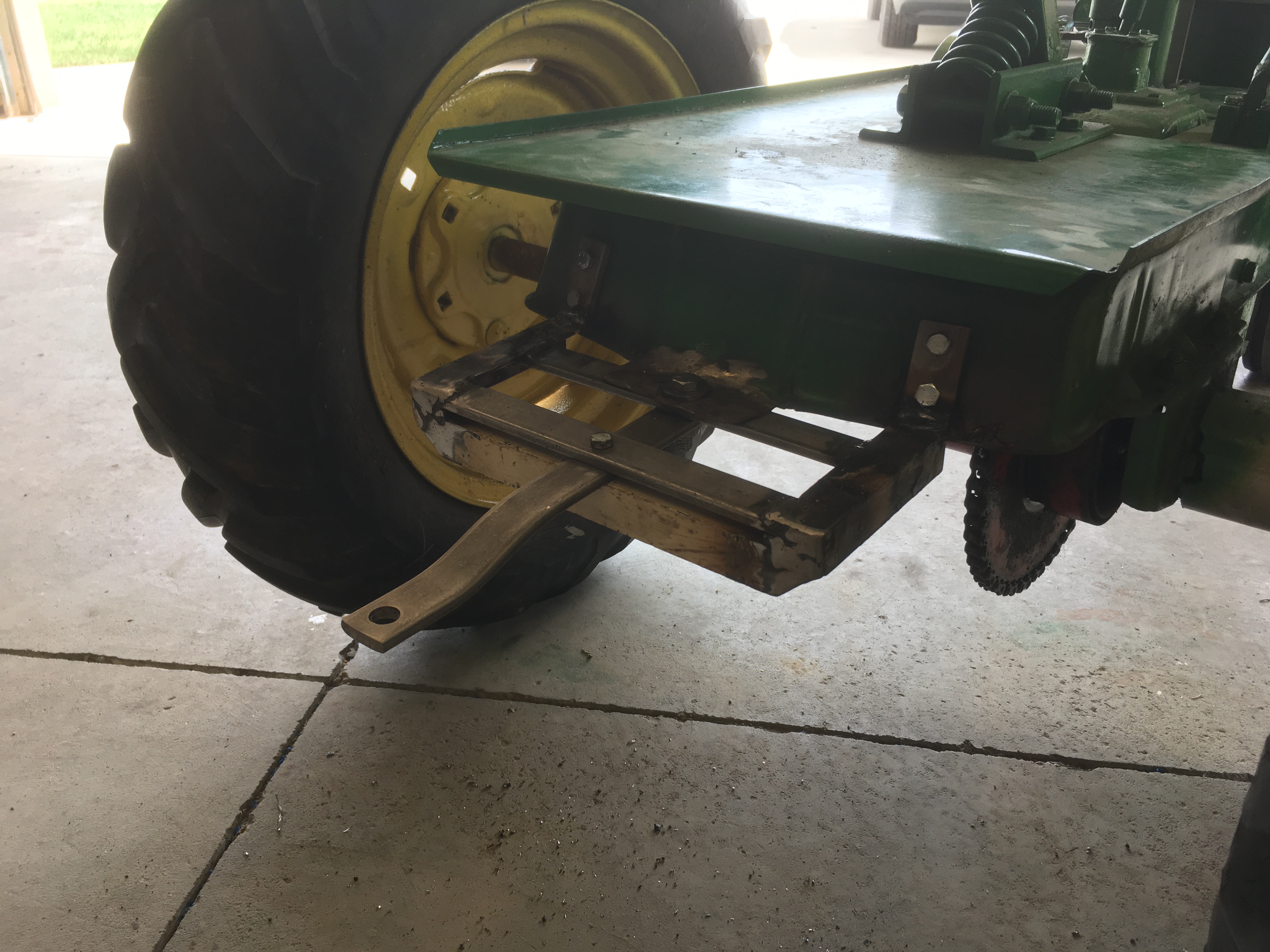

Made up a draw bar bracket and installed

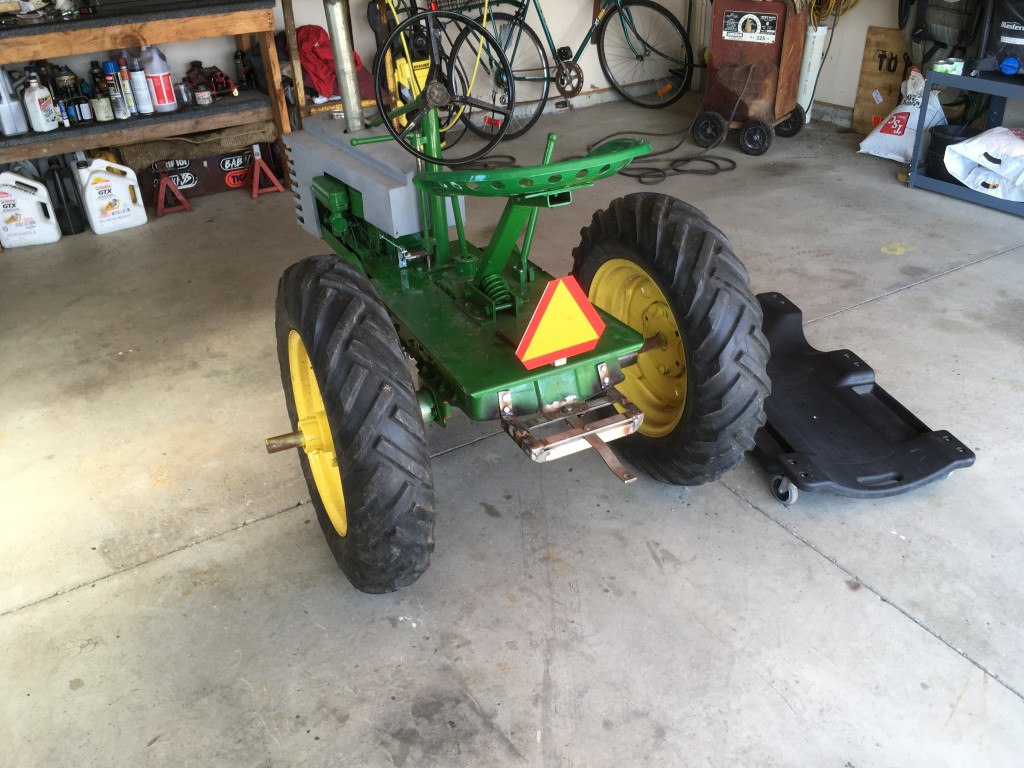

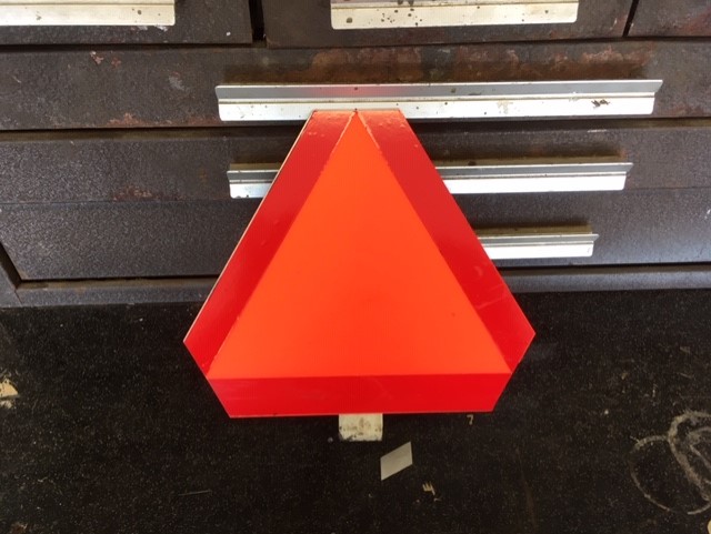

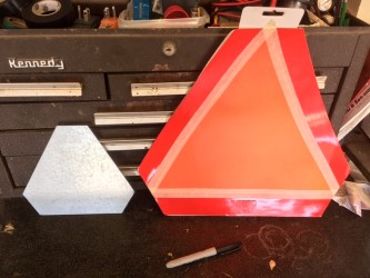

Got around to making the slow moving vehicle sign. Started with this.
Scaled it down to this.
   / Half scale replica of a John Deere H #69
Coming along nicely. :thumbsup:

Did work on bracket for exhaust, worked on hood clearance from muffler and steering shaft and mounted the slow moving vehicle sign
Replica is slowly coming along
