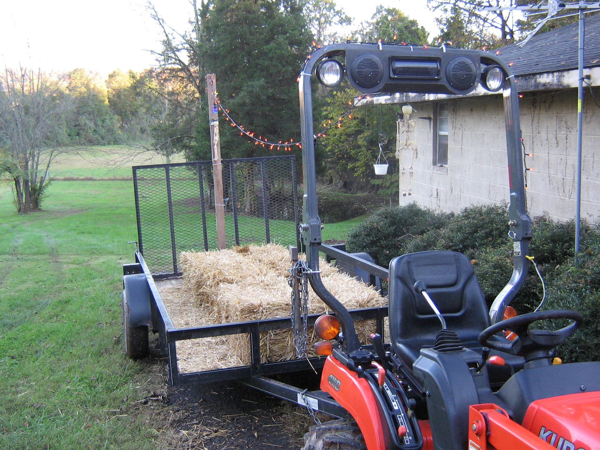

My neighbor proposed doing sort of a hay ride in our neighborhood with my BX2360 and my 6x12 trailer. I have hauled the trailer around some with the BX but wanted to make sure adding 8 or so 70 lb. kids wouldn't be an obvious bad idea? I was going to keep the loader on and maybe add a few sandbags for ballast in the bucket as well. My wife wants to add orange halloween lights so I think we'll get some good pictures out of the event.
Your BX2360 will handle it fine. I've been doing hayrides on my property for 3 seasons now and the kids love it. i pull a 6x12 single axle and I've had up to 18 men, women & children of all sies loaded and the trailer and BX nevr strained.

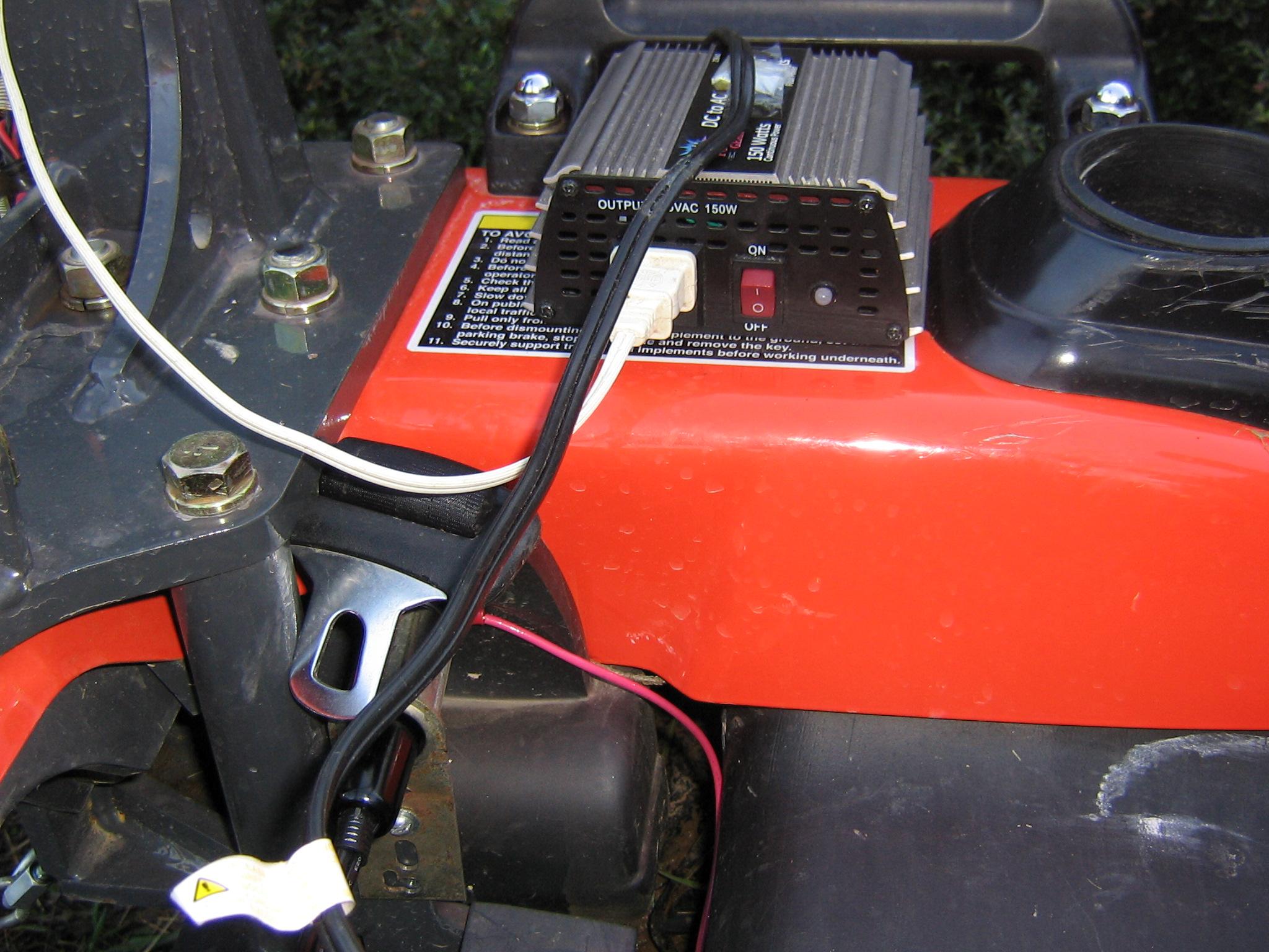

I had previously rigged up a power outlet and I plug in a small 300watt inverter that powers 2 strands of orange lights strung down the center. I also have a ROPS mounted sound system that plays spooky sounds during the ride. I think I enjoy it more than teh kids :D
A few things.
I have a 3ph mounted tow bracket that I've also mounted the 2" ball to. Instead of relying on the 3ph & hydraulics to hold the tongue steady (which it won't) I instead secure the vertical lift links to the static mounting eyes on the upper rear frameing. This give a good stout mounting for the 3ph and trailer tongue.
I leave the FEL on for front ballast and also to provide for a quick and fast emergency stop. I don't put anything additional in the bucket and haven't felt it needed any additional ballast. I've never had to use it for stopping either :D
I operate in low range & 4wd. I have a couple hills & inclines and that combination gives me the best control & brakeing.
My BX23 handles the weight so well that I need to slowly decrease speed when I plan to stop as the BX23 will stop quick enough to jerk the riders.
I haven't driven it on any public roads but if I were to operate in a low speed limit type neighborhood such as a subdivision, I'd HIGHLY recommend to have a large flashing caution light mounted about eye high facing the rear amnd probably wouldn't be out to late w/it. Too many partiers get out when it's late.
Be very care and Enjoy, I know I do.
Dave
