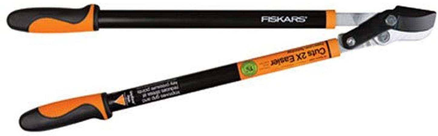

Thanks for all the great post, you folks always come through with the right answers because you have the experience! I am clearing for a view mostly. I already have the Fisker loppers with extended handles but that would be back breaking. The chainsaw clearing was bad enough. The hill is too steep to risk using my tractor. I intend to leave the area rough I don't need anything else yo mow...lol

I have the Fiskars, and they get a lot of work. @Torvy's post on the grass whip (ugh! scythes work sooo much better.) brought back lots of memories, including a brush axe that I cleared acres with as a kid.
