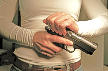

Racked the 9mm 1911 with no trouble; the .45ACP was a little harder. A gal at the sheriff's range showed me how to rack the slide on a .45 and she was right, her method is clearly easier. Before that, I did have trouble with any version.

Yep, hold the slide static with your left arm tucked into your body, and push the frame forward with your right hand. (all this assumes you are right handed)

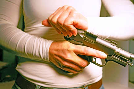

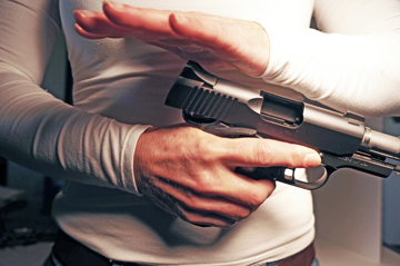

Its prime function is to allow people with weak grip strength to operate stiff slide springs.
Start by placing your left arm mostly horizontal pulled into your gut left to right. Grasp the slide with your left hand, fingers and palm not just fingers and thumb. In fact the thumb is not used at all. Now make sure your right hand index finger is out of the trigger guard, and using your right hand in a natural grip on the grip of the pistol shove the frame forward in a single rapid movement. Then let go of the slide with your left hand and allow the slide to move forward under its own power. Never follow a slide with your hand, always just let go and allow it to move forward.
This will give you much great leverage than attempting to withdraw the slide with your weak hand while holding the frame static with your strong hand.
Of course in all case's be mindful of where the muzzle is pointing as you are charging the pistol with a live round.
