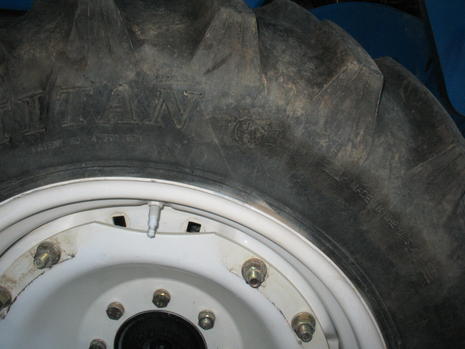

I did mine by myself. Left the center part of the wheel on the tractor. I removed one, rolled it up to a wall and left it leaning against it, put a jack stand under the tractor, and moved the jack to the other side. Two of the center bolts are actually studs which means you need to get the wheel perfectly aligned. So I decided to left the center on the tractor. Worked real well. All I had to do is get one of the bolts loosely into a hole, the tire doesn't even need to be that straight. Once you do you can just carefully raise and lower the tractor with the jack to get the others to line up and the tire will not fall over.
If you left the center on the tractor and swapped the tires from side to side, what did you accomplish? You have to turn the centers to gain the max amount of distance and by just moving the outside rim you didnt do anything. Also the two studs are there for alignment and you dont have to align perfectly, just get on bolt in the hole then you can wiggle it around on that bolt to get the other bolt aligned and then slide it on. Everything is then perfect for the studs.
If I were going to remove the center hub from the rim, I would just take off the hub then and turn it around, rebolt and then replace the tire on the same hub. That is way more work than just taking off the lug nuts and and swapping sides with the tire.
If your rims are like mine in the photo you can gain a couple inches on each side by moving the hub mount from outside to inside but the major move is in swapping the center hub to gain the cup distance.
This is a photo of the front on my tractor (rears are same type) and you can see how I narrowed the front tires by putting the hub to the outside rather than inside. IT was previously mounted to the holes at the valve stem. They are offset by 2 inches. My tractor came with the fronts wider than the rears and I never noticed till I tried putting it on my 83" wide between the fenders trailer. The fronts wouldnt fit but the rears fit tightly. With the camber on the front, it was not apparent that the fronts were 2 inches wider on each side till I tried to fit them between the fenders on my trailer. Now the fronts match the rear and the rims are mounted the same on front and back. I could put them back as they were on the front and then also change the rears to match and increase the stance by 4 more inches if I wanted but it wouldnt fit on my trailer then.

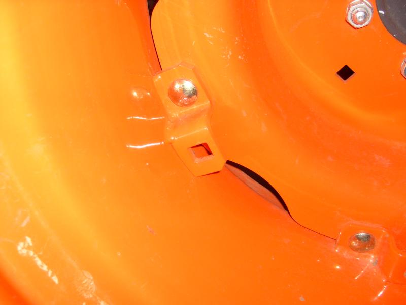

To kevin37b - thanks for that detailed description of the wheel changing process. As I read that, I could envision myself doing it. I have a floor jack under the middle of the axle for extra support, and a bottle jack at each side to allow for "fine tuning" of the height.
It's obvious that wheel assemblies vary widely with different makes and models of tractors, and on this particular one the disk must stay in the same position and the only adjustment is to turn the wheel around, the mounts in the rim being off-center. I'm still mulling over whether to remove the disks versus just unbolting the rim from the disk. Is it really a lot harder to re-align the rim to the disk than matching the disk and rim assembly to the axle? I have broken loose the rim bolts in preparation, but I guess I'll loosen lug nuts and bolts, too.
