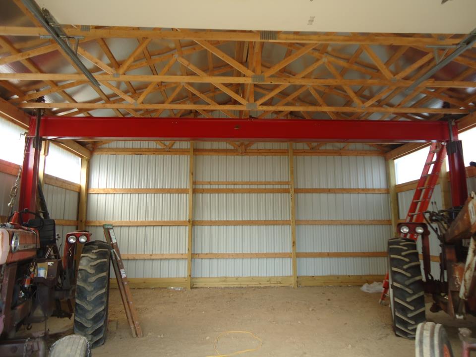

That's exactly one of the reason's I put this up in the new shop. Have my self spoiled with the one I put in my other shop, and not going backwards now. :)
I pulled the rears on my Massey 180, loaded 15.5 -38's, along with the spin-out rims, and center cast hubs all in one piece, one at a time, with a chain hoist on a trolley. Then rolled it away from the tractor, out of harm's way. Then brought another hoist on trolley in place to remove the axle housing. Oh soooo sweet.....!!
