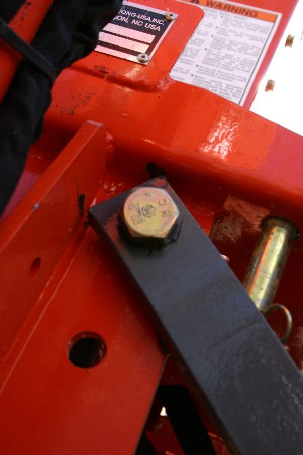

So the sun is shining, I’ve replaced the leaking hydraulic pump an line and it’s time to get some work done on the tree stump removal project.
After a few hours of good work and quite a bit of progress, I notice the BH seems to be getting pretty jumpy. Then the SO signals that something doesn’t appear to be quite right. I shut everything down and ask her what the problem is. She points to the left side of the BH sub frame diagonal brace and says “That bolt is spinning like crazy.”

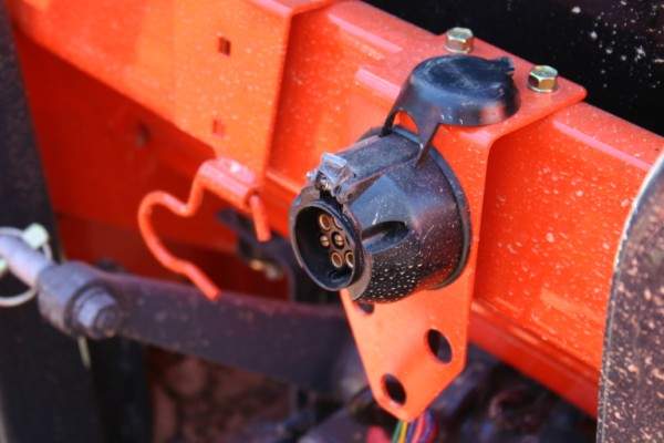

She must be exaggerating. No such luck. The nut has come loose on the bolt and the whole thing is spinning freely. That explains the rough ride. Time to pull onto the drive and take inventory of fasteners.

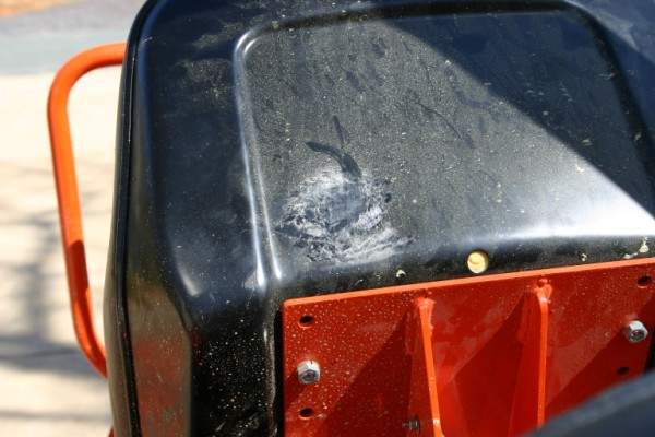

I think I got a Friday tractor. Examination of the BH sub frame shows that only three (3) of the large bolts holding the BH to the frame have lockwashers. Everything else is loose. I means REALLY loose, and one bolt is just plain gone.

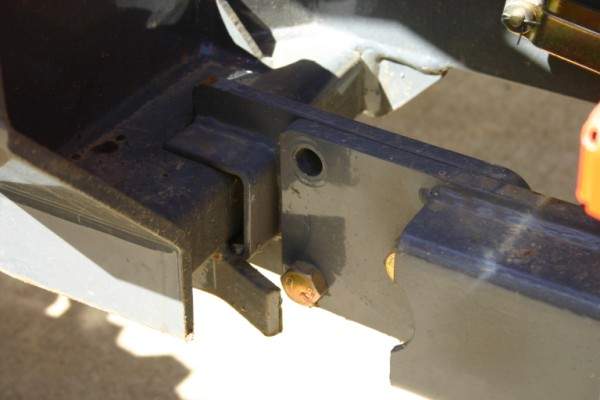

Home with the new hardware. Interesting thing, the Kioti is all metric, and TSC only sells SAE hardware. Gotta buy nuts to go on the bolts. I bought some Loctite blue to hold everything together and decide that enough is enough for one day. I’ll make the repairs Monday evening after working the real job.

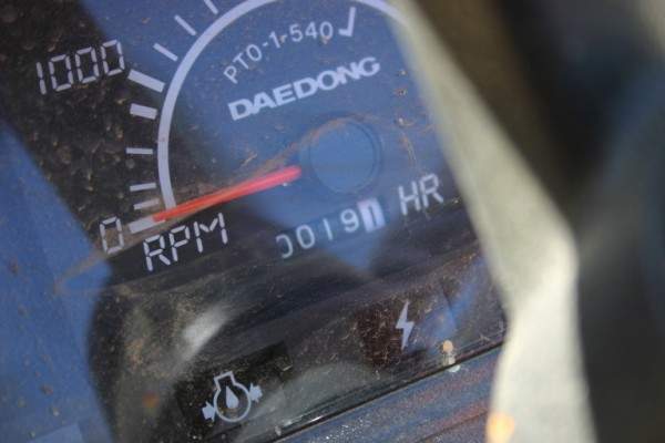

Monday night and I’ve replaced the missing/messed up hardware, Loctited everything without a lockwasher, torqued things the best I can and now I’m off to continue BH work.
After about an hour the BH is starting to feel wobbly again. Look down under my left foot and sure enough, the bolt is loose again. Everything I just replaced is loose, again. And I noticed that the sub frame has been flexing so badly the seat has been smashing into the electrical connector on back of the tractor.
