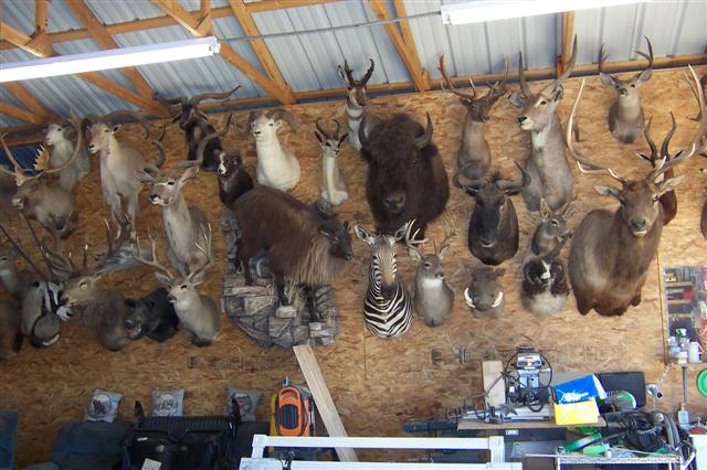

That wasn't my wall unless your talking about my thread about my workshop project. Here's a picture of what it looks like in my shop.
I have 12 foot walls and I put the OSB in on it's side.
As you can see, there's nothing on the ceiling except 4 eight foot flourecent lights. I have lots of light!!
Eddie

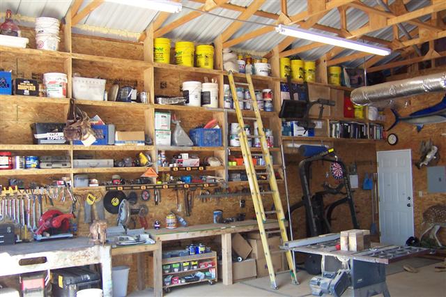

Here's the other side.
I used it to support my shelves and hang stuff from.
Eddie
