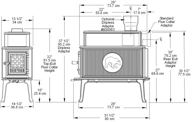

Our Jøtul F 118 CB Black Bear has been a great stove:
Takes long logs up to 24" stacked straight.
I only wish it had the bi-metal spring inlet damper that our 1970's VC Vigilant had - set it & forget it.
I'm working on a couple of concepts of how to adapt one as a "carburetor" on the Jotul's door.

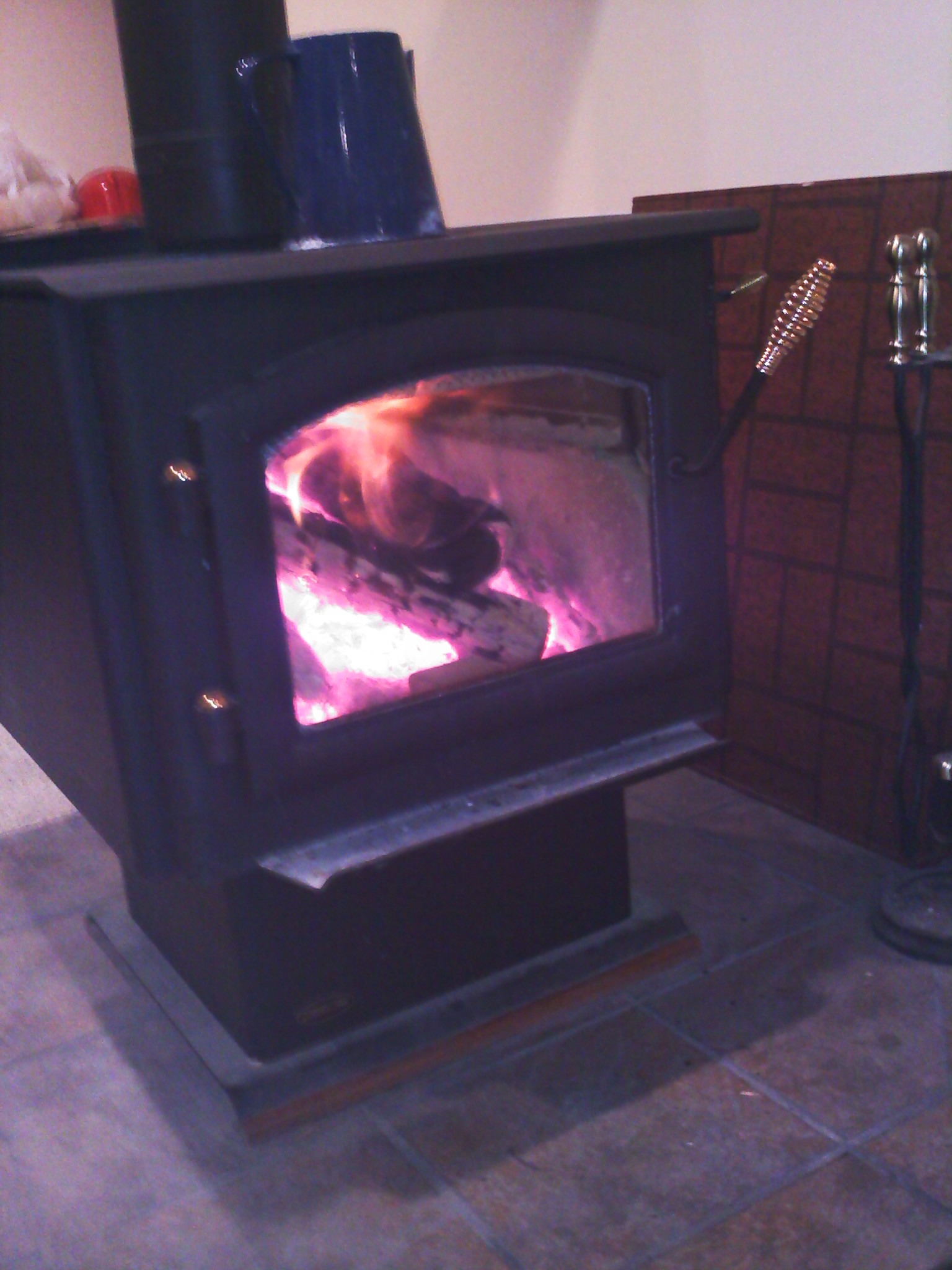

I leave flue/exhaust duct open, and adjust fire with air inlet only. This minimizes creosote buildup in the flue.
As Mossroad said, be sure the firebox is big enough for what you like to cut. I cut 18" long, and have some gnarly pieces that go a bit longer. My firebox will take up to 20" long for this reason. Anything really gnarly I'll throw in the wood furnace. And if uber-gnarly, it stays in the woods! :laughing:
My stove is a Quadrafire, has a number of air inlets & control dampers. It runs app. 80% efficient, about as low smoke & high efficiency as you can get without adding the expense of a catalytic combuster in the flue.
Enjoy!
P.S. of course, always burn only dry wood to minimize creosote & risk of chimney fire.
