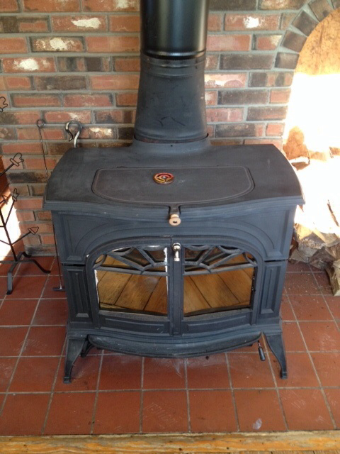

We just installed a new Vermont Castings Defiant and it is really working fine for us. It replaced an older Vermont Castings stove and we wanted to use the same type of stove as we like the size of the fire box, that it is top loading, has a separate ash pan for removing the ashes and the output of the stove. We have used it for about a month now with zero problems, a warm house and the length of the fire burn is excellent.
We have heated with wood since 1980 and only use oil if we are going to be away for multiple days and there is no one around to maintain the wood fire. One nice thing about heating with wood it warm us many times, when I am cutting down trees, hauling the logs to the staging area, cutting to size, splitting, stacking, hauling into the house and the when hauling ashes out. Mostly great exercise!
