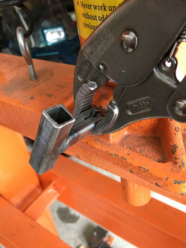

A handle for the valve made of 1/2" sq steel tubing.
461667d1458542823-harbor-freight-20-ton-hydraulic-img_3951-jpg
Spread it with a screwdriver.
461668d1458542823-harbor-freight-20-ton-hydraulic-img_3951-jpg
Squeeze with vise grip.
461669d1458542823-harbor-freight-20-ton-hydraulic-img_3951-jpg

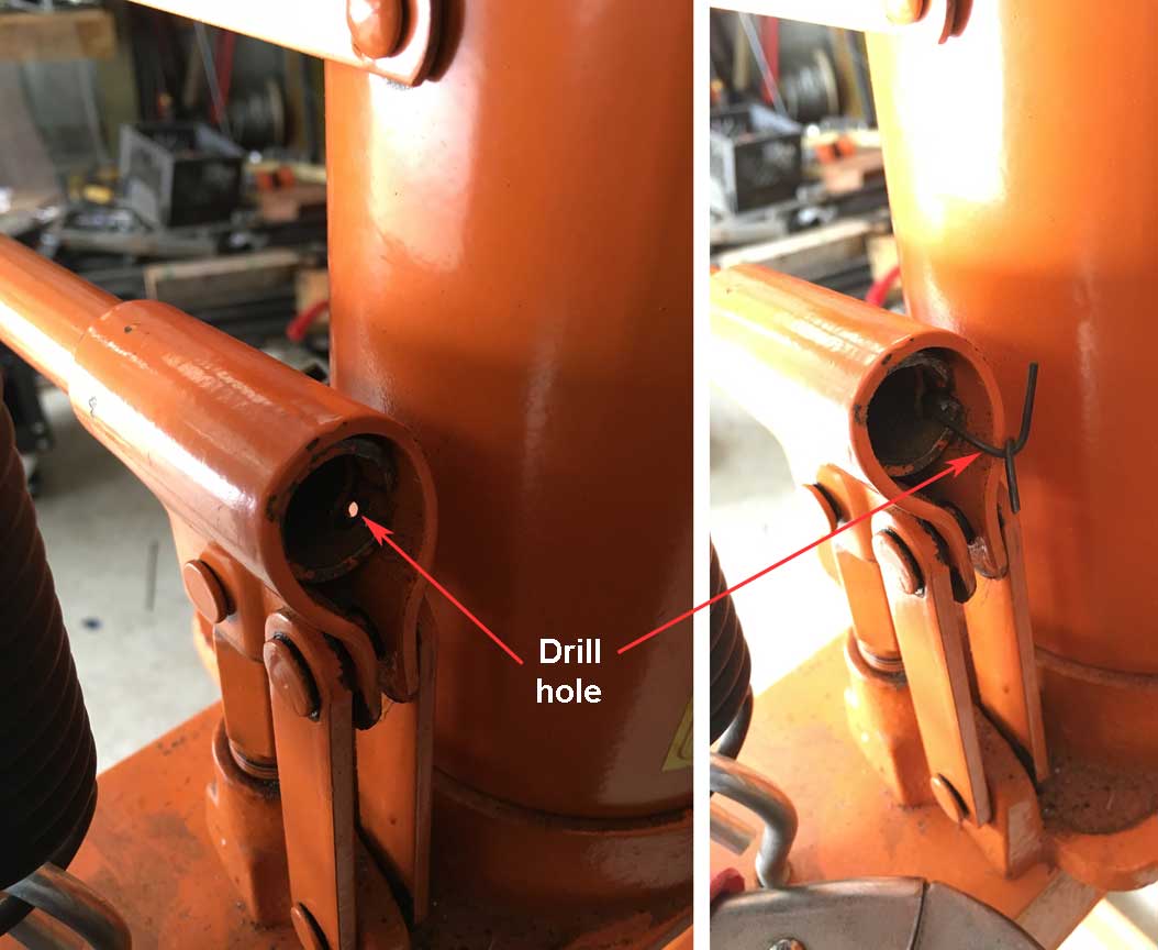

I make the pump lever semi-permanent by drilling a little hole, for wire.
461670d1458542823-harbor-freight-20-ton-hydraulic-img_3951-jpg

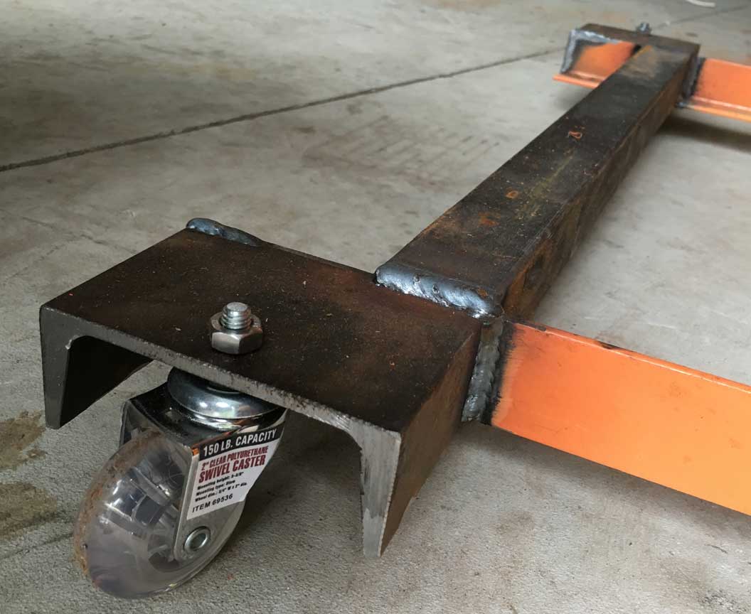

Wheels so I can set it against the wall but move it too. Required a crossbar.
461671d1458542823-harbor-freight-20-ton-hydraulic-img_3951-jpg
4" channel. The crossbar is 1 1/2" sq tube with .065 wall.
461672d1458542823-harbor-freight-20-ton-hydraulic-img_3951-jpg
