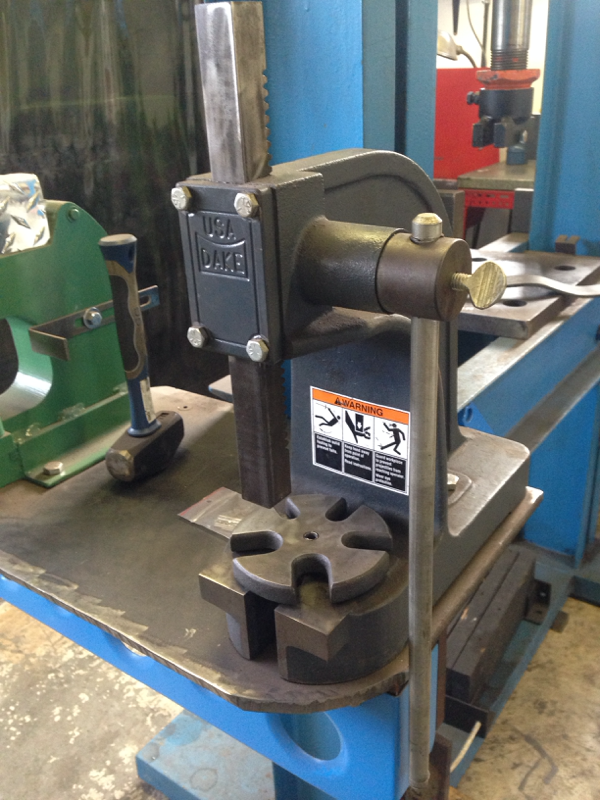

I wish I had thought of that design. I drilled a hole to match the roll pin on the bottle jack valve, and of course the holes didn't line up.
Hole for the OEM roll pin wasn't drilled perpendicular to the axis and of course I didn't notice. Had to 'fine tune it'. A hammer was involved..

If you look at the pic of mine (first page) there's a plastic knob - these come with threaded inserts
Knob & Bolts
and I drilled mine out - had a less-pronounced version of Terry's experience, figured out a way to fix it.
Measure the valve shaft, drill out the knob, remove the pin, find a drill bit that'll JUST fit the hole (helps if you have a 1-60 drill index) - measure how far onto the valve shaft the knob can go, then drill ONE SIDE of the knob just into the center hole, slide the knob onto the valve shaft, line up the (half) hole with the hole in valve shaft, finish the drilling of the knob - the bit will track thru the pin hole and put the far side right where it needs to be.
Roll pin the proper length/diameter, then.....
Do NOT hammer the pin in, UNLESS you can support the valve shaft - if you size the roll pin correctly, you can set a pair of channel lock pliers so they're parallel jaws, then use them as a kind of "mini-press" to insert the pin.
That way there's NO CHANCE you will shorten the life of any internal seals... Steve

Sorry Steve, while you were busy posting , I went out and fixed it.
