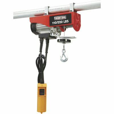

If you're talking about having to lift/struggle attaching heavy things I use one of these 120v winches a lot. It depends on where you need it the most, mine is mounted to rafters in front of one bay. Anything under easy to lift, raise and lower helps attachment.
It's really handy to lift a mower, sharpen blades. Of course I always use a safety chain or strap. 58921_400x400.jpg
