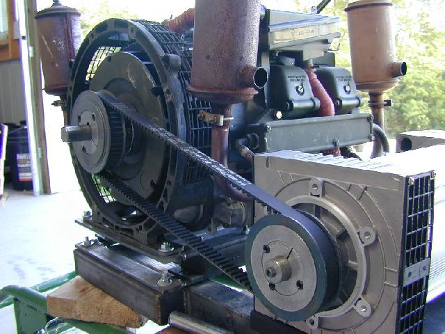

I picked up a HF head today. I was talking to the manager and he sold me it for $250 and threw in their 2 year replacement warranty. I thought that seems like a pretty fair of a price. Regular price is $299. Now I have to start designing the layout. Direct couple or belt drive. If I belt drive I can slow down the engine some with ratio's.

   / Harbor Freight Generator head 10kw #26
Jim,
For your use there is nothing wrong with a 2-pole alternator. The 2-pole (3600 rpm) unit is there for a reason, and for the most part meets its intended purpose.
Most 2-pole heads are geared for the mating to a gasoline engine, which usually produce their max Hp at 3600 rpm. Can they work on a diesel, of course they can. Would we try and run a diesel at a consistent 3600 - of course not.

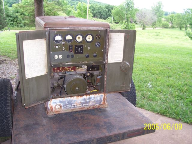

Jim, when you are planning your set up, the direct coupling will be more efficient, and less headaches in the long run, but I seem to recall those surplus army engines are redlined at less than 3600 rpms. If so, you may be forced to use a belt and pulley set up.

It would be better to gear drive it off a gear box using a "LOVEJOY" connection to the gear head rather than a belt drive as I'm not sure how good the head bearings are and IF they could take the load of the belts. (the other option is to belt drive to a small stub shaft which has dual pillow block bearings and a lovejoy/spline connection to the gen head.)
anyhow one last thing, pictures pictures and more pictures /forums/images/graemlins/smile.gif
