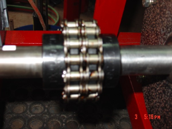

here is a pic of the chain coupling that i am going to try. i tried a hytrel spider and it failed.

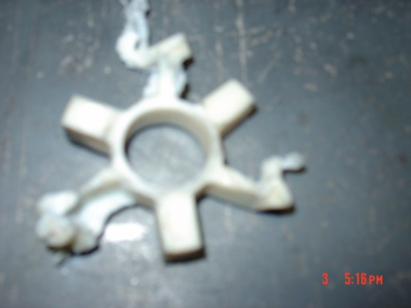

a pic of the hytel spider after it failed. maybe the vibration from the single cylinder engine was too much for it.

Do you have the cover for the chain coupler? As I'm researching how to connect mine I've read about the chain type. If your going to run it at a high RPM they say to get the cover which in turn you put greese in it.

the cover was optional and an extra $41.00. you don't really need it unless your in a dirty type environment. for as much as i will use this,(stand-by)i didn't want to spend the xtra cash. the counter person told me the cover has a grease fitting and some seals on it. it also could be added at a later date if need be, as it comes in 2 halfs for easy installation.
i am making my own guard to cover it and the rear flywheel for safety. i will hit the coupling with some good dry lube at regular PM intervals.

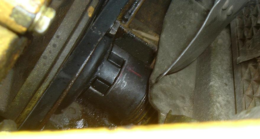

I noticed that I had a picture of my lovejoy PTO off the crank of the 45 HP diesel. It runs the single hydraulic pump.
