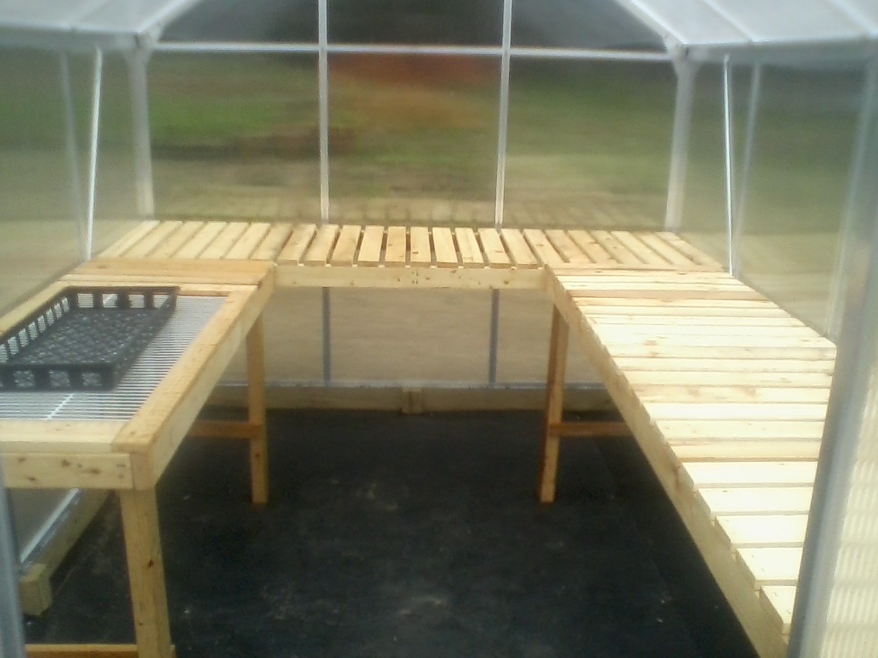

Did you guys see the work benches and potting table I made from scrap lumber...one leftover bundle of twisted HD furring and bunch of ripped down warped 2x6. :D

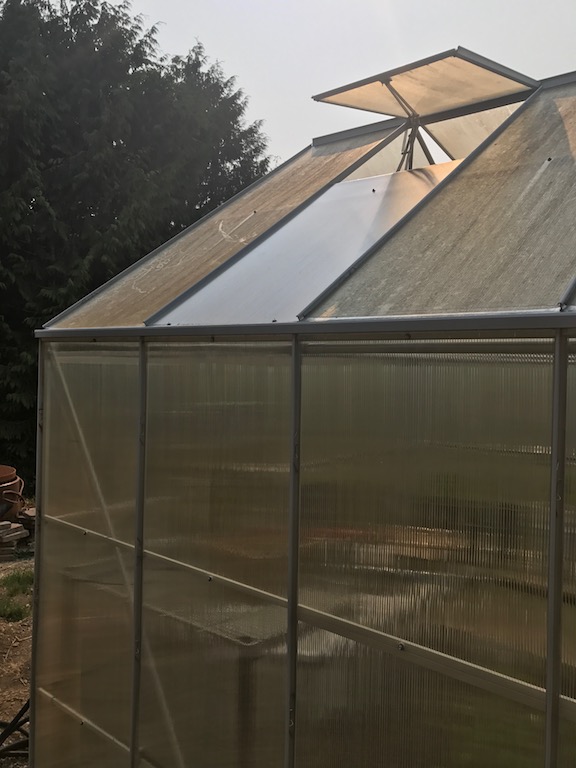

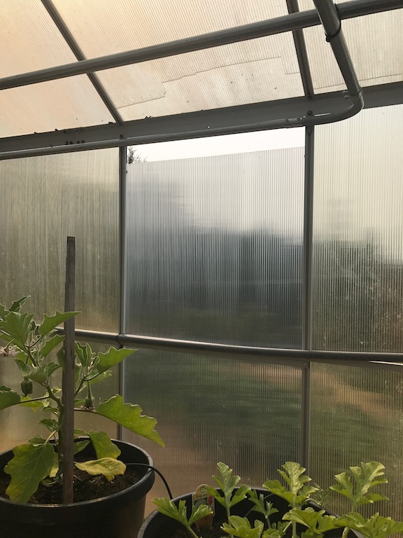

3 year update part II... I purchased 6mm thick panels from Greenhouse Megastore... seem to be a bit sturdier and better quality. UV light and time will tell. Installed new panels, 4 on the sides and two on the roof. Fit fine except the full 6ft panels are not long enough for sides. Roof panels were just below vents so I cut down a couple 4ft lengths. Here are the pics... note the water trapped in the old panels where I stupidly taped the bottoms. The existing panels are quite brittle now... don't know how many will blow up next winter storm. I sure was expecting to get more than 3 years from the panels. Don't see how the rest will last more than a year or two. Old panels are also quite dingy next to the clean and clear new ones.

I bet yours are brittle... be careful pushing on them... they will probably crack or shatter, rather than bend. I put screws w/cushioned washers in the centers of each panel to better secure them. I am sure I mentioned that detail in the build. Without the screws I had a couple blow out of their clips during the first strong winds it saw.
It was the wind and a pressure difference inside and outside that caused the panels to blow off (outward) during a storm. I probably ought to go ahead and buy some more panels to have at the ready.

Ya them panels trap water, pollen and bugs pretty easily. I had considered taping at one point but figured might be worse off, same with all the caulk some people use on them.
