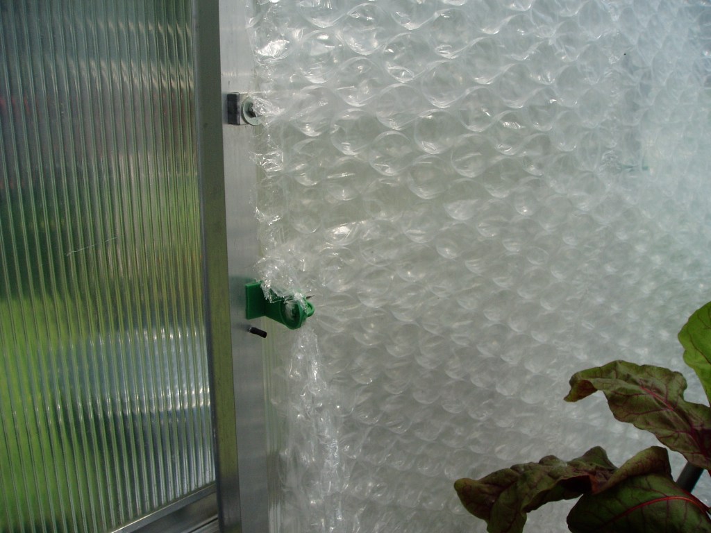

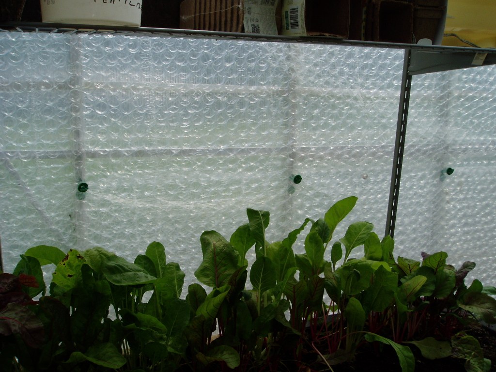

Here's a couple pictures of the clips.
The first picture shows 3 extended clips which fit in the slots in the aluminum frame. These are used to separate the bubble wrap when installing two layers.
If you look closely just below them you will see 3 standard clips that hold the bottom layer of bubble wrap to the aluminum tracks. They are below the top layer of wrap so you have to look to notice them.
The second picture shows one of the corner clips. These are used where you don't have a slot in the aluminum rail such as in corners and by the door. You can slip them in behind the aluminum angles to fasten the bubble wrap.
It does take a bit of creativity to figure out the best places to put the clips, and a few will come loose so you need to check periodically and put them back if they do.

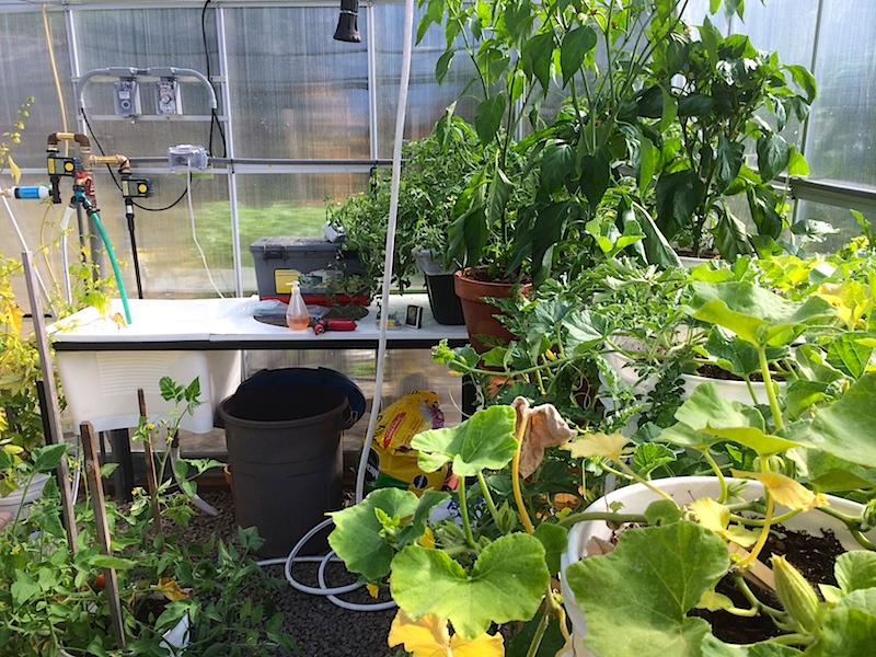

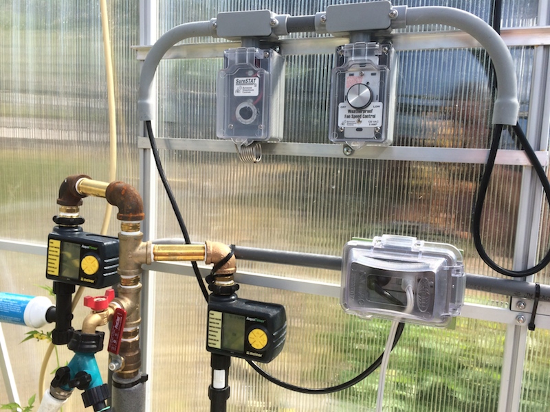

Okay just about finished with the brains of the project... at least for spring to fall gardening. I have the fan in and just installed a thermostat and variable fan speed control. The fan is working great! I also installed a mister system that cools and humidifies (this is on a simple timer as well as my drip watering system)... great place to hang out in the middle of the day for a bit! :D We are harvesting albeit with a Margarita in hand! Hit 34degC/94degF today. Wow! Not bad for the shores of the Hood Canal!
