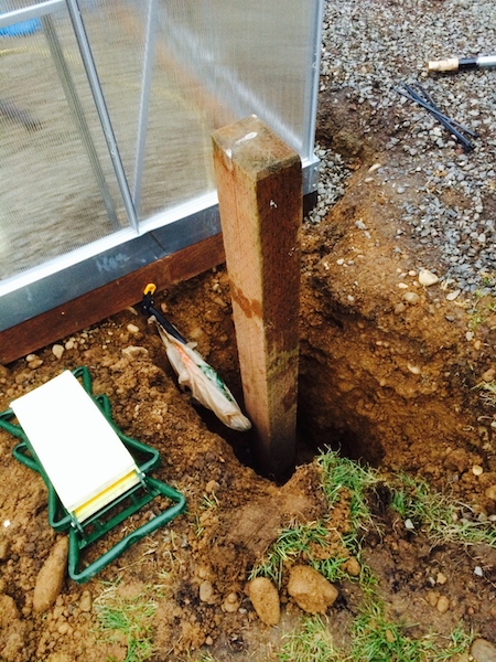

I drilled a few holes in the timber foundation and drove 4foot pieces of 1/2" rebar into the dirt. I've gone thru some very heavy wind gusts, the greenhouse came thru ok but you have to secure the vents as the wind will blow them up and sometimes they detach.

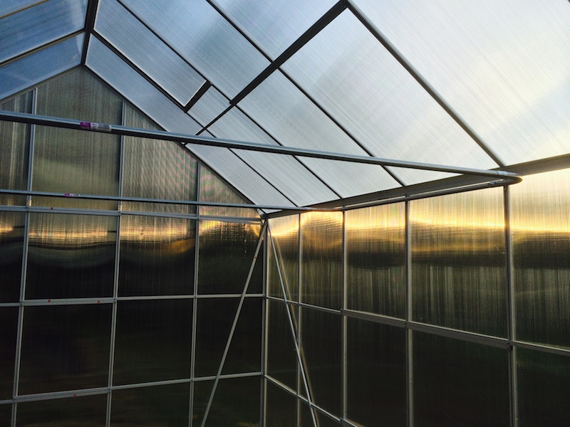

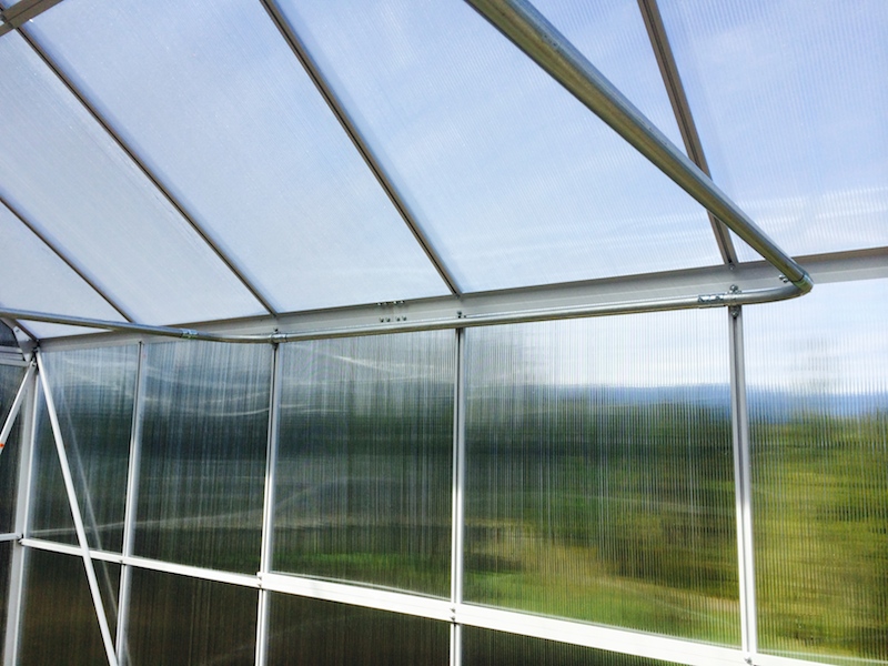

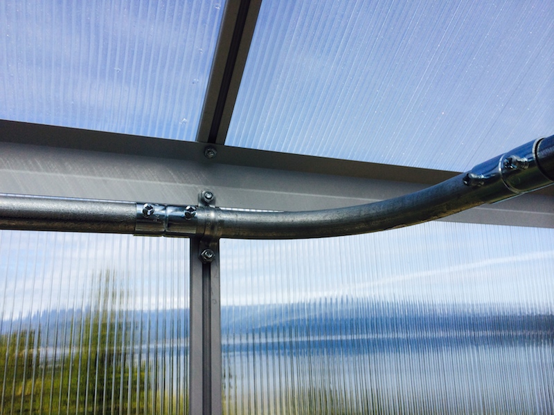

Now it is time to start reinforcing this structure. We have pretty good winds coming off the Hood Canal here and I need to do much to stiffen up the structure and tighten the glazing. Here are the first of the improvements...
There is no truss system so that a down force on the roof will cause the long sides to bow out. I used electrical conduit to stiffen the sides here.

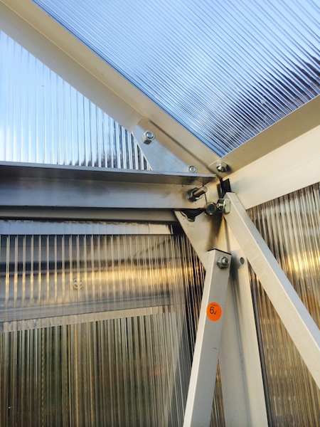

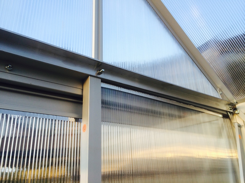

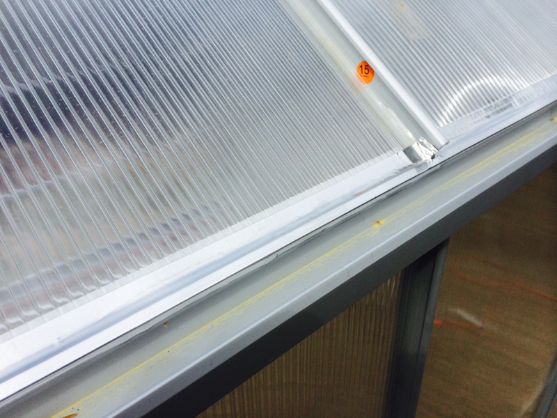

I also need to stiffen up the end walls. My solution to the front (door) wall was to add an aluminum angle stretching across the full span and tying into the existing T-bolts. But I needed to swap out the existing T-bolts with longer ones (happened to have just enough extra in the bag of hardware) to account for the increased stack-up. And yes I used a couple of Click Bond studs on the ends to secure the ends where no existing hardware was available. This stiffened the span nicely.
But looking at the rear side of the greenhouse, I think I will do something similar to what I constructed for the long sides.

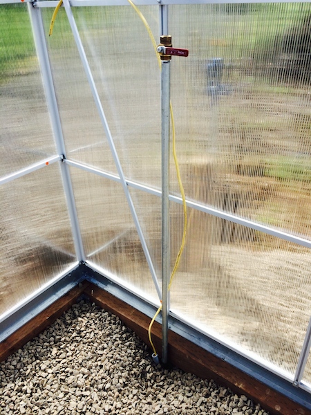

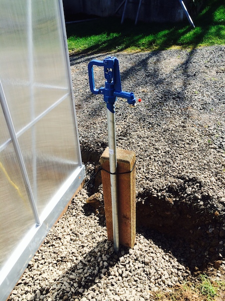

I also got water plumbed both inside and out. I used a frost free faucet at the end of the run.
Sorry for the cable tie straps... this is temporary until I fabricate some straps or make another trip to Home Depot for some pipe brackets.
