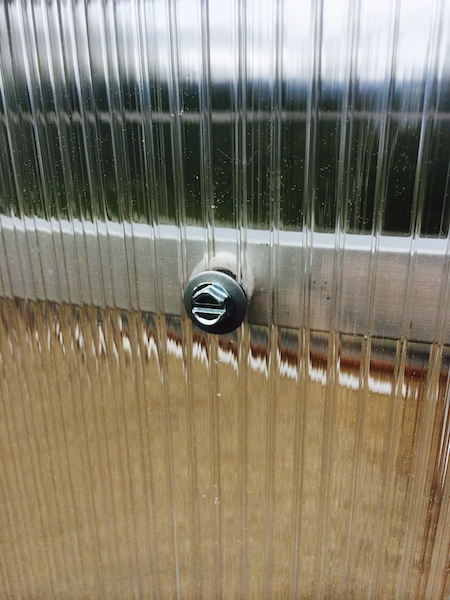

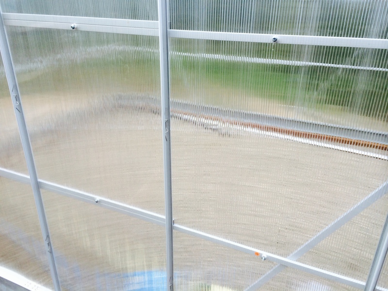

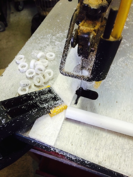

Some reinforcement here... added some #8-3/4in screws with a 'roofing' washer. I couldn't find nylon spacers in qty at a reasonable price so I made my own on the scroll saw. These help space off the panels from the frames at a 3/16in gap.

I predrilled a small pilot through the glazing and into the lateral stabilizing aluminum tubes and put on in the center of each span on the walls and roof.

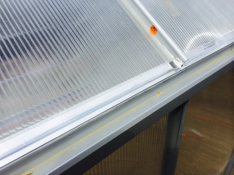

Now I am busy using some 3mil aluminum (HVAC) tape to seal some of the 'not so clean fit' details. In certain areas on the roof the panel edges (top edge under the roof vent) and of the bottom edges adjacent to the gutter are not leak free. Using the tape I can clean up the edge. Might be hard to see though in the pic below.
