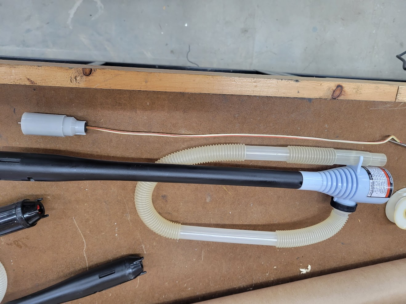

More than a year ago, ( I want to say two but don't remember exactly), i bought one at HF. It stopped working after the first run. HF would not accept the returns, they said to call HQ. I called them and they returned my money without need to ship it back.
So, now i had a free toy to play with:
1. I opened it up, the red tube unscrews from the motor and i could access the contacts.
2. I figured that when i connect 3V power directly to the motor it works just fine.
3. Soldered 2 wires( one red and one black) red to the motor ->switch
4. Drilled a little hole in the red tube and put two wires - The black from the motor and the red from the switch out after screwing the tube back to the body of the pump
5. Glued a 2AA battery holder to the outside of the red tube
6 Connected the wires to the holder.
7 Installed 2 rechargeable AA batteries
8 Enjoy free gas pump for over a year.
If i could do it, you definitely can
I took 4 of my dead ones apart and put 3.5vdc (as low as my variable power supply would go) right to the circuit board, and 3 of the 4 spun right up.
I checked all the switches and they all function ~0 ohm-OL. The contact ring at the top and the switch mating surface is marginal at best, as is the negative strap that is supposed to touch the circuit board.

This is what the inside looks like if you're interested, impeller directly on the motor shaft at the bottom, then a wire straight up to the battery board. There are no components on the board, it only routes voltage from the battery directly to the motor.
I just ordered some AA battery holders, how long does a pair last you on a charge?
I put a freshly charged pair sometime at the end of May. I use it at least one time a week transfer 15 gallons of gas to my tritoon. So far still runs strong.
Btw, in my case the vdc did not work.
