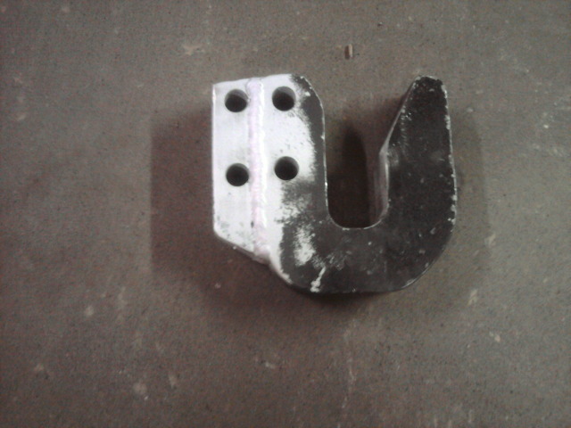

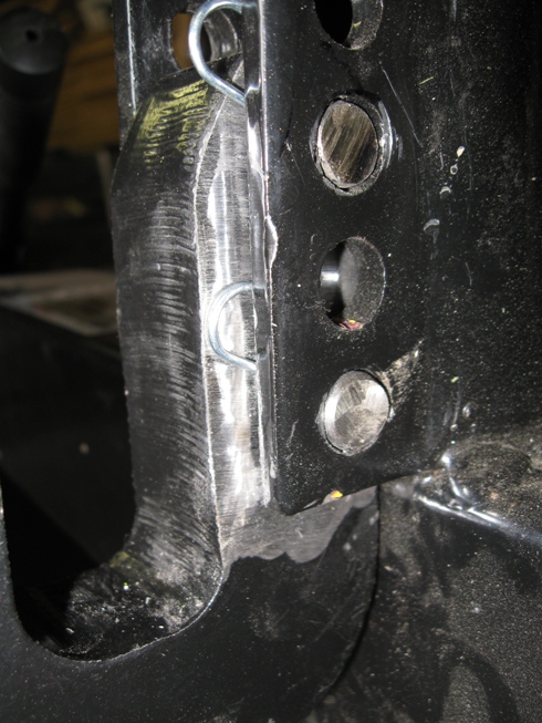

I recently purchased a Harbor Freight Quick Hitch for my Kubota. I tried to hook up my Landpride backblade and it will not work. The centerlink hook will not fit far enough into the opening in my backblade to hook the crossbolt. I also find that it will not work with my Landpride rotary cutter either. Any suggestions?
/ Harbor Freight Quick Hitch Issues #2
Is it because the two hex-head bolts that secure the top hook in it's bracket are hitting the sides of the blade bracket before the hook can fully engage? If so, there's a quick fix for that. It involves cutting the heads off each bolt with a sawzall or hacksaw, trimming the bolt to length so that it does not protrude beyond the sides of the hook bracket, then drilling a 3/32" or 1/8" hole through the bolt shaft to receive a small hitch pin clip between the tooth and one inside wall of it's bracket. Not my idea, but I can't recall where I saw it, my bad. I did save a pic that I downloaded from the originator's post, which I'll upload here, apologies and thanks to the originator.
I did this a couple of weeks ago with a new HF QH that I just bought for my larger tractor. Works great with my 84" Woods box blade and rear blade. On mine, there was enough space between the hook and the inside bracket wall to receive the clips, but the originator of the idea needed to grind a small amount off the sided of the tooth to gain the necessary clearance (see his pic). He also just bought two hitch pins the diameter of the bolts, then cut them to length, rather than cut and drill the original bolts. I didn't want to make a trip to the store for that. The whole mod took me about thirty minutes. Hope this helps. BTW, there are other solutions, e.g. welding an extension to the original hook then boring new bolt holes. But they involve much more work.

Threepoint. Thank you! I appreciate the tip and that is exactly what I need to do.
/ Harbor Freight Quick Hitch Issues #4
Someone else here welded about a 1 inch square bar onto the front of the hook and drilled two new holes so the hook was about an inch farther back.
On mine, I cut some mild steel rod a little bit longer than the width of the hook mount, then riveted it in place. The clip idea is better since you can still adjust the hook height if needed.

Oh yea here is the second option
not my picture but this is what I did. I didn't like the other option because with some stress or strain the short ends of the pin could twist and come out. But I am a worry wort also!

I've had both of mine for about four years and use it with a bunch of different equipment and have not had any trouble, one I have a SSQA plates welded to for use on the loader. I do have to say I pretty much don't use the top link hook , I just use the adapter , you can order them from harbor freight but I just made mine. I have several pieces of equipment it would work with and several it won't but I find it just as quick and easy to use the adapter instead of switching between it or the hook.

Agree need to remove the hook. I'm the one who did the cut off pins with the internal spring pins. It makes it really quick to move or remove the hook. I use the hook in two positions and removed to use the link for different attachments.
Thanks, KennyG!
Sorry I couldn't recall the thread with your original hitch pin clip idea. The solution was brilliant.

I've had one on my Sc2400 for about 5 yrs now and when I brought my T2320 down to NC in December, the first thing I did was stop at HF and bought another one. I bought a couple adapters and I leave them on the attachments that I can't use the hook on.
