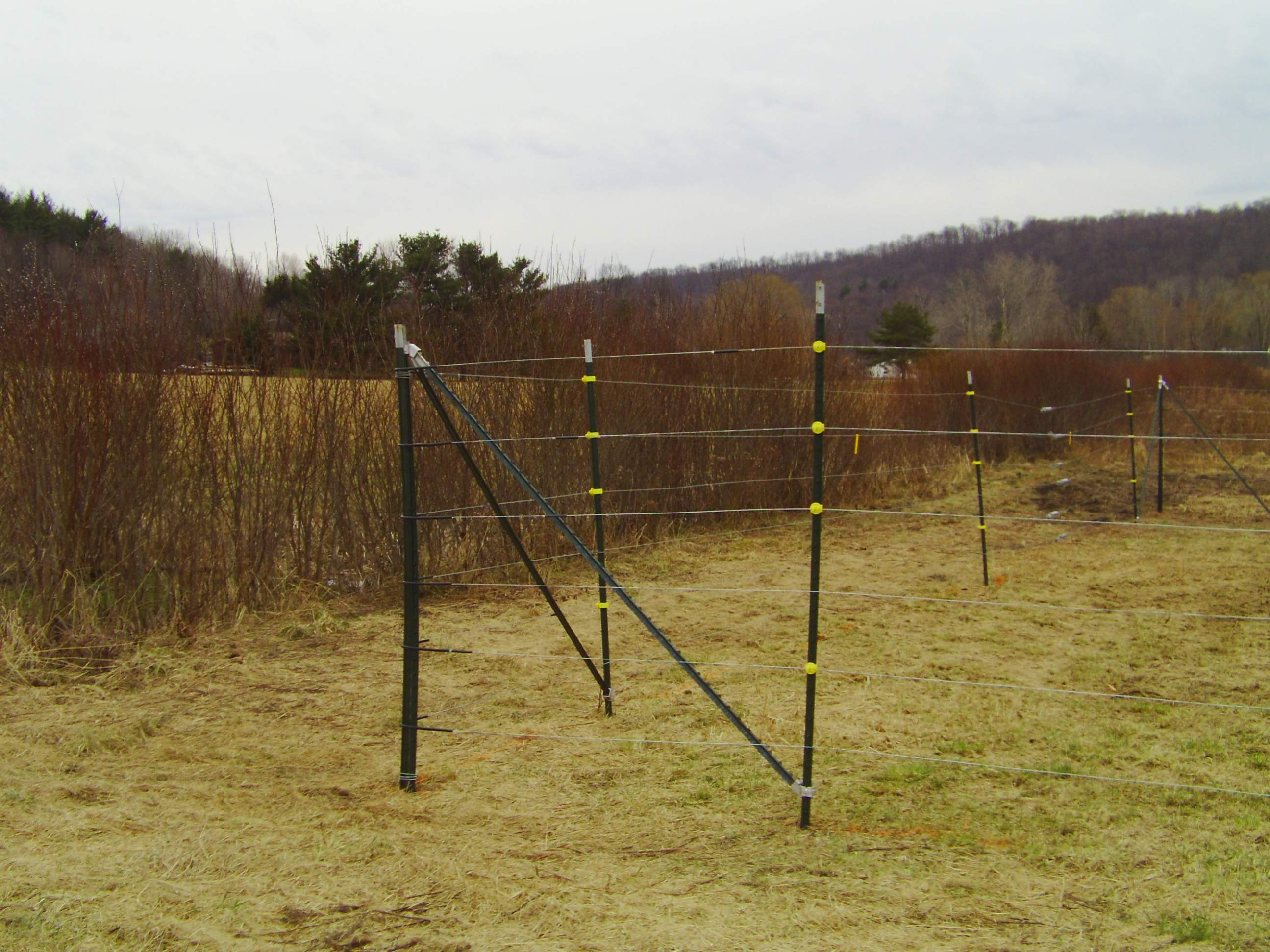

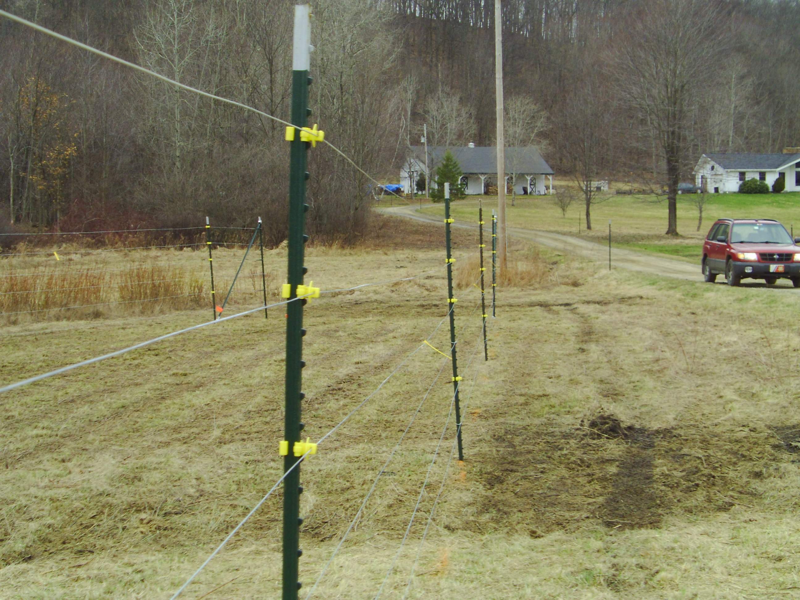

I finally folded and bought the Parmak DF-SP-L1 solar powered fencer. Parker McCrory Mfg Co
My new problem is that the corner posts are bending under the stain of the high-tensile wire. I doubled them up as recommended, but just too much of a good thing. I'll be replacing them with driving wood posts when my cash flow improves...
I'm attaching some photos. You can see how the corner posts have bent. I'm going to put on a tape gate when it starts raining, and then transplant my trees into the area.
It's amazing how much you can learn from your mistakes!
