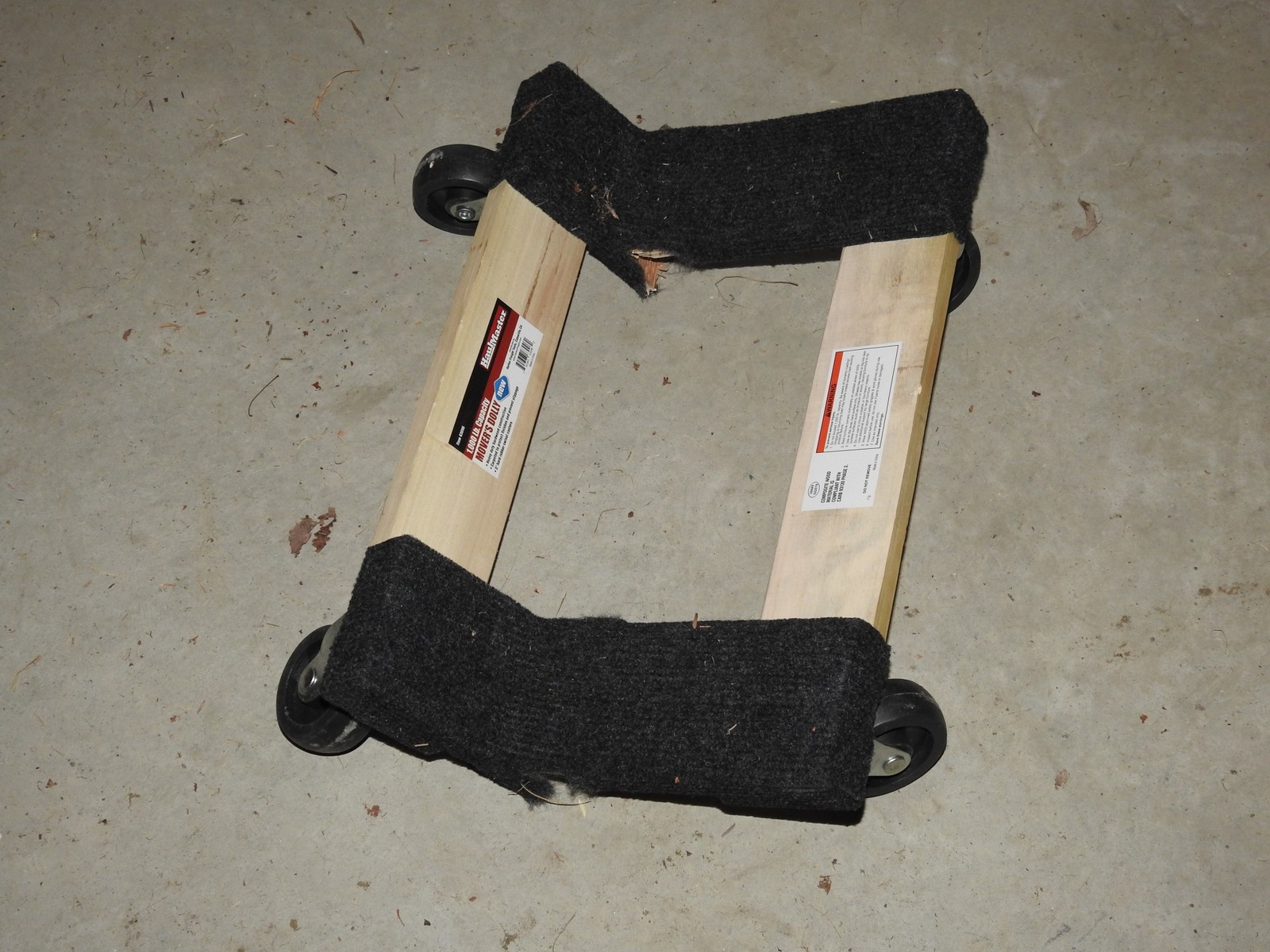

I bought a bunch of HF dollies on sale. The little 12x18's and some 18x30's. All supposedly rated for 1000 lbs. I had my doubts, but lots of people use them and they're cheap, so why not?
Lol, here's why not: DSCN2682.jpg

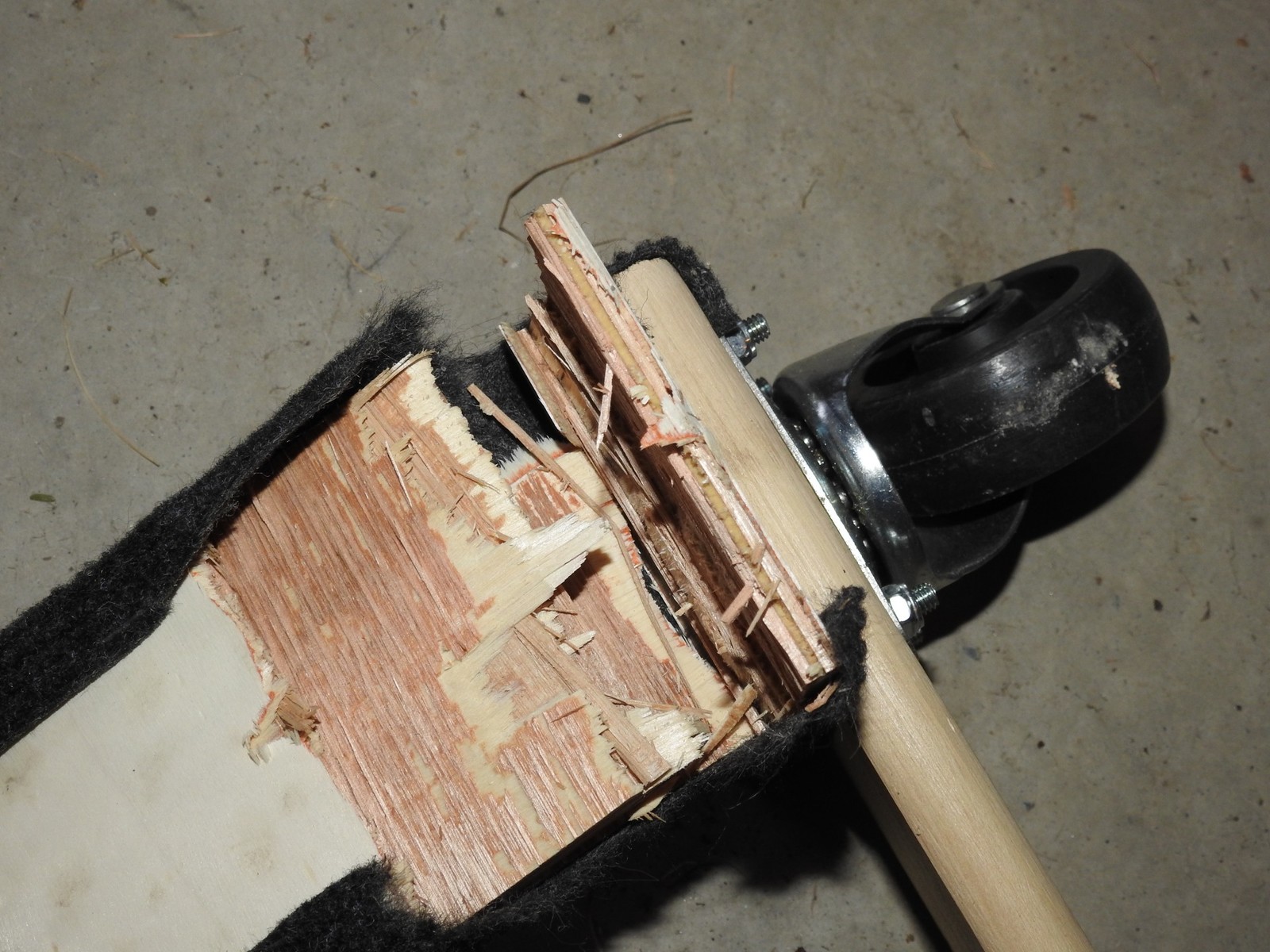

Turns out the "wood" hiding under those black covered ends is just thin plywood withs some veneer:
It broke under one corner of a 745 lb rotary cutter when I was setting it down. To be fair, the cutter did drop hard the last inch or so (but there were three supporting endpoints, one being the rear wheel).

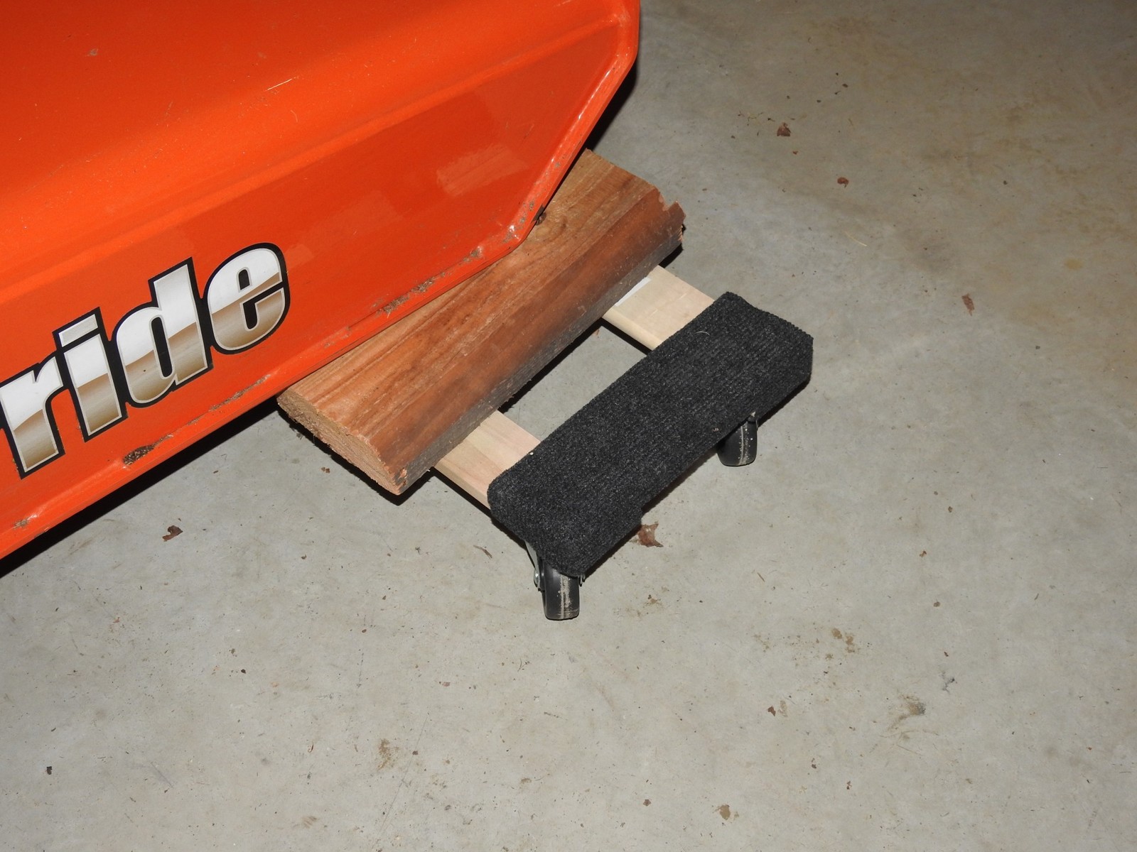

The way I ended up using it was like this: DSCN2681.jpg
with the wood piece in the opposite direction of the one that broke.
So... some dollies have survived their first day of use, others ... not. Live and learn, managing these tractor tools is all new to me. Meanwhile it's been 2.5 weeks and I'm still waiting for the 18x30 dollies, which are in stock per repeated phone calls but HF cannot seem to get their act together. Last time I buy from them mail order I think.

put them on proper pallets and move them with forks.
i think you were asking a but much from that. the dollies i have hold up fine with a large old drill press or a 5.3L cast iron Chevy on them, but not on a point load like that.
   / Harbor Freight tools that DO suck #236
The weight needs to be evenly distributed across the carpeted sections and on top of the casters. The crossbars between are just that, crossbars/stringers, not intended to be weight bearing.
Good point, only the carpeted parts are weight-bearing. Like anything from HF take the rated capacity then don't exceed 2/3 of it. :)
