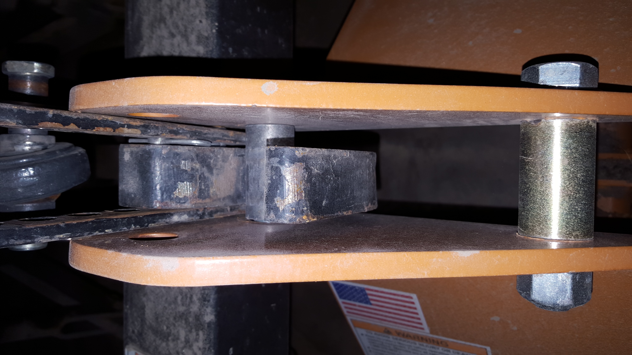

Yes. Simplest is replace the hook's bolts with slide-in pins that have K-clips to prevent falling out. This lets you adjust height of the hook as needed. (photo. This also shows the drawbar modified so it won't roll out of level).
Rear ballast for loader. Hitch 65 lbs, + 70x2. Easy to mount. I have another two of those rings but haven't needed them. The photo also shows a toolbox I mounted on the q-hitch.
And a spike harrow lifter I built. It pins on in place of the hook.
For some of us it is worthwhile to modify implements to fit those 'standard' (ha) implement dimensions. I used washers to widen the pins of a small disk to get to 'standard' width. For my rotary mower I throw a loop of chain around the mast on the front of the mower and the top of the qhitch, this gives an ability to flex over uneven ground while still being able to lift the mower. I built a rear forks assembly I can back into and lift, this is the implement that is on/off the tractor most often. And some implements can be modified with a piece of 3/4" pipe over the cross-bolt at the top of their front mast.
It's a beginning toward standardization. There will still be some implements that you need to just hitch directly. Hopefully only things that are used rarely.
