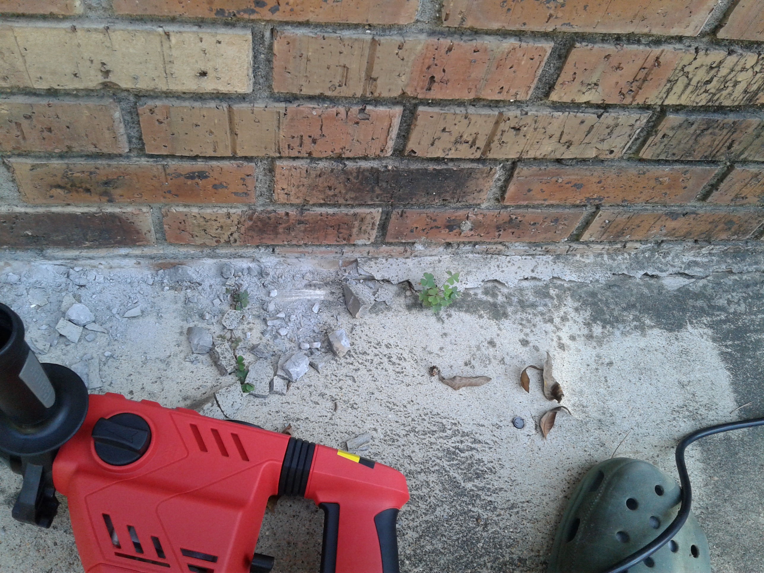

My son wanted a rh for his birthday and picked out a Bosch 1 1/8, I got him a Bosch 1 9/16 SDSMAX. He used it for various projects. Last summer I borrowed it to do some concrete crack repair. It was like driving my dually for picking up groceries, for me FAR overkill. Could hardly use it one handed. Later in the summer I had a project for more repair, and part of it involved breaking concrete off about a 100' run of brick/concrete joint.
590377d1549376483-harbor-freight-tools-dont-suck-20181002_105151-jpg
The steel chisel w/ sledge was just not doing it. The HF 1/2 in. Heavy Duty Variable Speed Reversible Hammer Drill wasn't up to the task. So I got the HF 1-1/8 in. SDS Variable Speed Pro Rotary Hammer Kit, ($75 w/coupon) - that worked great.
I could easily use it one handed (it was about 4 lbs lighter than the Bosch) on the stuff I was attacking or two handed, put some of my weight on it and bust some concrete pavers.
So you can always put lighter cheaper bits in an SDS MAX or spline with an adapter. You can't make the drill more powerful. I've about 80 linear feet of concrete driveway (10' sections) that needs major repairs. I can see a 15 amp breaker hammer in my future tool buys.
