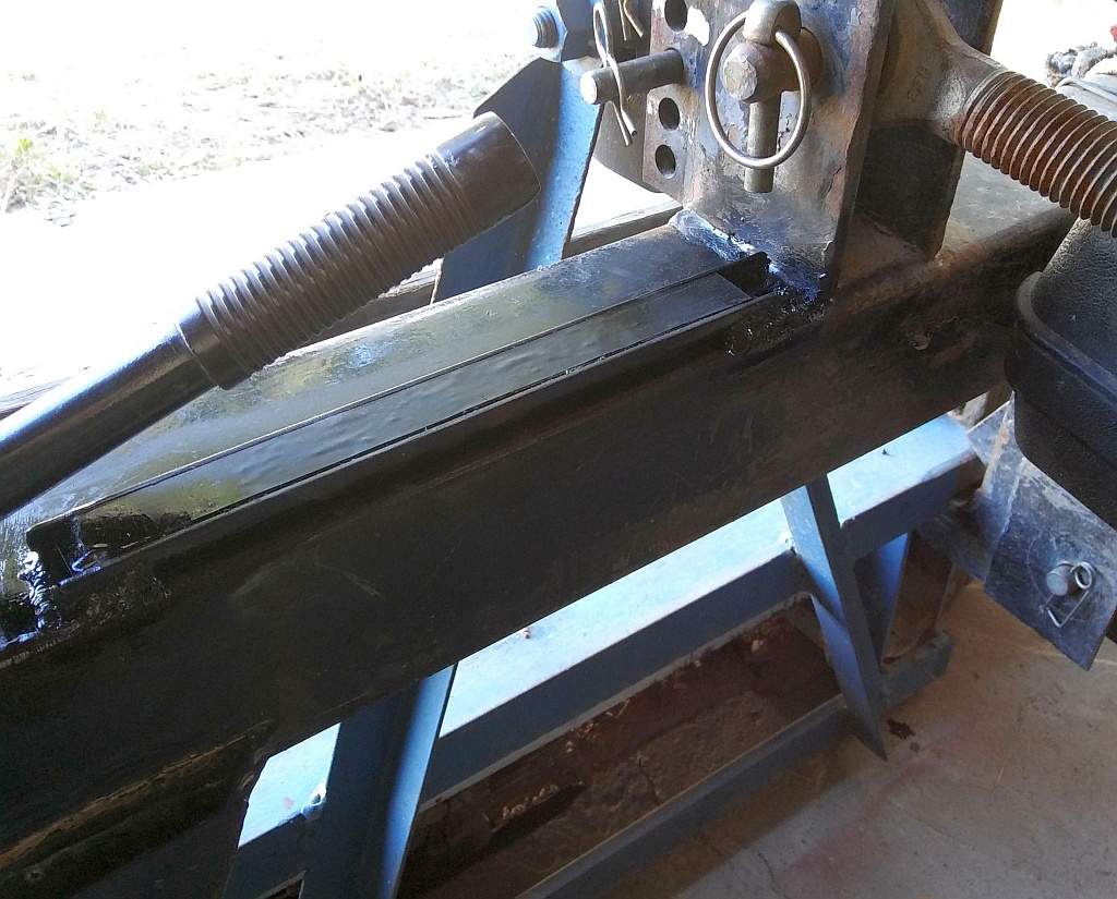

JB Weld it instead of Mig perhaps.
   / Harbor Freight Tools that don't suck #11,328
Bar magnet - HF's sometimes-free 'Magnetic Tool Holder' - cut down and mounted on the HF Qhitch. It's about 3/4 its original length and seems slightly less strong, but more than sufficient for holding clevises, pins, clips. Welding wasn't a problem. Those linked comments mentioned the arc being pulled aside by magnetism, but I didn't notice that.
Recommended!
Recommended!
That's a good idea and opens up to lots of similar ideas. Thanks.
