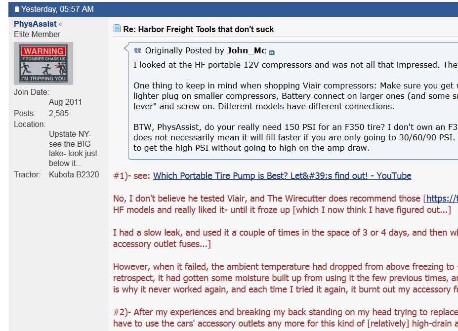

Hey PhysAssist, your most recent posts are showing up in huge font sizes and colors. Not sure how it works on this board, but maybe your font default settings got changed? :shocked:
Font is red, but normal sized on my iphone, red and huge on my laptop.

#1)- see: Which Portable Tire Pump is Best? Let's find out! - YouTube
No, I don't believe he tested Viair, and The Wirecutter does recommend those [https://thewirecutter.com/reviews/best-tire-inflators/], but I had one of the 100-PSI HF models and really liked it- until it froze up [which I now think I have figured out...]
I had a slow leak, and used it a couple of times in the space of 3 or 4 days, and then when I tried to use it another time, it was frozen up [and burnt out my accessory outlet fuses...]
However, when it failed, the ambient temperature had dropped from above freezing to -11F through the day while I was at work on a 12-hour shift, so I think in retrospect, it had gotten some moisture built up from using it the few previous times, and then froze solid when the temps plummeted, but what I don't understand is why it never worked again, and each time I tried it again, it burnt out my accessory fuses.
#2)- After my experiences and breaking my back standing on my head trying to replace the fuses, [and reading the Wirecutter's
recommendations, I didn't want to have to use the cars' accessory outlets any more for this kind of [relatively] high-drain accessories, so I bought an extension cord that has battery clamps on one end, and an accessory outlet [cigarette light port] on the other, so I can run the "directly" off the cars' batteries...
#3)- No, I don't need 150 PSI for my truck's tired, however, the above was one of the reasons, I was thinking of getting the 150 PSI version- it has battery clamps as the OEM connectors.
The other reason were basically that whenever cost isn't a huge factor, I always prefer to get the heavier duty option, all other things being equal...
Especially as I tend to use my tools to their limits, [and sometimes find out that I have overshot somewhat
:confused3:].
The Wirecutter review link did not work. It appears the closing bracket around the link was inadvertently included in the link you posted. Deleting that bracket got it working. Here's a working version of the link: The Best Tire Inflators for 2019: Reviews by Wirecutter
I agree with you about the desirability of electric leads which clamp on to the battery.
However, for my wife's vehicle, the convenience of plugging in to a cigarette lighter was the major consideration. Unfortunately, as it seem you discovered, some vehicles (particularly smaller ones) have the lighter plug on a 10 amp fuse. Many of these compressors draw 15 amps. My wife's is the one vehicle we have with a 10 Amp circuit. I almost bought the Wirecutter's recommended Viair 78P compressor for my wife's vehicle (by coincidence - I had not seen their review). However, it can draw up to 15 amps. The Viair 75P I ended up getting her draws less than 10 Amps, but still has a speedy fill time (they get this by setting the compressor up for higher volume, but limiting the max pressure to 50 PSI).
Tip on avoiding popping fuses when using a cigarette-lighter powered compressor:
I noticed that what often popped fuses for me in some vehicles when using a cigarette-lighter socket for power was starting or stopping the compressor under load. I found if I left the compressor disconnected, started it up, then connected it to the tire, and when done filling kept the compressor running, disconnected the hose from the tire, then shut off the compressor, I did not blow fuses. You can get a surge when starting or stopping an inductive load like an electric motor. If you reduce the load on it by not having it connected to a (even partially) pressurized tire, you reduce the surge, and may get by without blowing the fuse. This was the only way I could get our "Slime" brand compressor to work in our Toyota Minivan without popping fuses (interestingly, it was the "off" cycle which most often blew the fuse).
