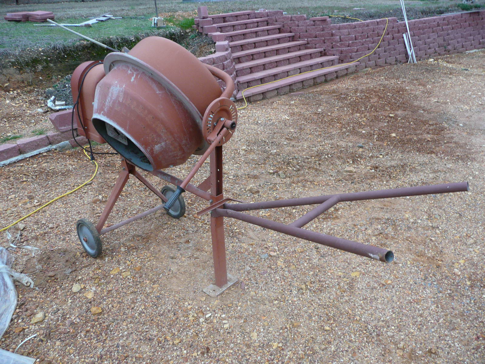

A big thumbs up on the 3.5cf mixer. I have had one for about 10-12 years. It it only used occasionally, but it shows no sign of slowing down. I have also used it to mix dirt with sand and dirt with compost, etc.
Mine is the older model 31979, the new one is 67536, the differences I can see is the older one was finished in what appears to be primer (semi gloss, rough surface) and the newer one is a glossy finish paint. Also, I think the paddles inside the drum are redesigned. Just now, in looking at the picture of the newer model on the HF website, I thought they had changed which side the wheels are on, then realized I was just a dumb-*** and put mine together wrong! By putting the motor over the peg-leg end, instead of over the wheels, I had made it hard to move around. The little handles provided on the old model were inaccessible up under the motor housing. It was easier to pick it up by the bottom of the motor housing to roll around. But only with gloves on, as the bottom of the motor housing is the edge of thin sheet metal. I solved the problem by making wheelbarrow style handles as you can see in the first pic.

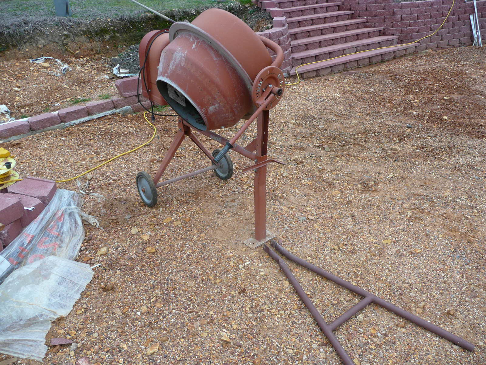

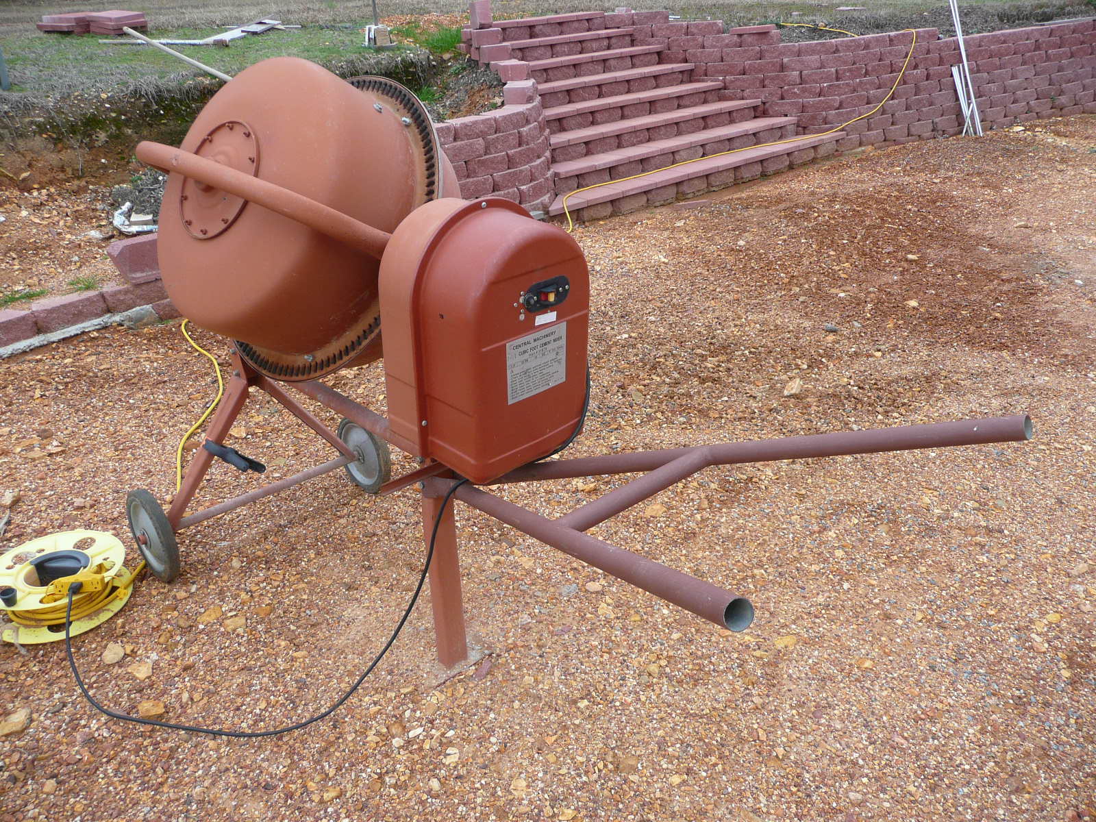

So, now that I realized that I had it wrong all these years, I decided to change it to the way it should be. Even though my handles had made it easy to move, it always seemed top heavy, because you are raising the motor when you move it. Also, having the motor over the peg leg can make it seem unstable when mixing. After swapping things around it was awkward to move after being accustomed to my long handles. Also one of the original handles is bent, and they don't have rubber grips on them. They are not pipes as on the newer model, just sheet metal bent in a shallow U channel. So I put my long handles back on. You can see the swap in the second pic, and the handles back on in the third.
I still feel like a dumb-*** for not realizing this before now. But I went back and looked at the assembly instructions, and, like most people say, they are pretty vague. I don't see anything that says which side the wheels should go on.
