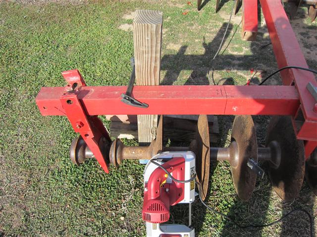

I used an HF $80 portable band saw with a Milwaukee blade (24T) recently to modify a 13-ft wheel disc down to 7-ft. Worked fine sawing 3"x3"x1/4" steel tubing and 1" dia steel axles. Took several minutes to cut the one of the tubes and about a minute for an axle. It's best to let the weight of the saw provide the down force during the cut.
The saw has a variable speed trigger with locking mechanism to set the blade speed. It's loud so wear your Mickey Mouse ear protection.

Flusher--that cut surprisingly well. After using it, are you glad you paid the $80 or would you buy a brand name saw?

It's all due to that Milwaukee blade--put it in a $500 portable band saw and I don't think that blade will cut any better than it does in my HF cheapie saw.

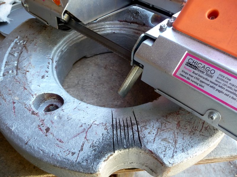

I bought one. It works fine for my infrequent use. Like Flusher's disc modification, my first project pretty much paid for it compared to going to town and paying someone else to make the same cuts.
Here's a picture of the first-pass cuts I made in some weights to modify them for my wheels. I went back and cut deeper but I don't have a picture for that.
The second picture is after grinding a concave cavity to make clearance for the valve stem.

I used a nearly new Milwaukee blade for these cuts and this dulled the blade down to where it was barely cutting at the end. The cast iron was tougher than I expected. This didn't hurt the saw, it wasn't working as hard after the blade dulled.
Here's a review of a smaller band saw project I posted over on Welding Web.
In summary - it's great for occasional projects. But for a full time tradesman who can't afford downtime, the real Milwaukee that this is a copy of would be a better choice in my opinion.
